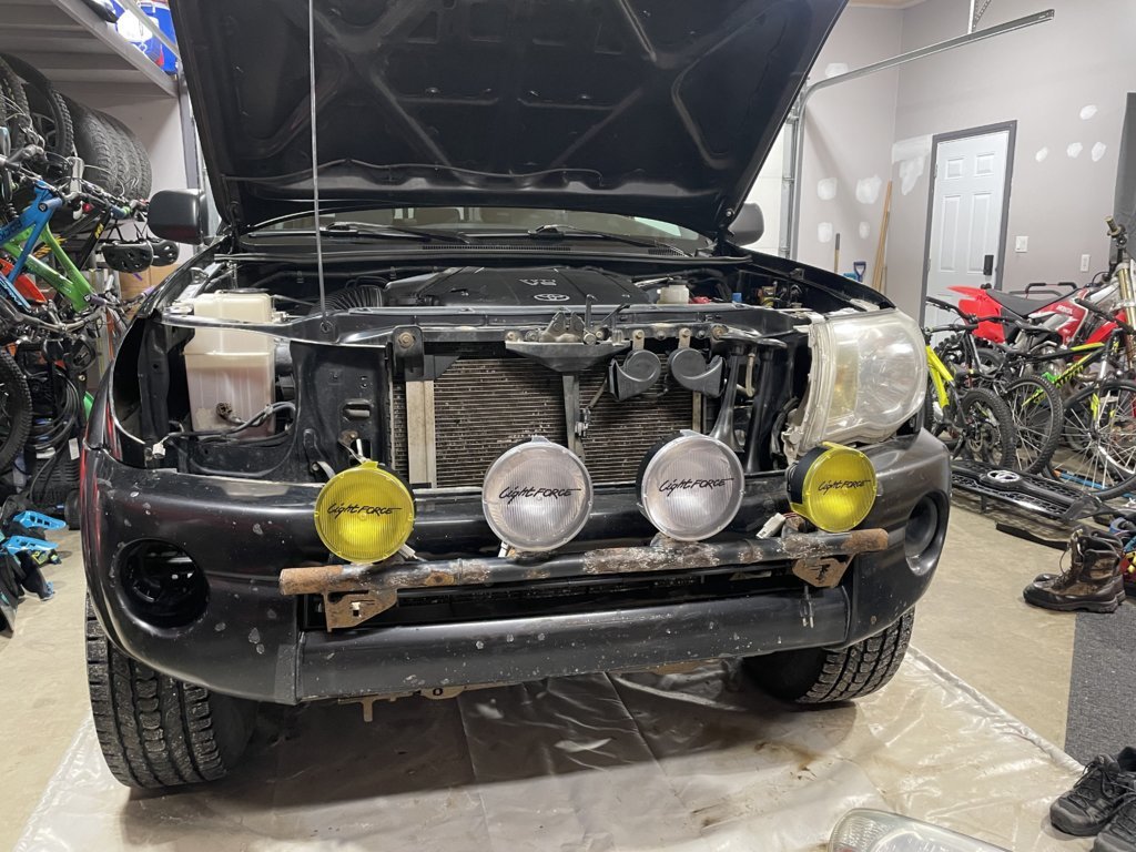

    IMG_2253.jpg IMG_2254.jpg A little overdue headlight housing change out today.

    It looks like its 1/8 inch lower on one side o_O:anonymous:

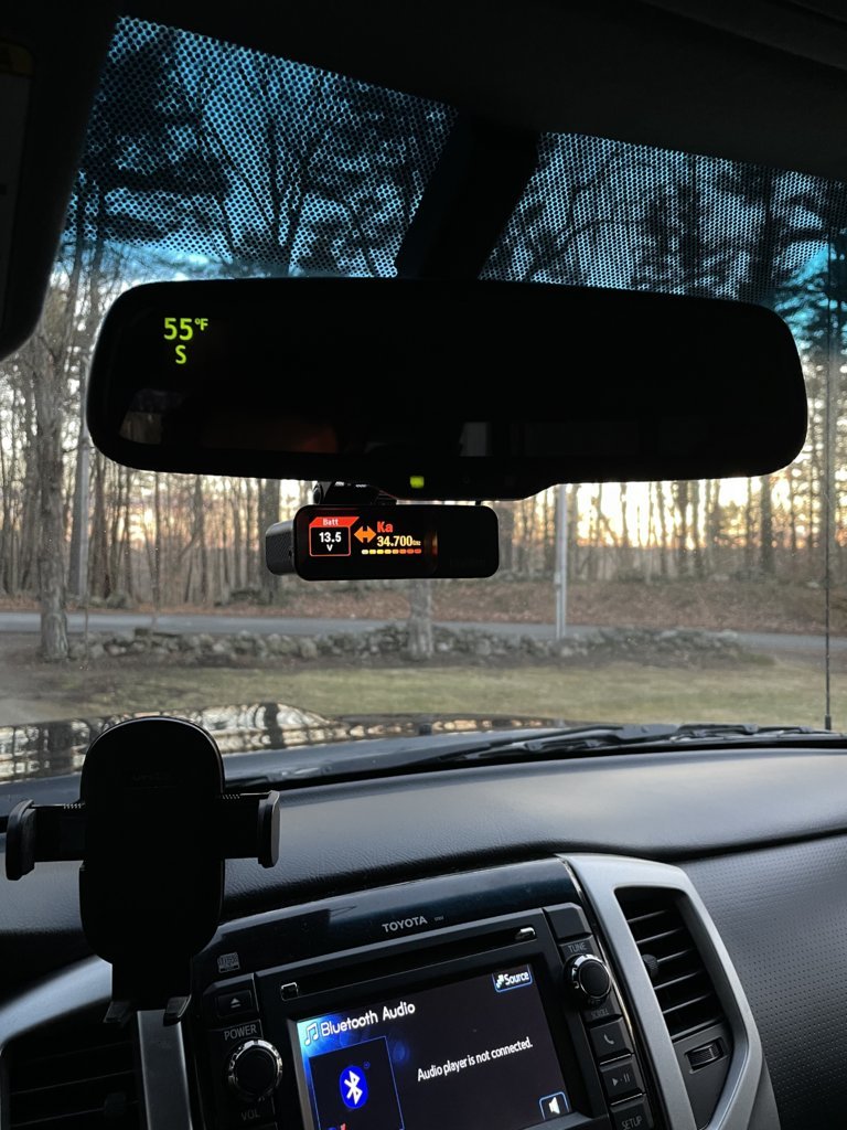

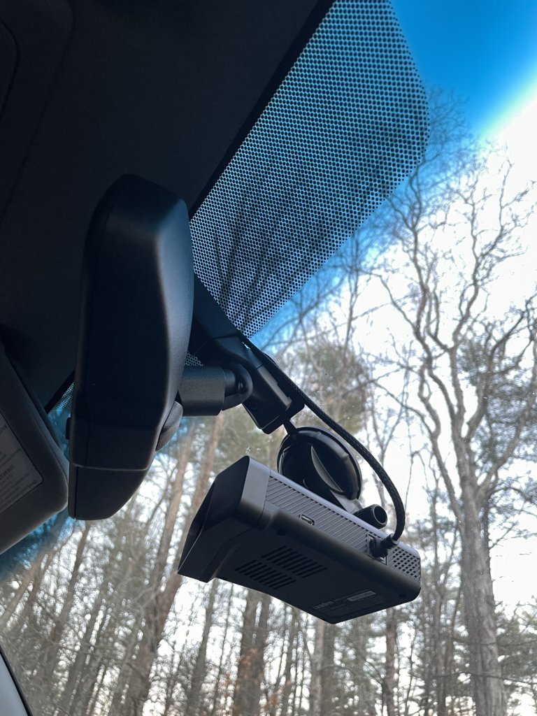

    Hardwired my radar detector by tapping into the rearview mirror plug so I don't have the annoying cord hanging down all the time. (No I didn't get the radar detector for a tacoma lol it's for my project car but that's away for the winter so might as well run it in the truck)

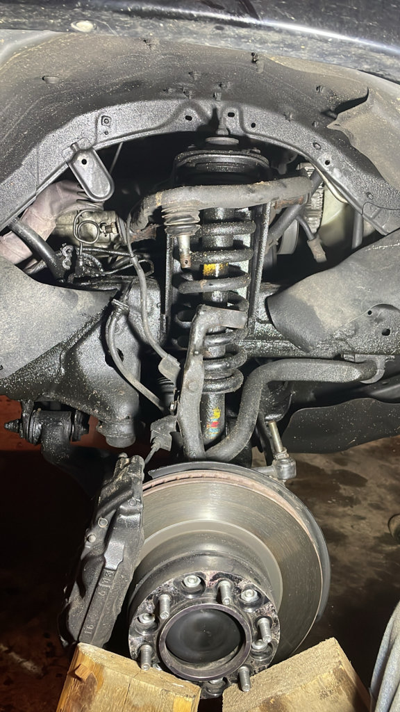

    Also replaced my 190k UCA's with third gen takeoffs with only 50k on them.

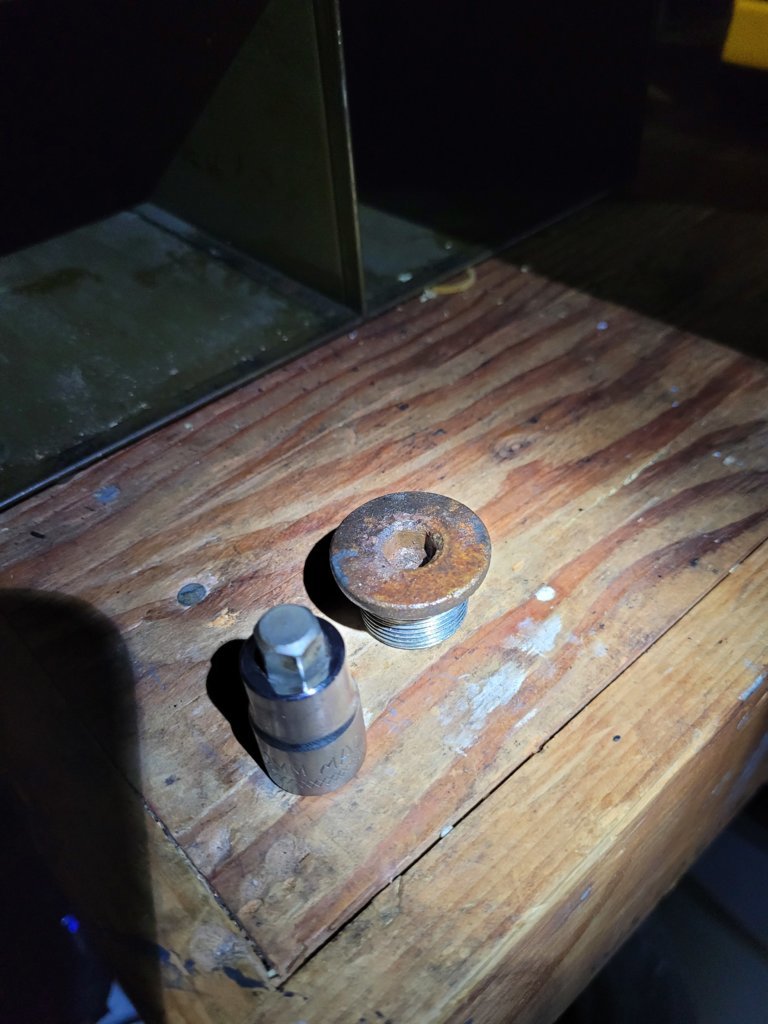

    Front diff oil done
    W lexus plug and lucas 75w90 conventional
    Now all my oils are done
    But I didn't anticipate oem mid skid plate one of the bolts snapped. Was for extended section of skid like a bracket but after playing w that for an hr I ended up just getting back all the others and theyre tight. I hope aftermarket skid don't need that bolt hole ever. Half the bolts were kind of a b and I wd40d them even for front and mid skid. Prob need to address them in the future
    Coworkers stubby 10mm for front drain w hand sledge 3/8 breaker when I knew I had it seated well

    Nice. I use a beltronics v955
    I like your setup, top of rearview though I need all windown space I can get

    Nice! Yeah I don't love the location but it's all that worked well with that mount I still had laying around. I just ordered another adhesive fixed mount so that I can mount it above the rearview mirror to the right behind the tint strip so it's pretty much unseen from the outside. That's where I run it on my Miata since there I reallyyy need all my windshield space and it's very discrete.

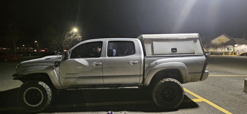

    My second Gen got a grandpa camper for the low.
