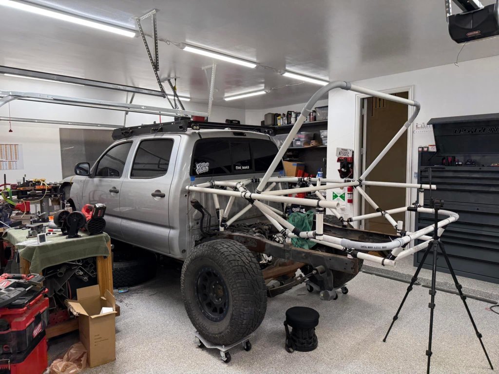

    My buddy is working on a Weld it yourself Bed cage kit for long travel trucks.

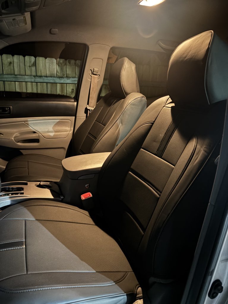

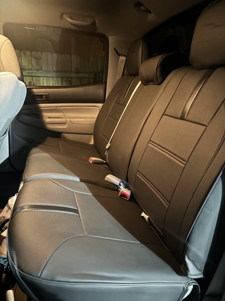

    IMG_3451.jpg IMG_3450.jpg IMG_3439.jpgInstalled new seat covers to cover the tears that are getting worse on the driver’s seat.

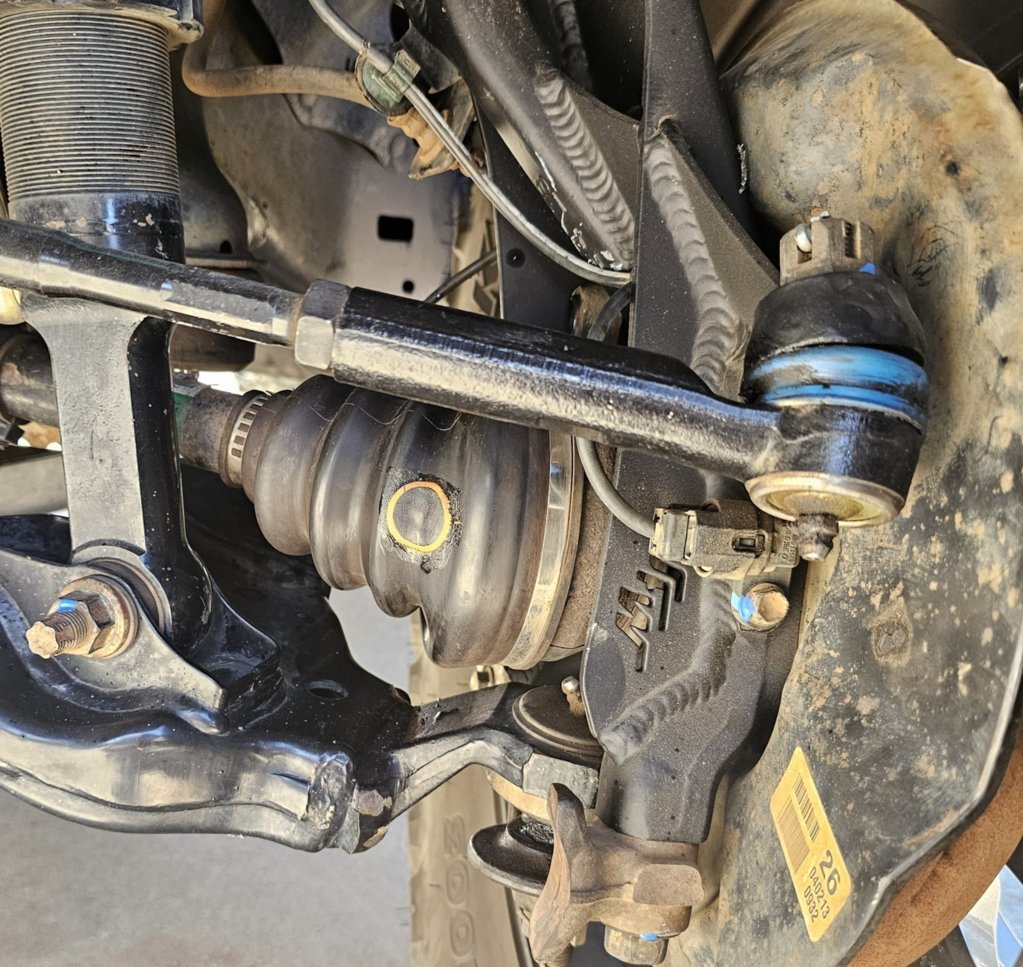

    I installed my 3G skid...aaaaand then saw this. It has 3 miles on it, probably shipping damage I didn't detect and I have a feeling the dealer will leave me holding the bag since it's been a few months since I bought it.

    That’s a pretty good spot to try a patch, not a lot of movement on it. Clean it real well, and try it

    I would think if it's a OEM from dealer it should have a 12 month or 12000 miles warranty. The hard part is if they didn't install then they will fight you for it.
    Good luck.

    I was wondering about that. Do you know what type of rubber it is off hand? EPDM?

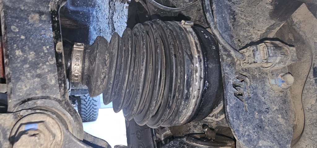

    I have done some patching on a torn CV boot before. I used a bike tire patch and it worked good a few months but eventually failed. I ended up getting axles from CVJ and one of the axles was leaking in the exact same spot as yours after using it for about a month. I contacted them and they swapped it out for free. Hopefully that dealer will replace it for you

    What brand is that, looks pretty nice.

    Mine is not even in the bellows area by the looks of it - appears to be right by the clamp. It probably got dropped and the inner CV body pinched it, I gave it a good look when it came in but nothing was visibly wrong with it other than a dinged up dust shield.
    I've got some industrial grade superglue for "difficult to bond plastics and rubbers" at work, I may see what I can do here if I am left hanging. I used it on some EPDM and it seemed to effectively fuse the piece; a test piece I made tore all the way through rather than delaminating. Being a brand new CV, the material is fresh; I may get an OEM boot kit and make a patch out of the inner boot and save the outer in case it fails and I need to suck it up and replace it.

    clean the area and apply some rtv silicone works like a charm .

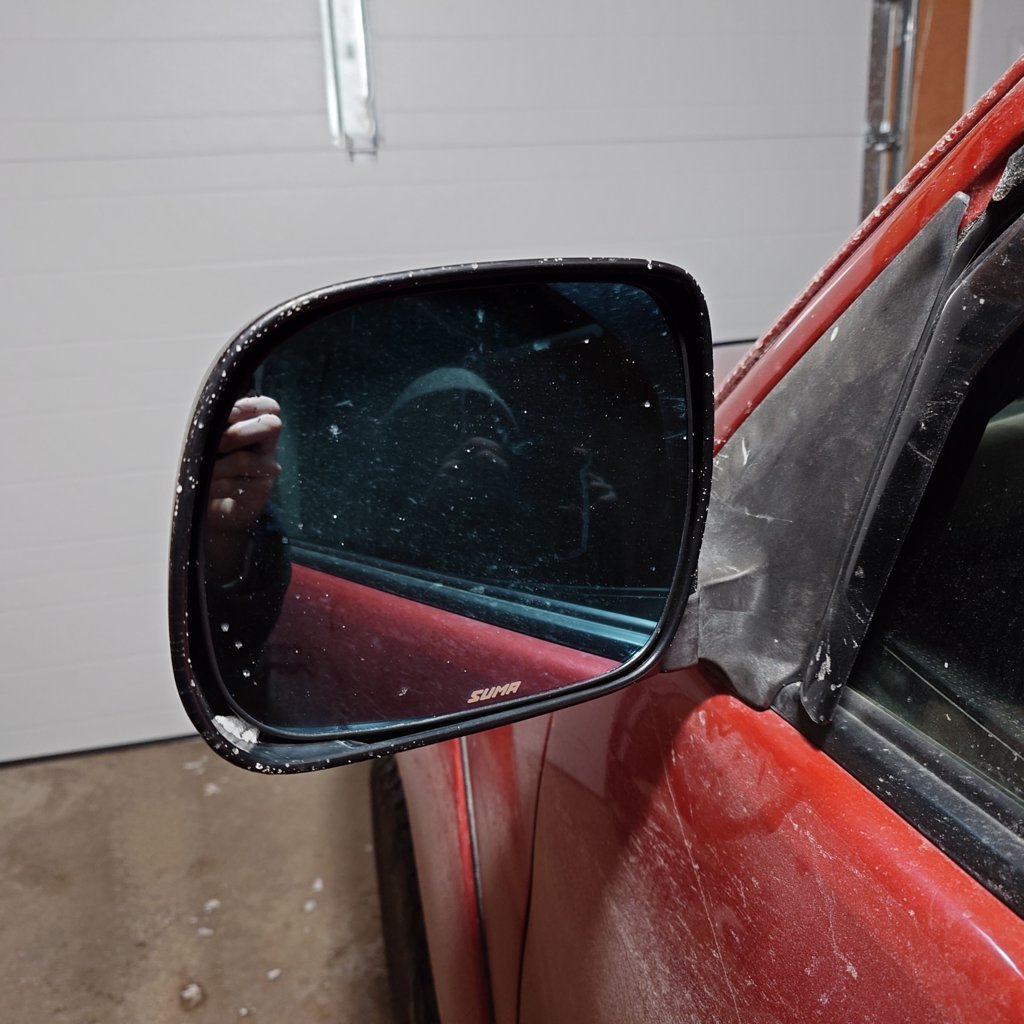

    Finally installed heated mirrors, already had the relay wired for about a year. They're anti glare and wide angle, as well.
