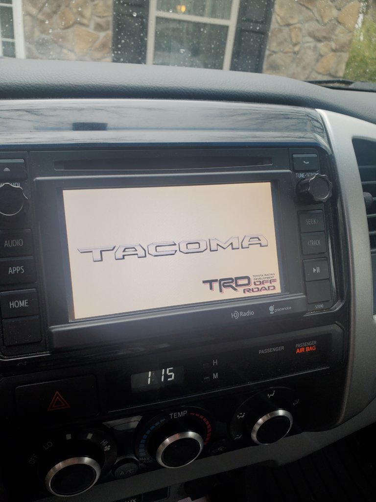

    Customized my start up screen.

    How?

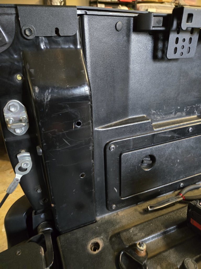

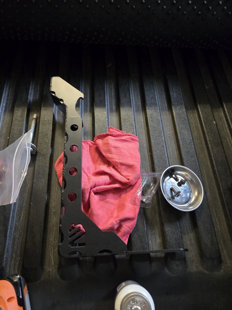

    Halfway done with my Lil B's bed stiffner install. Had to pause to help a buddy out with some spark plugs on his Danger Ranger.

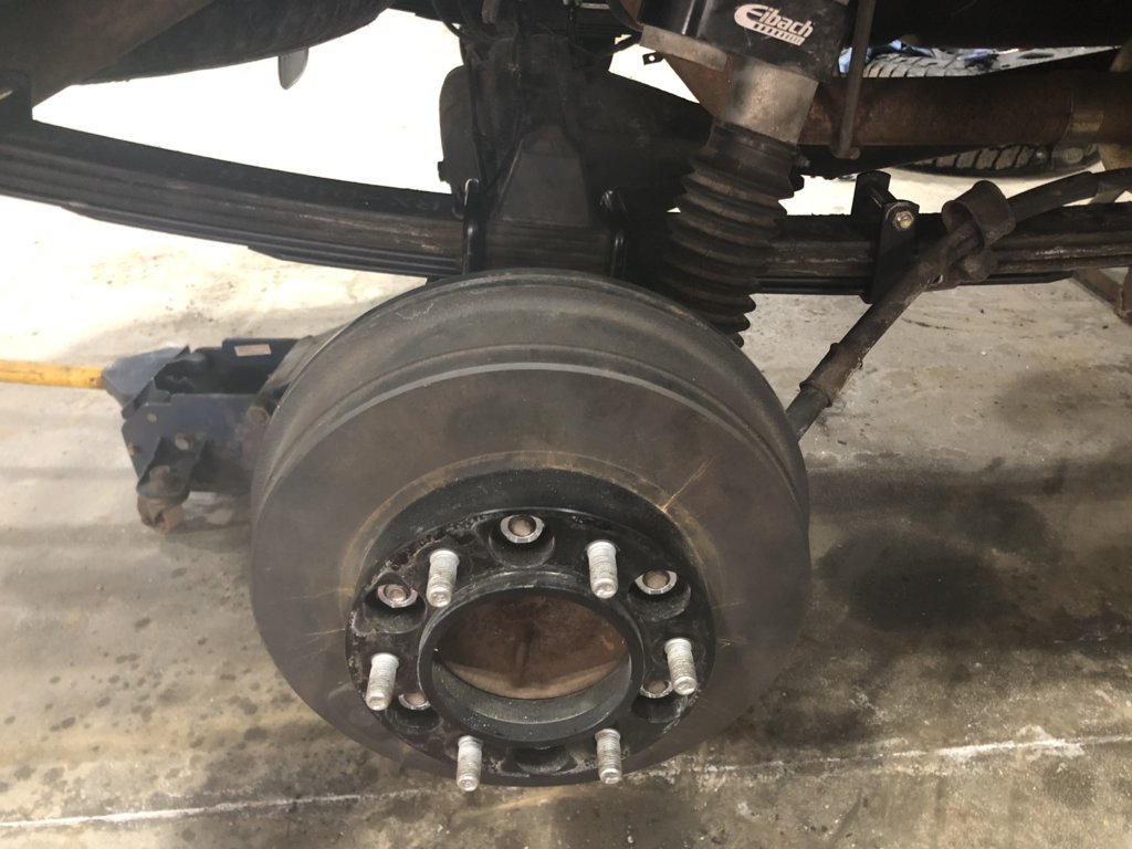

    Finished installing 3G leafs and Trail Edition 1/2" spacer. Netted about 1-1/4" total rear lift over pre-TSB 2 leaf springs. Still need to roll it out and see of that is where I want it, but I think that should be about right. But holy cow, this truck has been a complete unpredictable assortment of like new and stuck bolts, I was not prepared for that to be the battle it was. But it made the drum brake rebuild seem less annoying, hah!
    I also got a tracking number for a replacement CV from the dealer..I'm a little bit in shock, after almost a week of no news I thought I was on my own, but not complaining!

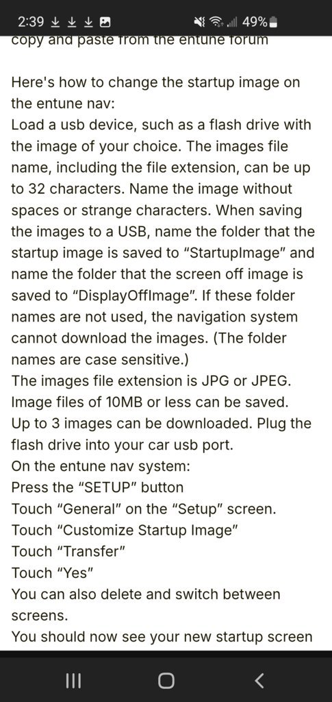

    I made the image using paint, used the owners manual and a USB drive to change the load up screen after the TOYOTA screen when you first start the truck. You can put any image you want there as long as it's Jpeg and not over 30mb. If you want my load up imagine I can send it to you if you want.

    I like the tailgate cover.

    This doesn’t work on 2012/2013 factory touch screens unfortunately

    Thanks! Definitely one of my fav mods.

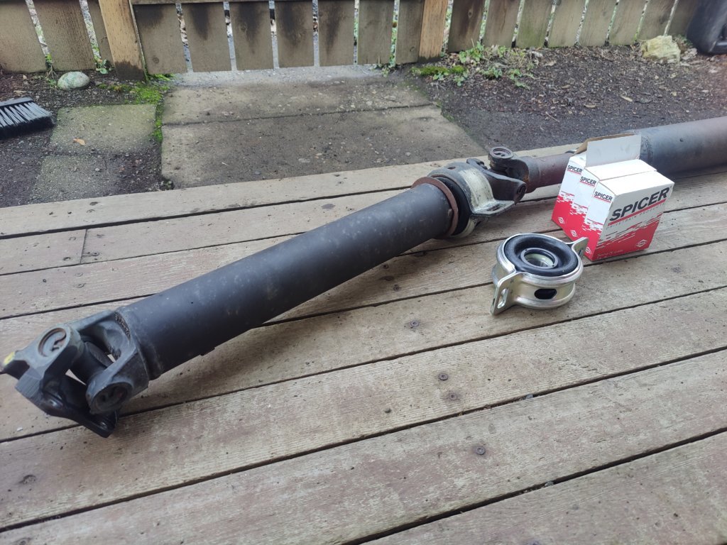

    Replacing my carrier bearing today. U-joints seem to be alright but I figured I'd just replace them anyways since I've got the driveshaft off.
