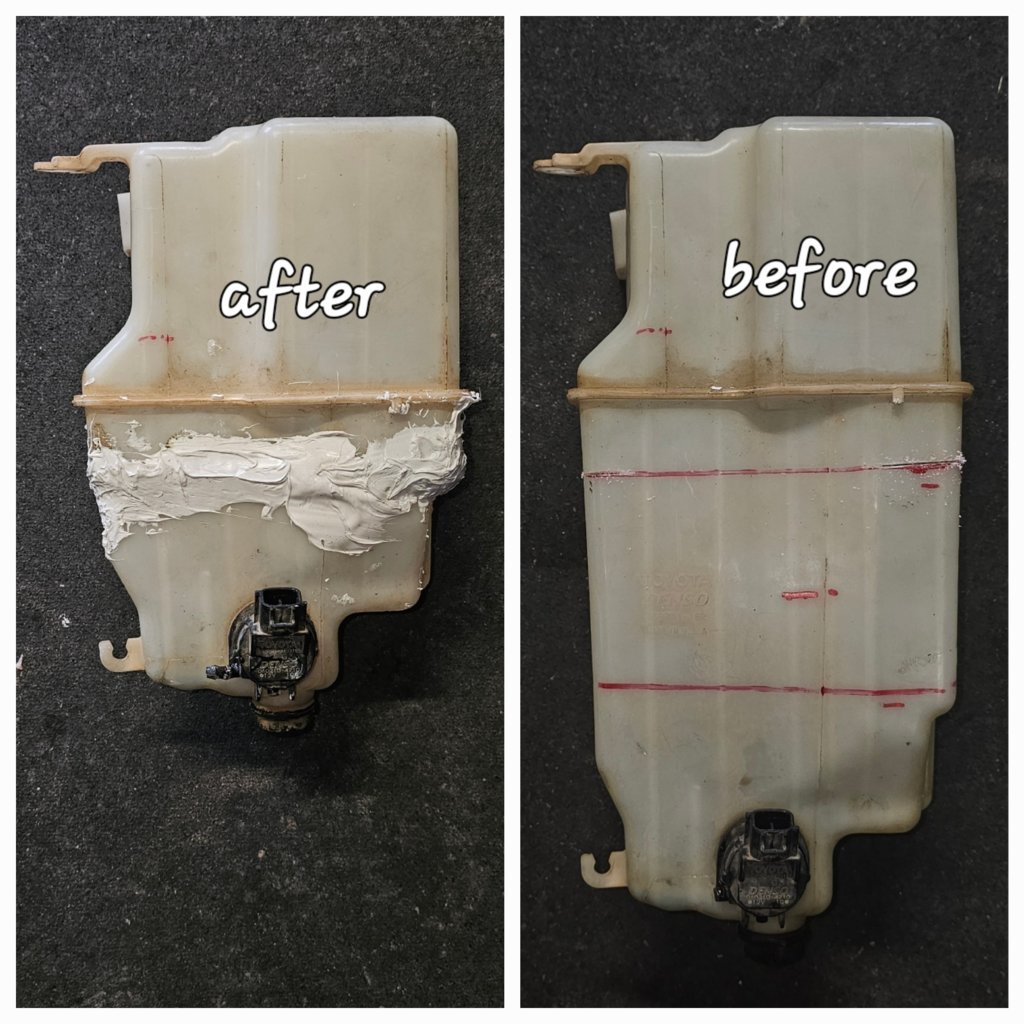

    I modified my windshield wiper reservoir by cutting three and a half inches out of it and then gluing it back together. This is because my 35-in tire when fully stuffed would hit the upper fender wells so I beat the hell out of it with a sledgehammer. Result is more travel when flexed out but Reservoir no longer fit. I didn't have the reservoir in for many months but recently I've been playing in the mud and this is a must have for that.

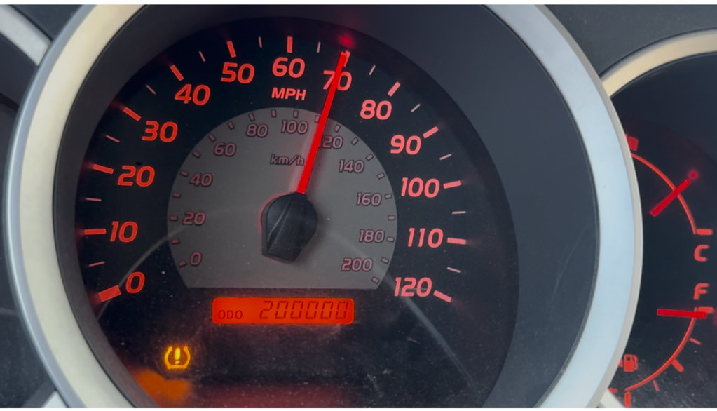

    Did a quick one day trip up to Sacramento last Wednesday to pick up an 4x4 conversion for my bros 1st gen and the old girl crossed over to 200k on the odometer. She rode perfect, no squeaks or squeals or any issues there and back.

    Plastic welder would have done the job. $15 Harbor Freight.

    $1.50 worth of Gorilla Glue got the job done first.

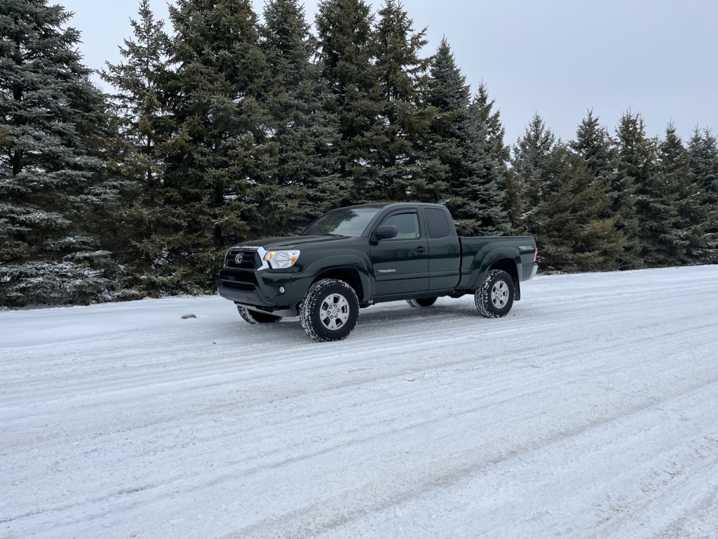

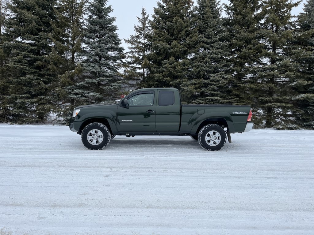

    Finally "finished" the rear bearings, brakes, and 3G leaf swap (+ TE 1/2" spacer). Got a bit more of a boost from the leafs than expected, went ahead with the spacer after reading some guys actually seeing some sag after the 3G leafs were put in, this might be a touch more rake than I wanted..but we'll see, other stuff to do before fussing with those again. Looking forward to driving this again, been off the road since...wow, September! :eek:

    how was it replacing the rear bearings? I have that on my to do list, but not confident in doing it.

    It kind of depends on what your experience level is, best I can advise is watch some videos and be realistic with your comfort zone. It wasn't as bad as I was bracing myself for, but I did get a 20T press and the special press tools, and made a 3D printed seal driver to get it driven in squarely and at the proper depth. I'd plan on a full weekend, one day to do the first one, and once you've got the process down, the 2nd should be something you can knock out in a few hours I would say; and then plan on the drum brakes to be a really fun bonus job, haha.
    One side came off easy; the other made such a loud bang when it finally let go I literally had a headache for a couple hours afterwards (and it kind of freaked out the dog). Both of the press-on spacer/retainers were pretty badly galled, I know some guys seem to be able to salvage them but it's not something I'd plan on. I didn't want to get stuck waiting on parts, so I basically just bought everything but the axle itself. I primed myself for the job with these two videos (the press tools I got are shown in the 2nd one by 'Timmy the Toolman' but he's doing a Lexus or something in that video which seemed a little different; the first by KFlo is a direct how-to for 2G/3G Tacoma but he uses a slightly different set of tools on the press).
    https://www.youtube.com/watch?v=NcrlDQL8NIg
    https://www.youtube.com/watch?v=fRkedFQkrqs
