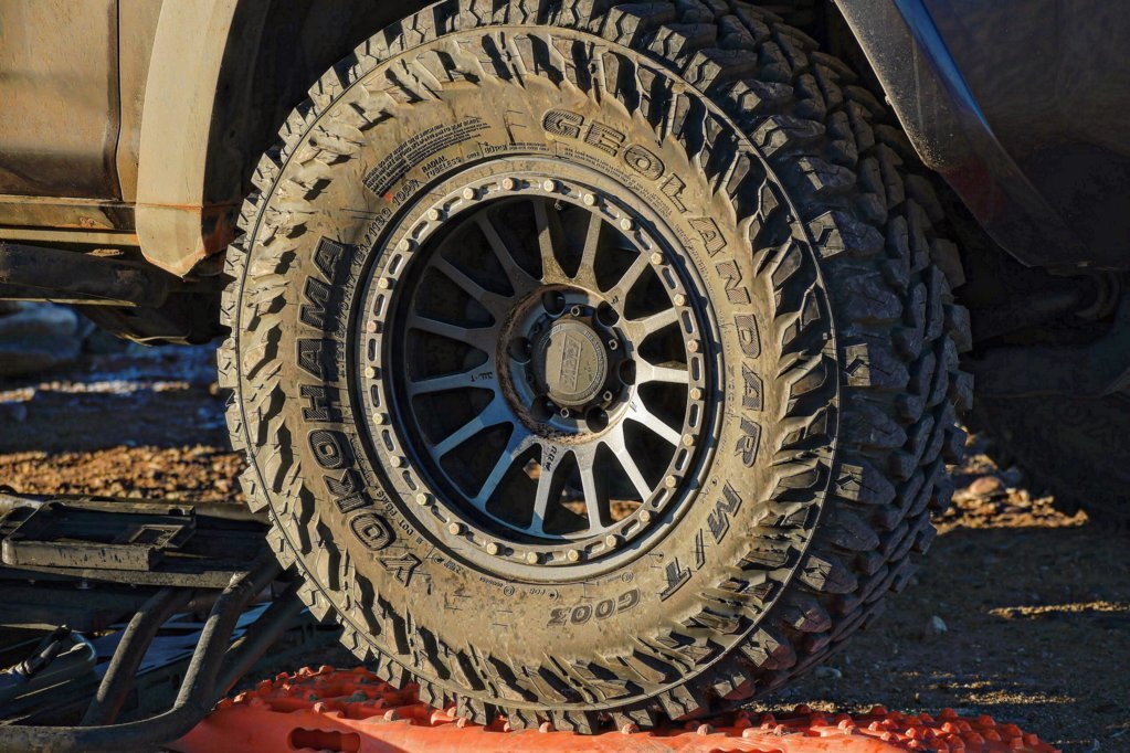

  5. Feb 21, 2025 at 6:23 PM
    TegoTaco
    TegoTaco Well-Known Member
    Sep 29, 2016
    #198555
    7,280
    Ontario, Canada
    ‘13 SUPERCHARGED DCLB TRD SPORT
    Just ordered these in a 35x12.5R17
  6. Feb 21, 2025 at 7:09 PM
    BBtacosurfer
    BBtacosurfer Well-Known Member
    Nov 23, 2012
    #91716
    3,877
    Dave
    ID
    MGM 2012 4x4
    I have the same tires in the same size and I’m going on year 5 with them. Badass tires!
    TegoTaco[QUOTED] likes this.
  7. Feb 22, 2025 at 12:01 AM
    Tacocharged
    Tacocharged Member
    Feb 7, 2025
    #465515
    15
    Adam
    SoCal
    2015 Charged Taco
    Magnuson Supercharged OV Tune
    Wow 5 yrs on an MT?!?
    TegoTaco likes this.
  8. Feb 22, 2025 at 1:29 AM
    fasteddieyj
    fasteddieyj Well-Known Member
    Nov 25, 2018
    #273740
    856
    Ed
    Hanover, PA
    2015 camping/mild wheeling rig. 2014 DD
    I've been running these in a 285 for about 3 yrs and will be stepping up to 315s this year. Really good tires.

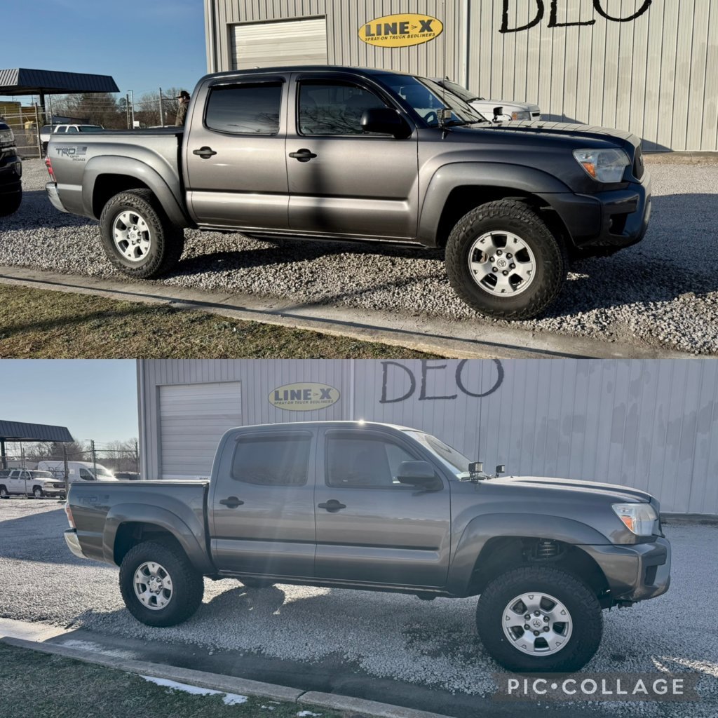

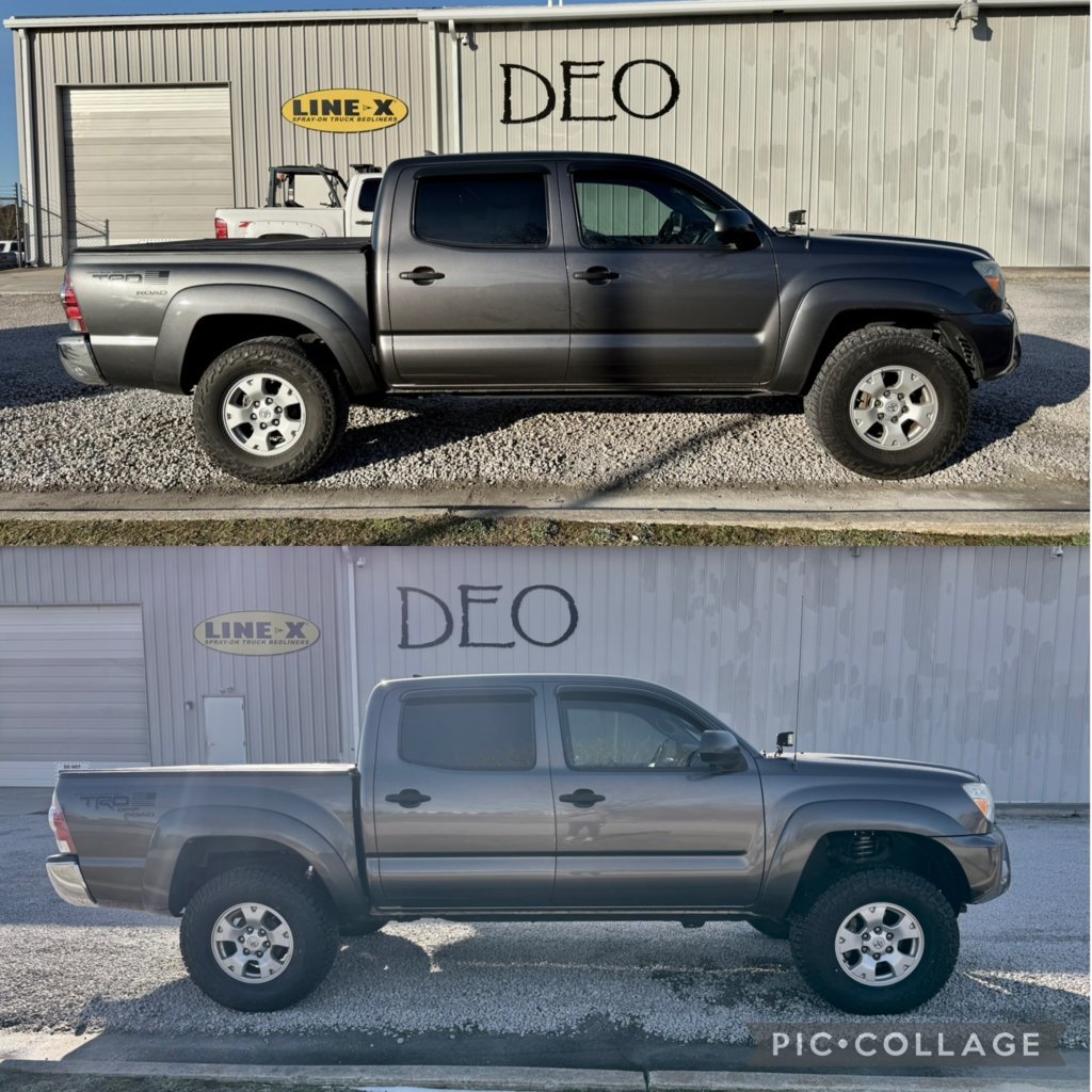

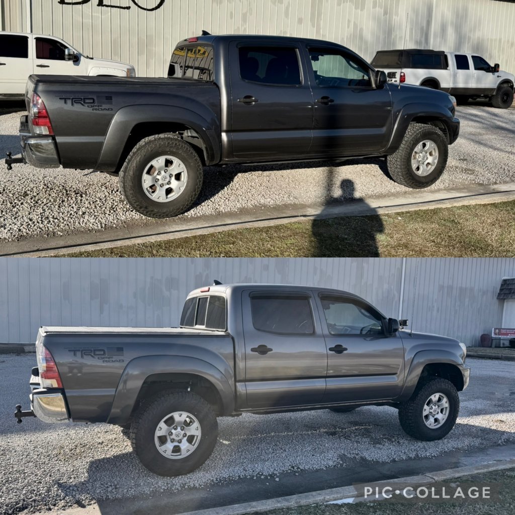

  10. Feb 22, 2025 at 4:38 AM
    BravesFan95
    BravesFan95 Well-Known Member
    Apr 5, 2018
    #249537
    103
    Eastern NC
    2015 DCSB TRD OR 4x4 mgm
    Eibach Pro Stage 2 kit front and rear w/1" rear block installed after 150k miles on oem suspension (1.75"). New Wildpeaks (265/75/16). Truck rides brand new again. Putting new oem headlights in this weekend too. I appreciate all the advice tacomaworld provides for these types of decisions.
    GRNT4R, lowmower, SSX999 and 6 others like this.

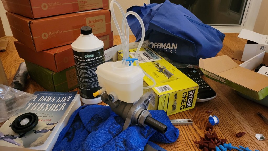

  18. Feb 22, 2025 at 9:47 AM
    reg188
    reg188 Well-Known Member
    Jun 18, 2023
    #427082
    58
    2006 TRD OR 6MT
    Had the original master cylinder leak into the vacuum booster, lost most of my brakes coming off the highway. E brake to the rescue!
    Replaced both of those and the firewall gasket over the last few days after work, did a solo bleed job that worked pretty well but I'll get a buddy to finish it up. Feels SLIGHTLY mushy.
    Had never bench bled a master cylinder, learn something new every week.
    hinmo24t and Hay Lobos like this.
