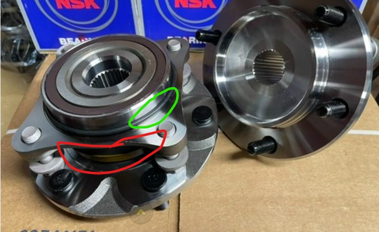

    thank you Sir!
    ebay comes with this
    the dust cover for axle seal you meant, what is knuckle seal? what do you think the timken oil seal correlates to in the ebay descript?

    I believe that timken oil seal is the one that sits in between the hub and bearing, so it goes in before they press it together, same with the bolts. You can see it in their listing pictures a bit. I circled it in red, and also circled the o ring in green that you would need that I don't think I see on the ebay listing but is included in the ones from 05Taco4x4.

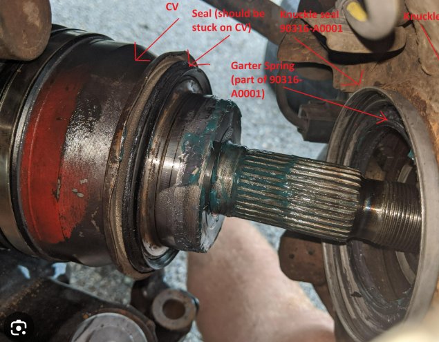

    This pic below shows the CV and knuckle seals I was talking about. Both of mine were rusty and torn and not reusable. There's an equivalent seal from National that apparently matches OEM if you search for it, they just get tapped on/in.

    adding that response to my vehicle-to-do-doc, appreciate the info

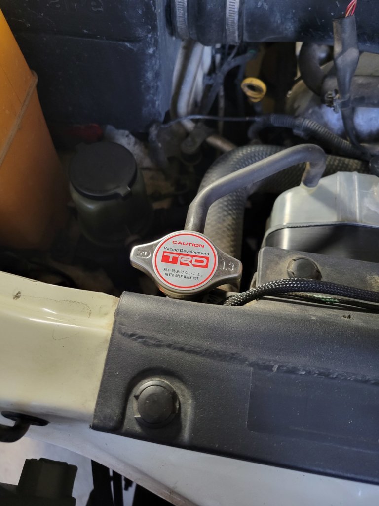

    Finally did a coolant flush, might do waterpump and alt soon.
    Also, why not

    Why does it look so nice lol!

    Correct

    Cause TRD lol

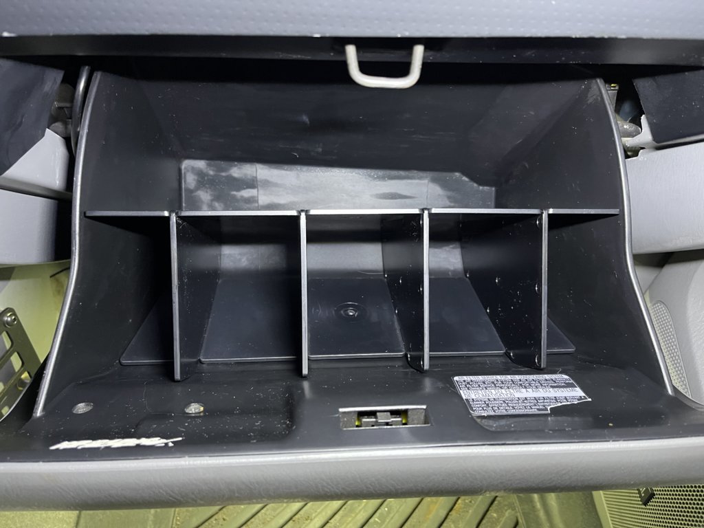

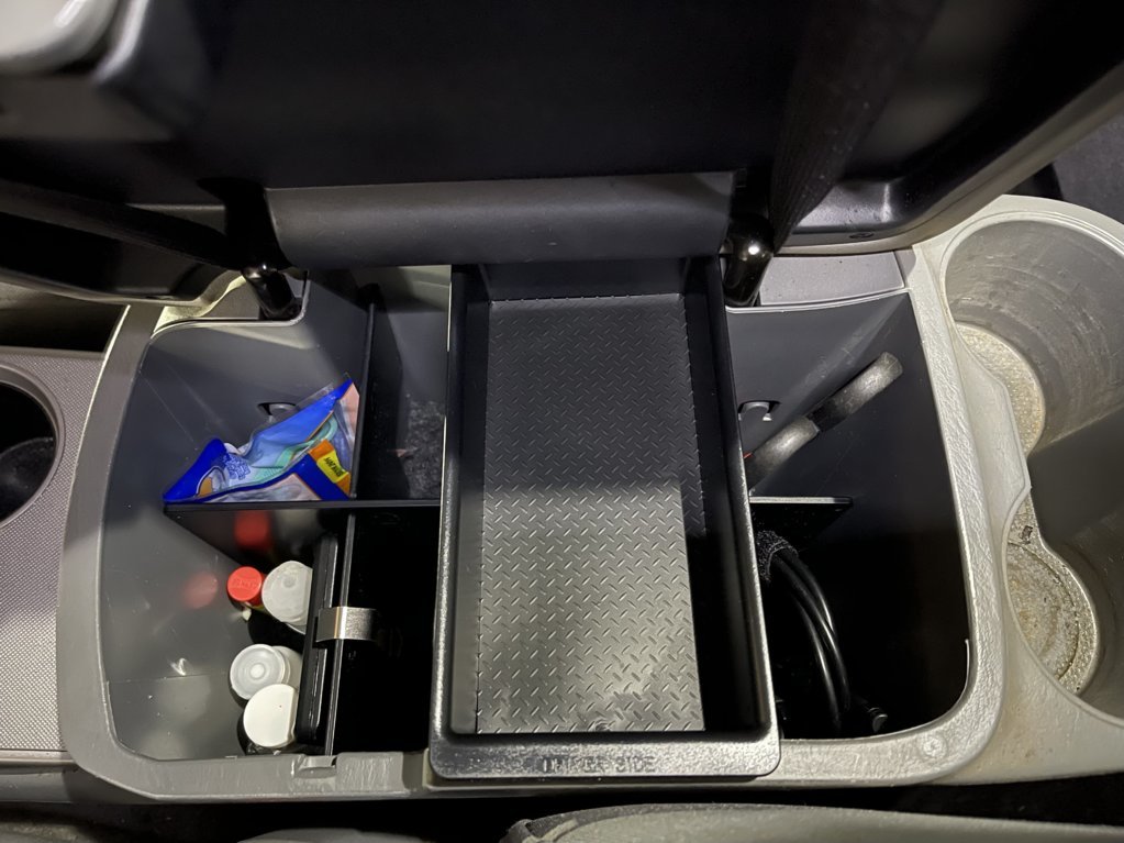

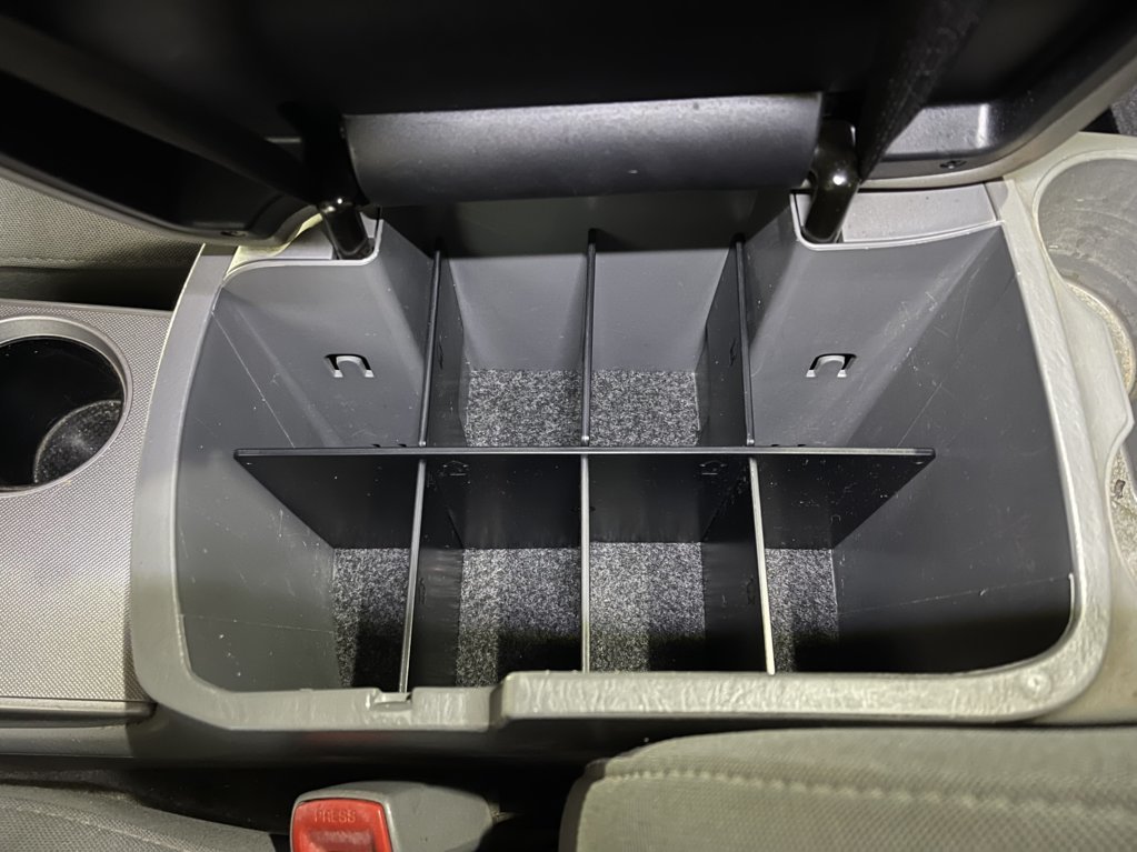

    Little this, Little that.
    Vehicle OCD organizers.
