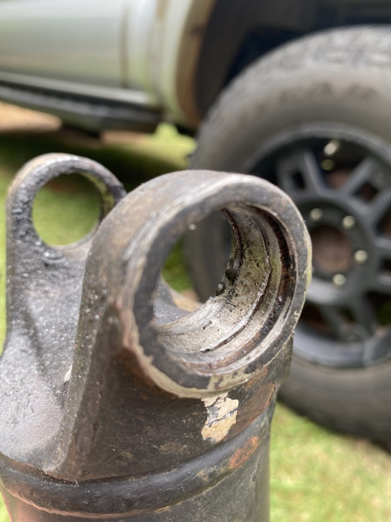

    Cut the u-joint out.

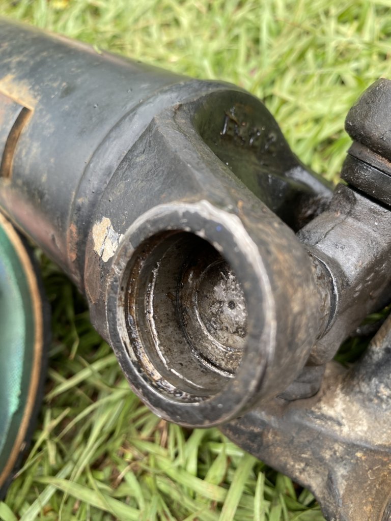

    2nd question. Can I deburr this and keep running with it? Would suck to wait for another drive shaft

    I would try. You have nothing to lose.

    that doesn’t look great. But as long as you can get the new joint installed, the cap is firmly seated and the center section doesn’t bind, you should be fine

    I would try as well in your position. Round file to knock down the edge and smooth a bit, and see how it feels pressing in, seating, and for any binding. Worst case you're out the cost of another u joint and a few min of your time if you have to redo it
