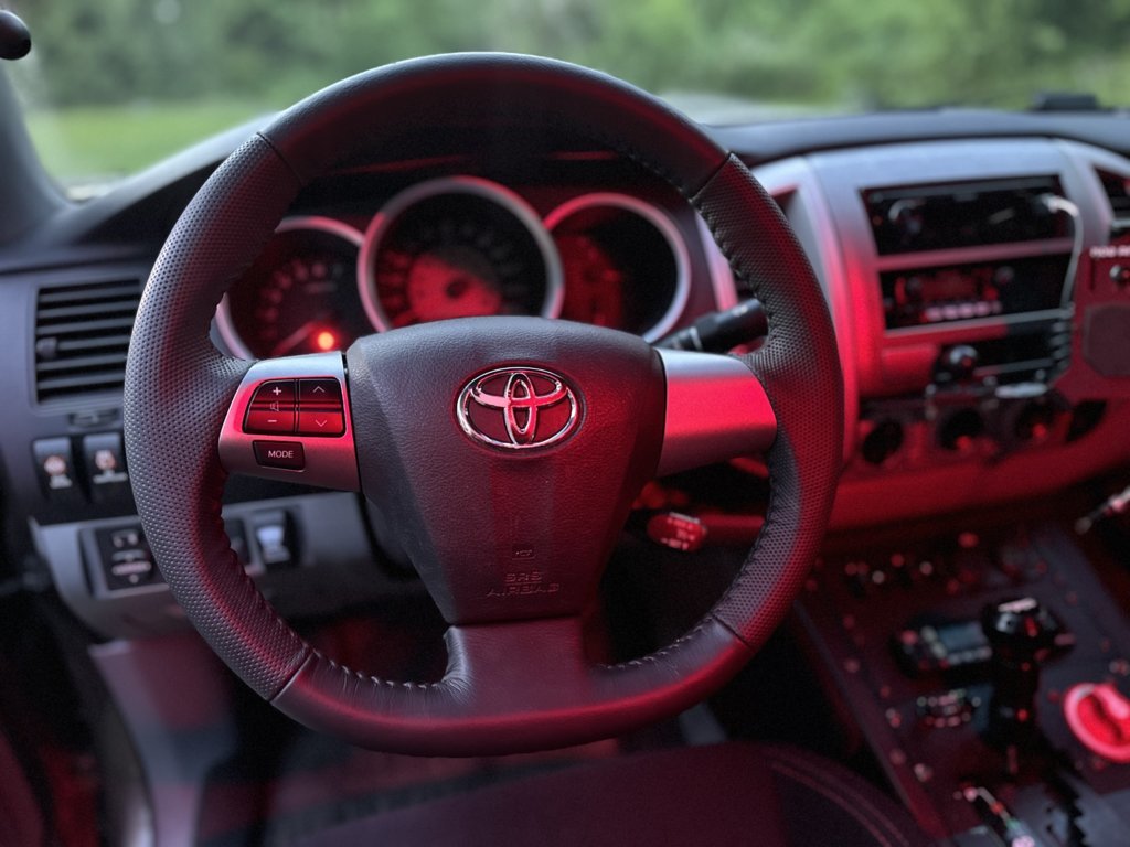

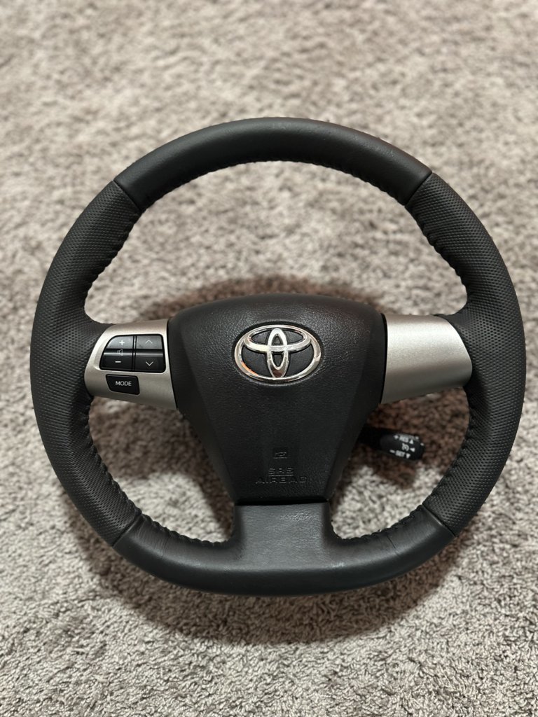

    Did you have steering wheel controls before the switch?
  2. May 5, 2025 at 9:17 PM
    JdevTac
    JdevTac Well-Known Member
    Jan 8, 2012
    #70234
    6,312
    Josh
    MD/GA
    2nd gen
    Yes I did
  3. May 6, 2025 at 6:54 AM
    Hayden334
    Hayden334 Well-Known Member
    Jul 22, 2021
    #371997
    1,448
    Hayden
    Cullman, Alabama
    2010 Tacoma DCSB TRD OR
    2" spacer lift, 285/70 R17's and a Softopper.
    Man I like that. Simple with a subtle sport look. I need more details, how was the wiring?

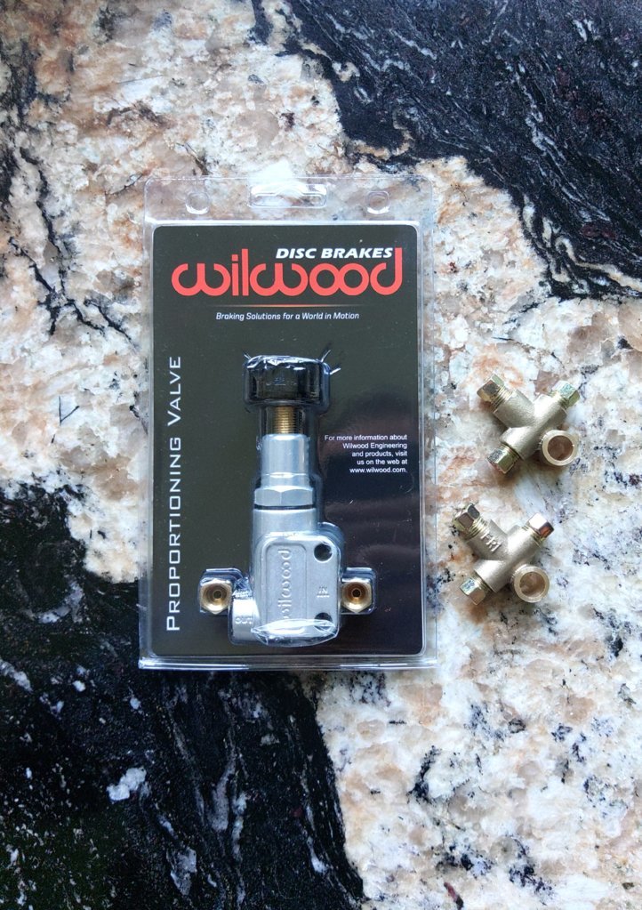

    turned on a couple more dash lights yesterday by removing the ABS unit. Replaced it with a couple of tees and an adjustable proportioning valve. brakes are already better, before tuning the front/rear bias.

    It’s essentially plug and play for a 05-11 Tacoma.
    The only difference is that the Matrix wheel has the horn ground plugged into the radio control connector, where on the Tacoma it is tied in with the cruise control connector. Easy fix you just swap over the Tacoma cruise control+cable to the Matrix wheel. The matrix wheel came with a cruise stalk but it has slightly different part number. It’s possible it may have worked and I could’ve just swapped over the Tacoma harness only, but I didn’t bother trying.
    The airbag is from a 2010-2013 Matrix. They are very hard to find from salvage yards or eBay. The same steering wheel/airbag is found on the elusive 2010-2013 timeframe Corolla “S”. But those are even harder to find used.
    Steering wheel is supposedly OEM surplus for a Matrix with an upgraded interior package.
    I can’t remember the airbag part# but this is the type of airbag linked below. A standard corolla airbag won’t work so again, has to be either the Matrix airbag or a Corolla S for the sport wheel. I bought mine from Benzeen auto parts salvage yard for like $235 after making a counteroffer. They had only 1 in the yard.
    https://airbagnation.com/products/2...Y6g87ExYDFvXGYyPapy9qyvOiXOral_MaAs_fEALw_wcB
    Here is a link to the steering wheel:
    https://www.ebay.com/itm/2325285231...oQpBoENSKq&var=&widget_ver=artemis&media=COPY

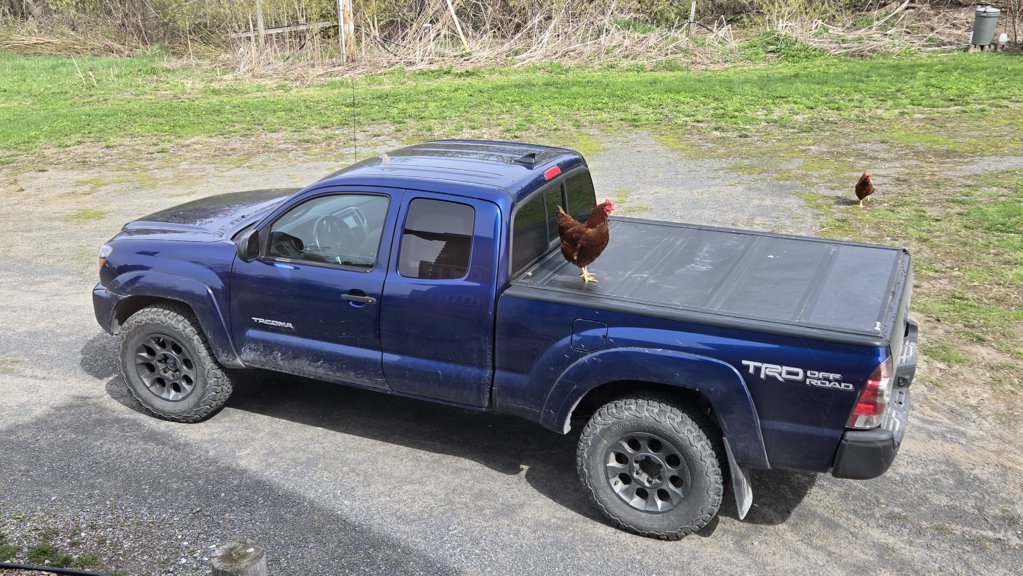

    Took me all day, but I finally completed the Taco Chicken Roost mod
    And, thought this was neat...

    sweet fj trails. that blue ribbon metallic?

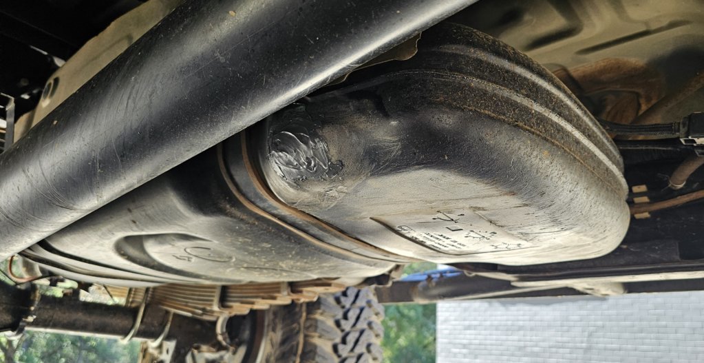

    Did you plug it with something first before you put the JB on it? because that's impressive.
  10. May 6, 2025 at 1:48 PM
    UMC
    UMC I will not comply
    May 2, 2019
    #292062
    523
    Thomas
    South Fork of the American river.
    13 TRD Sport DCLB 4x4
    37's & rear locker
    Yes plugged it with more JB Weld.

    Thanks, and yes

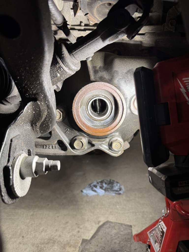

    Installed my ECGS bushing. It went much easier than I thought it would.
    We’ll see if that roaring goes away.

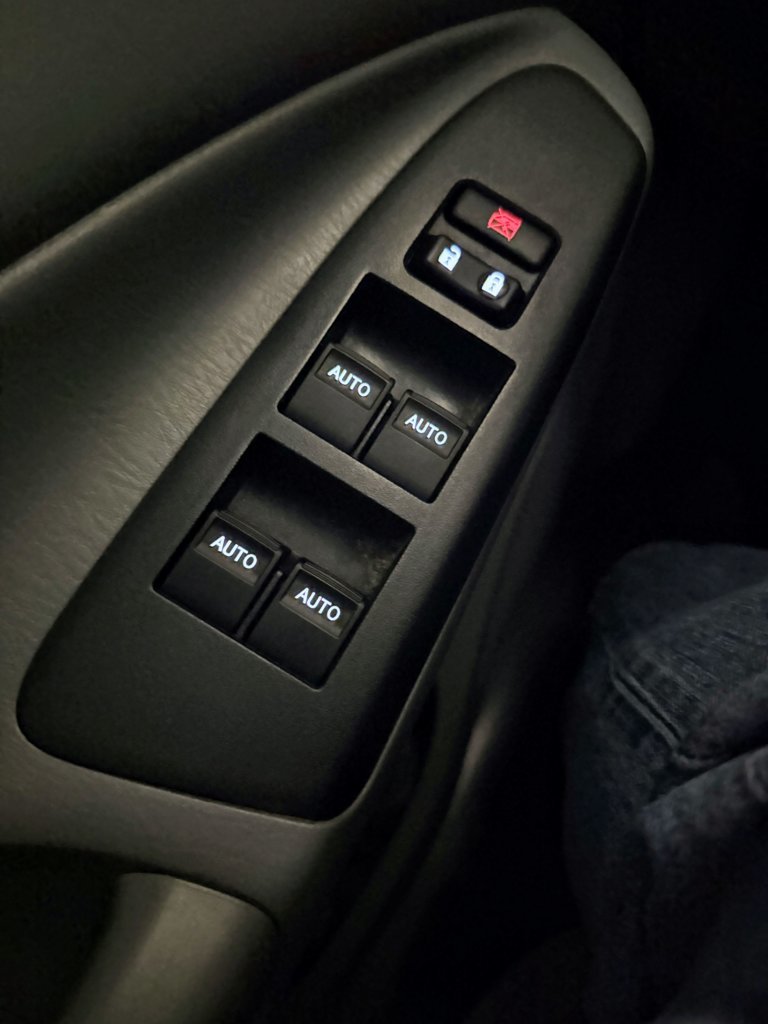

    Auto up/down switch for all 4 windows.
