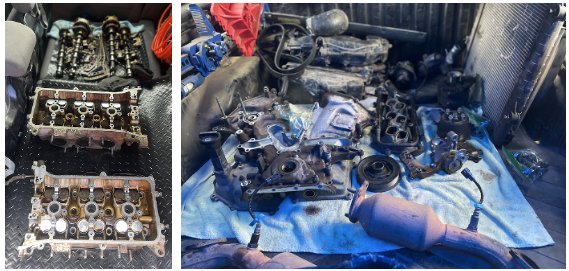

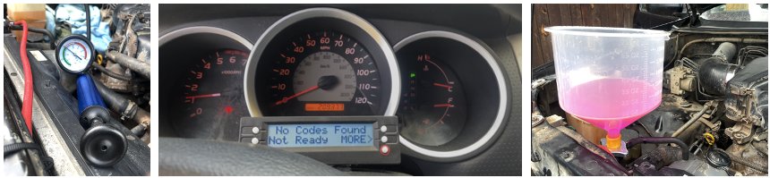

    Validated my HG repair is working as expected. Definitely very nervous jumping into this ... but so far so good!
    Did this outside -- so the truck and the bed with the camper shell with some tarps was my storage ...
    ... re-assembly with clean heads ...
    ... holding pressure ... started right up with no codes ... temp stable ... no bubbling ...
    About 40 miles in ... ALL IS GOOD :cheers:

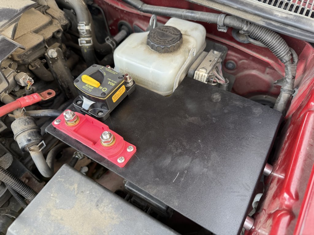

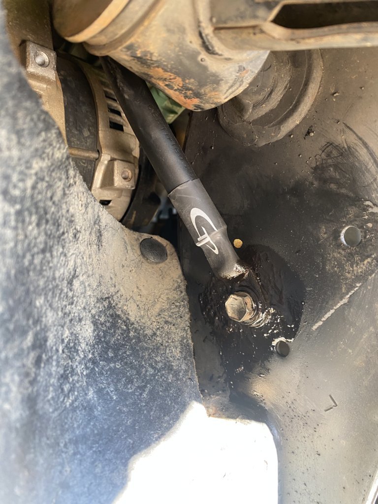

    Looks good dude! Don’t forget the batt to frame ground.

    Thank you, for kind words! I have to ask though, what do you mean by battery to frame? In the package I had the following negative battery cables:
    - Neg Batt to Starter
    - Neg Batt to Body/Fender
    - Engine to Frame
    Since there were no videos and limited write ups I connected all the upgraded cable ends to the same contact points that the OEM harness did. The only exception being the alternator since it now connects directly to the battery with the added fuse protection.
    In your photo you are showing what I considered the frame contact point. I attached the “Frame” end of the “Engine to Frame” cable there. The other end is attached to the negative contact point on the starter, along with the “Neg Batt to Starter”. That’s because the OEM harness made the same connections.
    I was inclined to do my own write up, but this took WAY longer than I anticipated and I was rushing to get the truck running again at the end of the day.

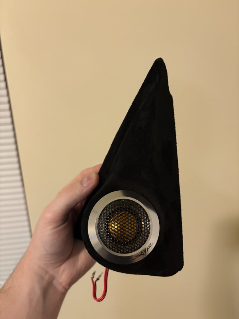

    Just finished up the passenger sail panel tweeter pod. Driver side coming up this weekend.

    That looks so good, nice job!

    Thank Yall! I’m about to do a build write up in the A/V section.

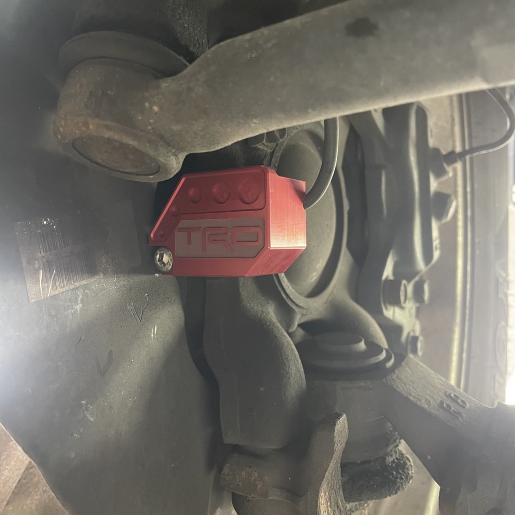

    Abs sensor covers fit nicely. Keeping the trd theme going strongIMG_5158.jpg
