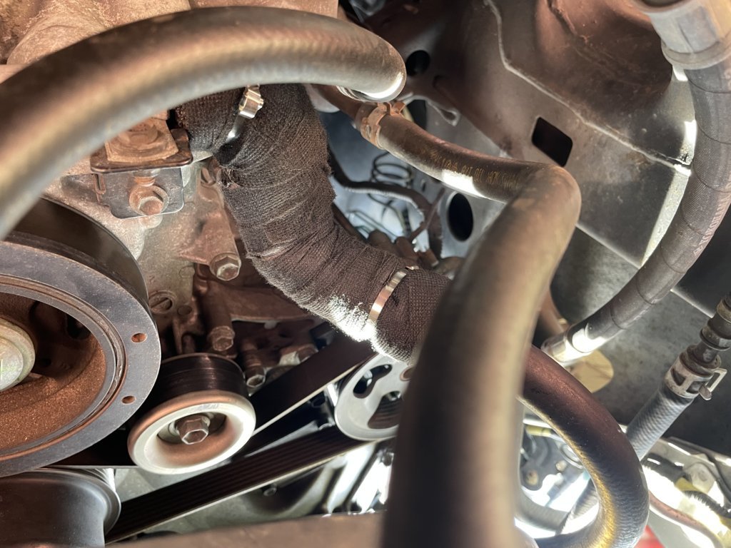

    Thanks for asking. Part of the line at one point runs about a half inch away from the lowest idler pully and 1 inch from the drive belt crank pulley. The insulation I used is 1/2" thick. I don't want to take the chance of potential debris getting in the drive belt. It could be easily done and was tempting. As you said that part of the line is mostly in front of and below the engine and likely not as hot.
    The part I insulated is above the exhaust manifold area of the engine bay. I believe insulating the potentially hottest area is better than nothing. I'm happy with the results.
    Here is where I stopped.
    After that the clearance to drive belt pulleys gets too tight. At least 3/4 of the total pipe is insulated.

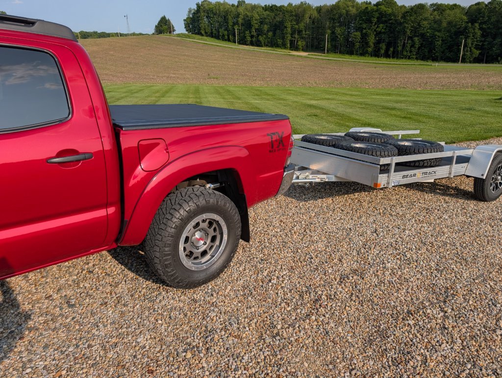

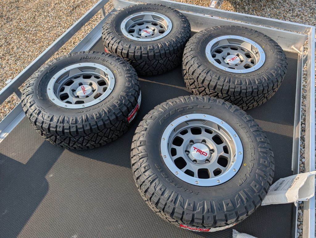

    I bought another set of TRD beadlock wheels during the parts sale. So got some new rubber mounted on them today. Now I have a summer set and a winter set.PXL_20250610_223616874.MP.jpg PXL_20250610_223544380.MP.jpg
