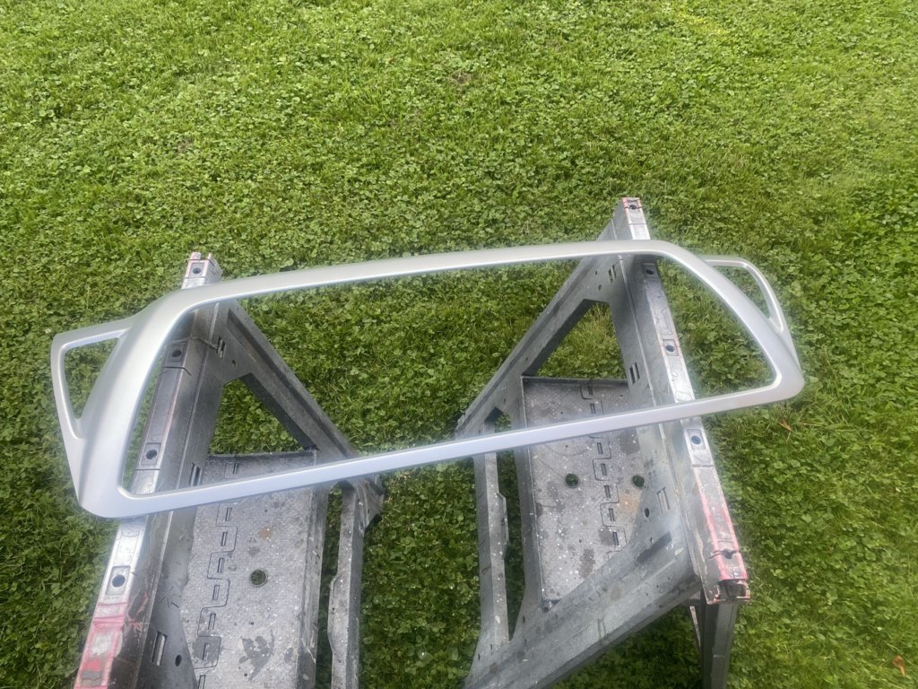

    The same shit everyone else has.

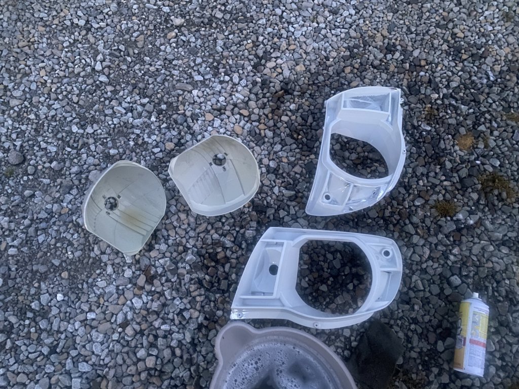

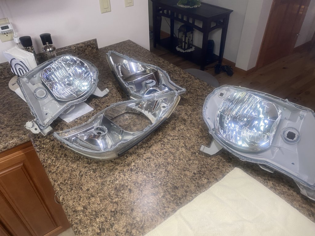

    Oven cleaner on the headlight chrome.
    It wipes right off with a grey Scotchbite.
    I had to peel it off the grille shell because its way thicker.

    I had no idea oven cleaner would do that, good to know!
    Yep.
    Oven cleaner will typically eat right through the plastic chrome “plating”.
    Bleach will too usually.
    It’s not strong enough to eat through the plating on the grille shell though for some reason.
    Industrial degreaser like Zep allegedly will though but I’ve never tried it.

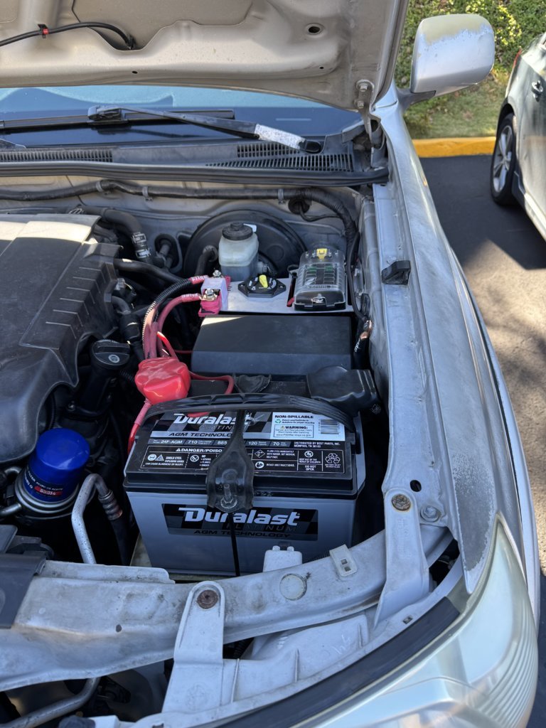

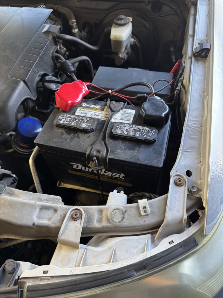

    Jeep cables.
    The fuse box took me a lot longer than I expected! Starting up the first time was a heart in mouth experience haha

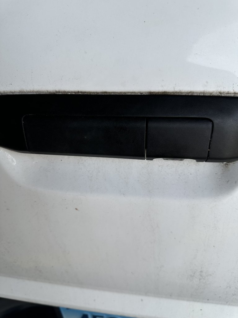

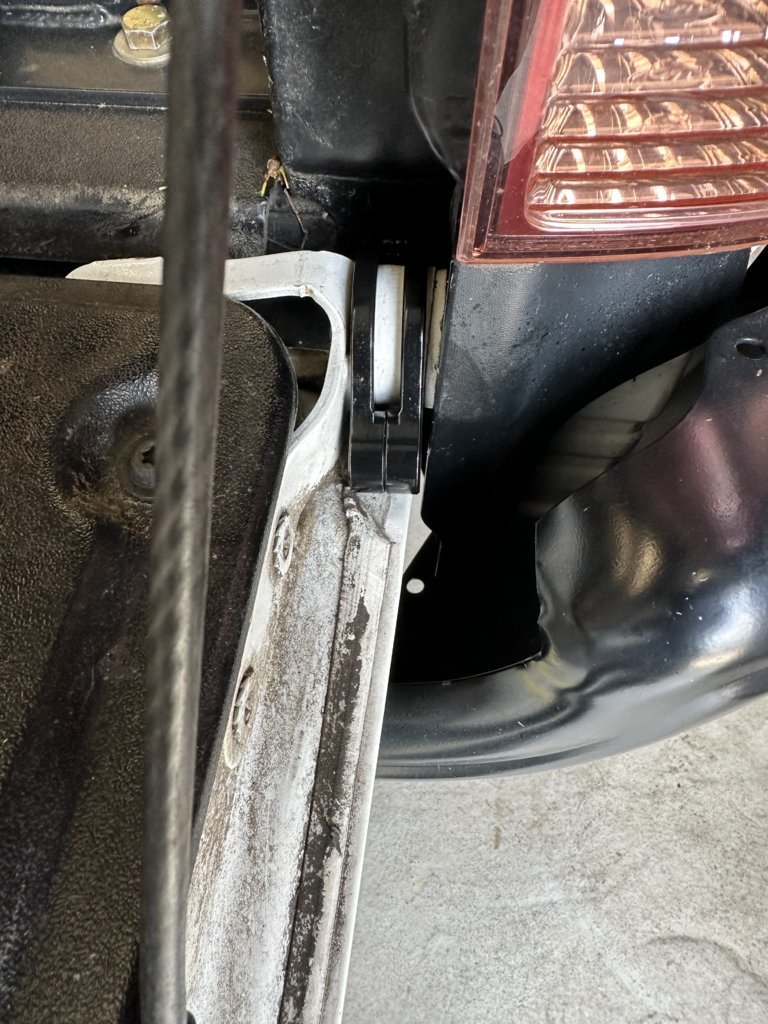

    Installed a new tailgate handle. My Pop & Lock was discolored very badly.
    also installed the anti-theft device from SaBellCo
    Yes. My truck needs a bath, I know.

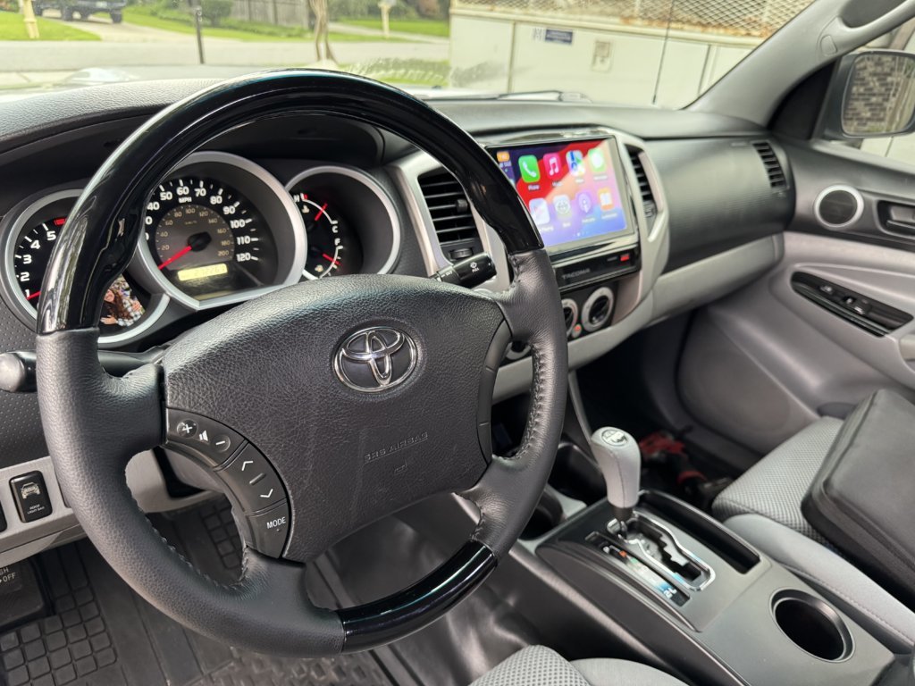

    Replaced my worn steering with a new one, old wheel that was similar lasted a long time! Really like the gloss accents.
    Wish every steering wheel swap was as easy as a Toyota

    I had no warning on the fuse box portion and nearly called it quits several times trying to figure it out. Thank god for Tacoma World, I finally figured out how to pull it apart. Then it was a mad rush to get the truck working again.

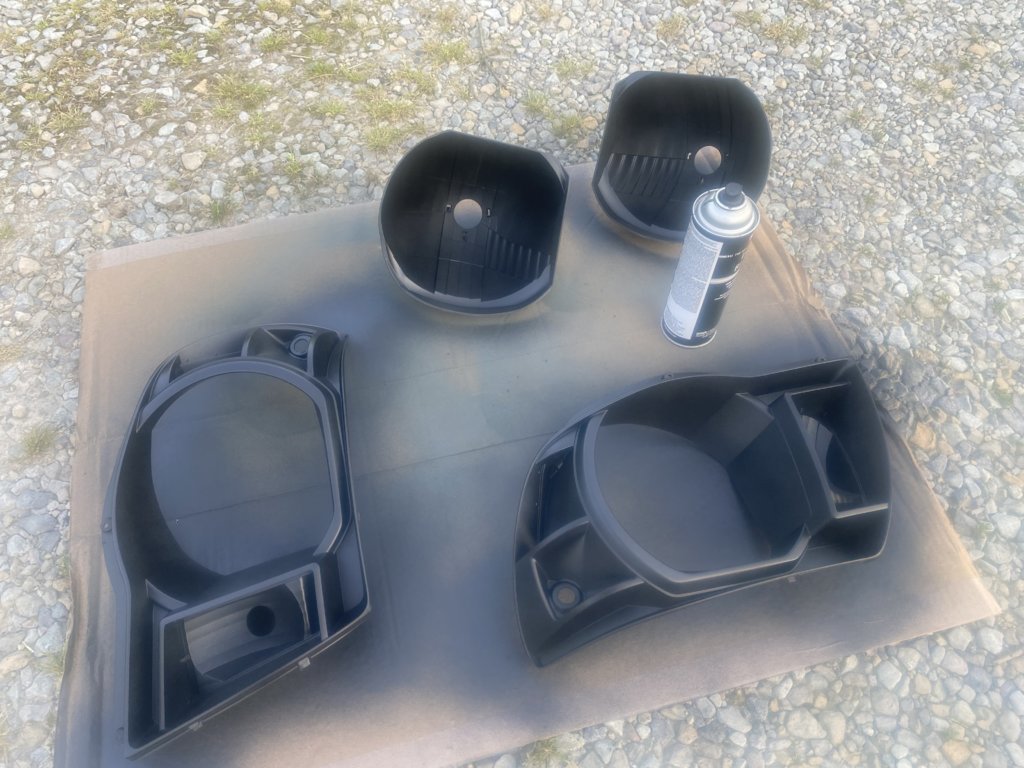

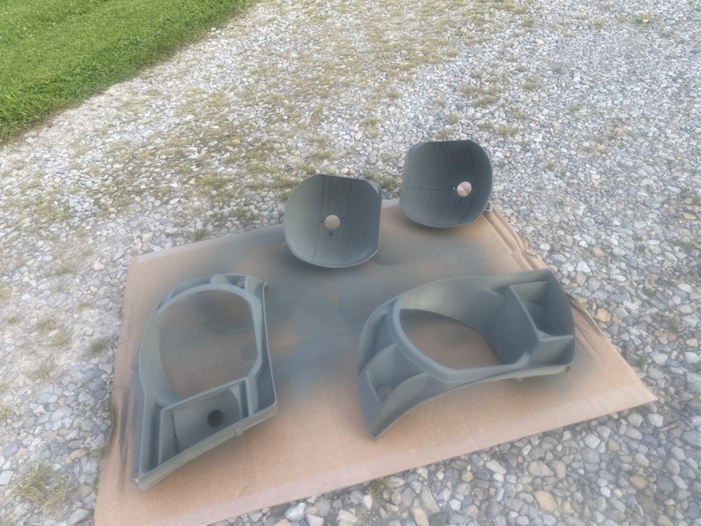

    Bezels and bowls are painted
    Ended up doing em in trim black.
    I’ll start reassembling them tomorrow

    Our experiences were identical.
    My girlfriend was definitely not in team Tacoma that day.

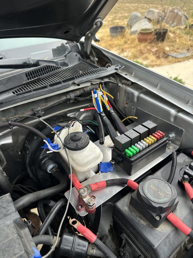

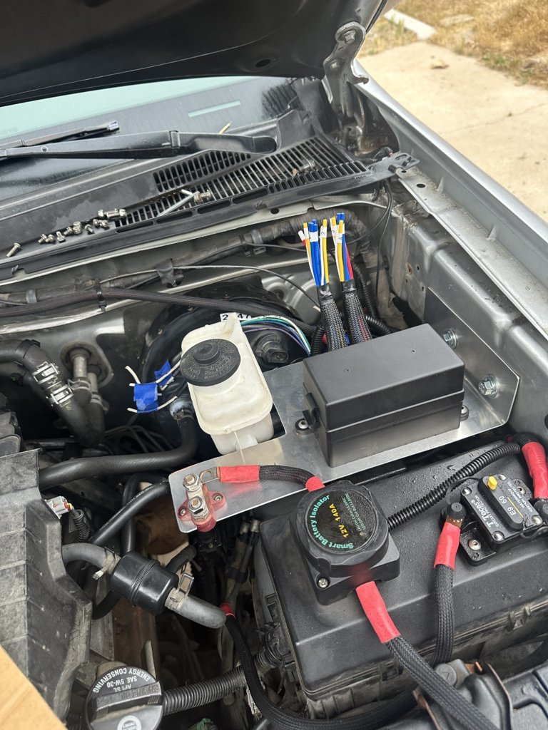

    Had to make a new fuse block mount for the new Tundra master cylinderIMG_9454.jpg IMG_9450.jpg

    That’s clean.

    i love your prewired pigtails!
