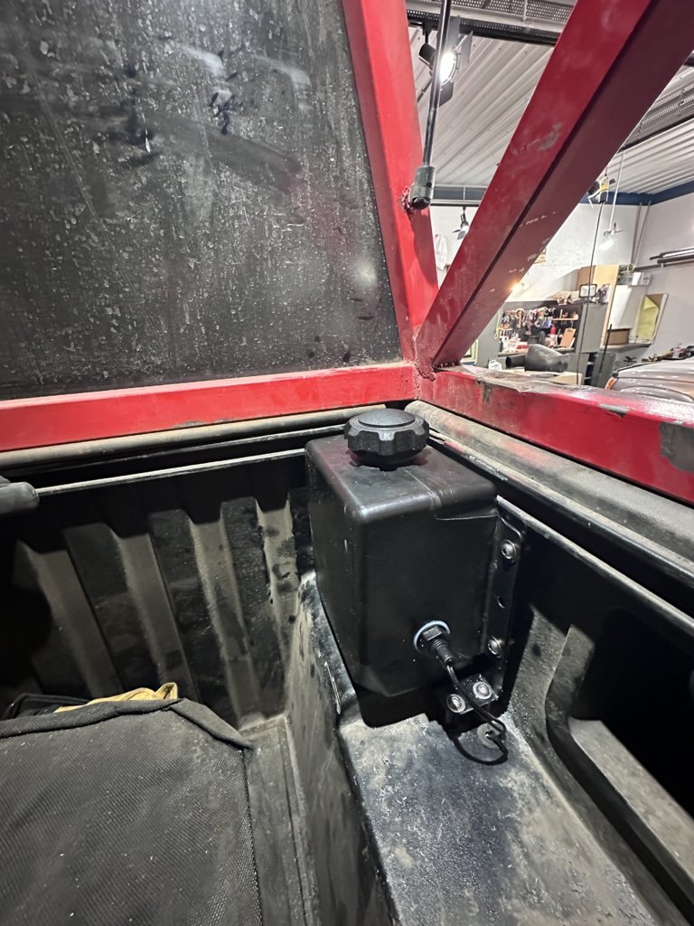

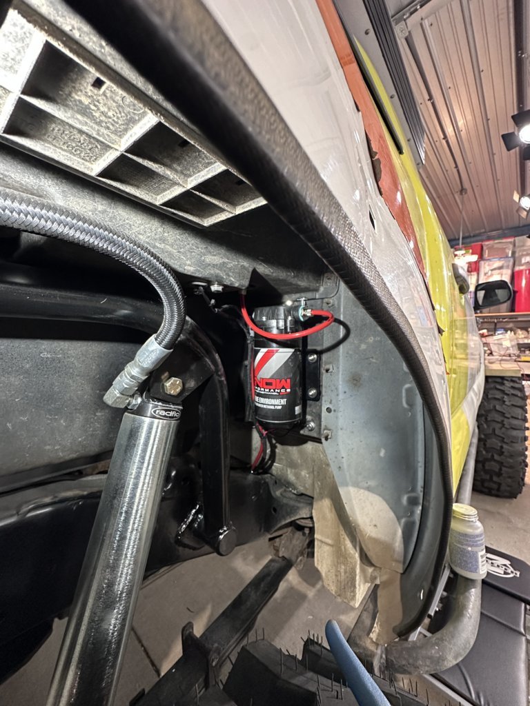

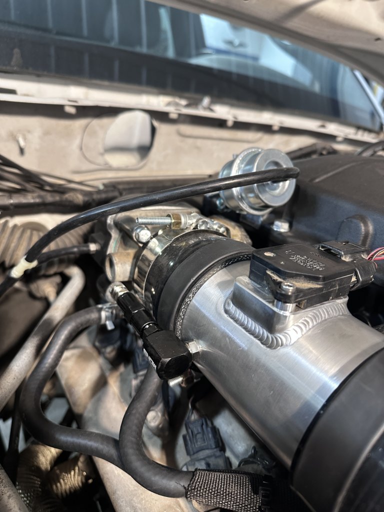

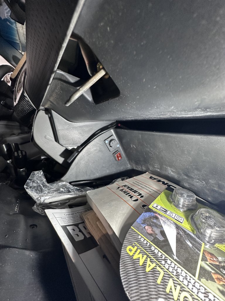

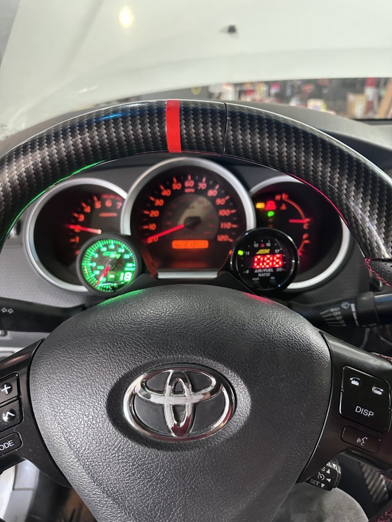

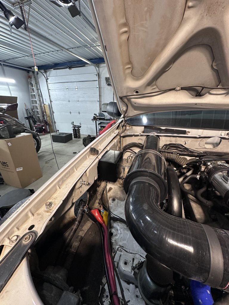

    Winch controls relocated. And water methanol kit, & gauges done.

    The water/methanol setup looks sick! You wouldn't happen to have a write up would ya?

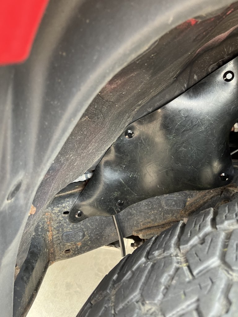

    AC drip line done with my new gear tech splash guards

    I thought the AC drip wasn’t an issue on 2nd gens, am I mistaken??

    The drain still immediately exits over the cross member in a second gen. It's a problem :)

    That was one of the first items I installed when I brought the SR5-DLT (Dad's Last Truck) home. Add a 24" length of 5/8" heater hose slipped over the end of the AC drain tube (I bought 3' to be sure I'd have enough.). Secure the end of the extension with a hose clamp, just tight enough so it won't slip, and route it downward to drip the AC condensate on the ground, rather than the frame rail where it runs back under the cab. The end of my hose was cut off even with the bottom left corner of the added aluminum skid plate so it drips behind the front end. :hattip:
