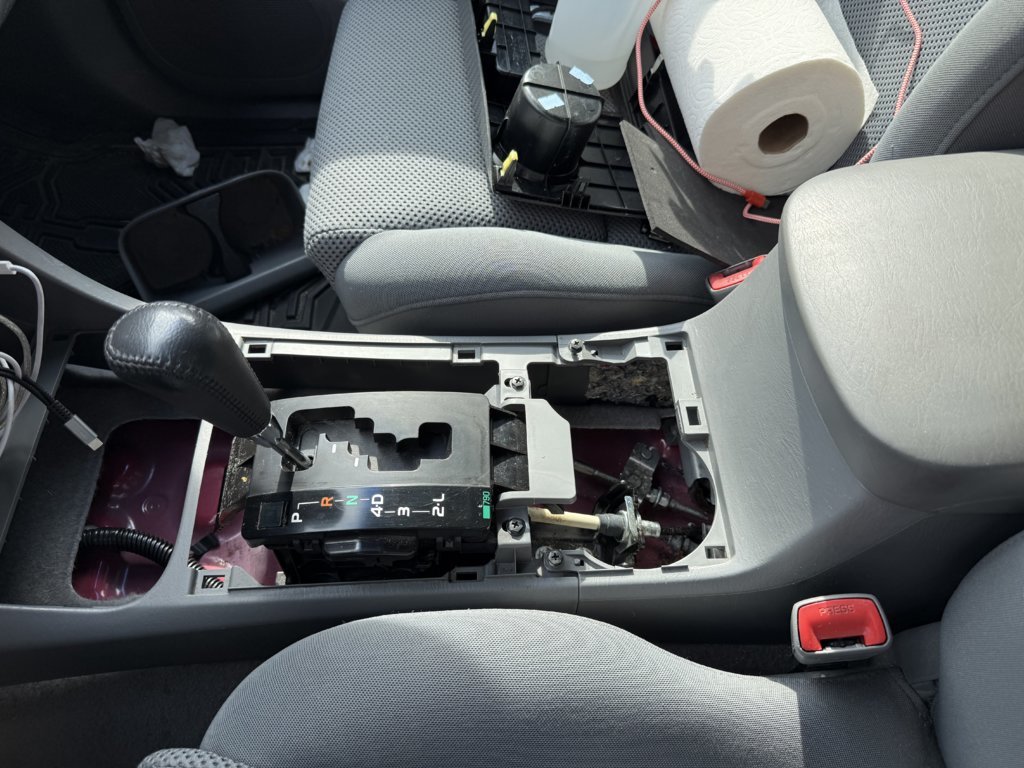

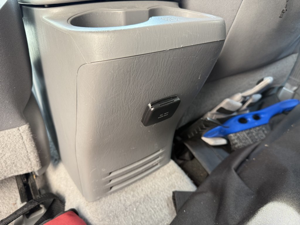

    Added the Guild Outfitters interior outlet upgrade.

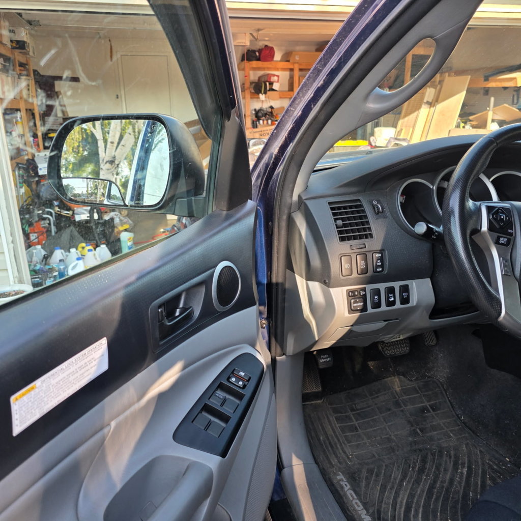

    Next up - Full auto window mod - 84820-0C030
    (you can buy an aftermarket tundra switch and just plug it in)

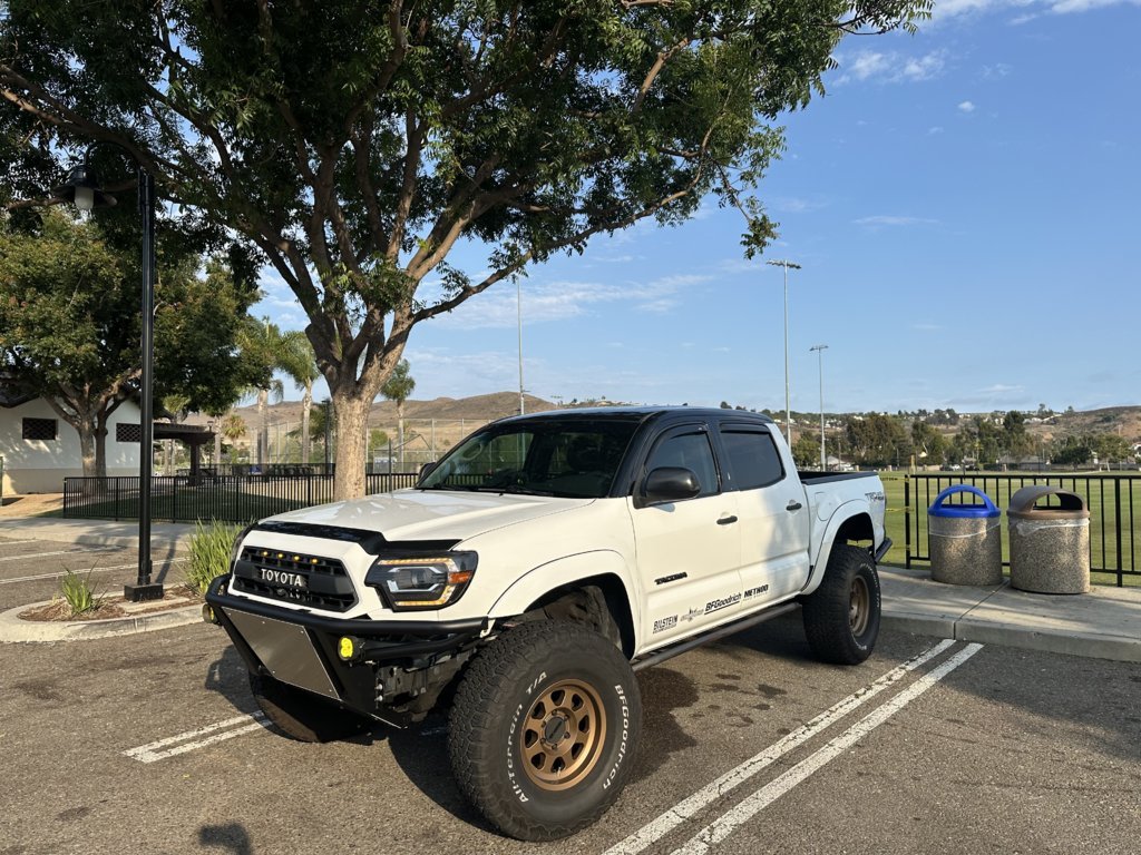

    Installed front and rear bumpers

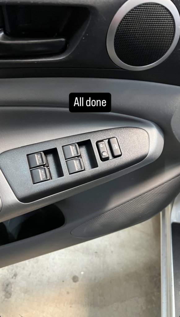

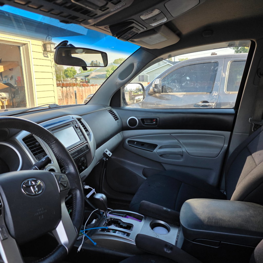

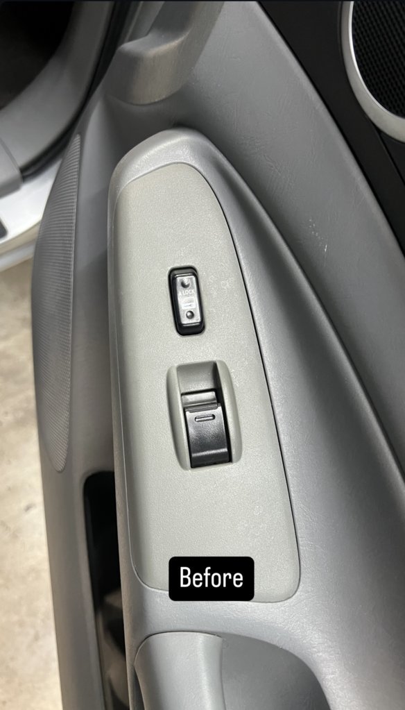

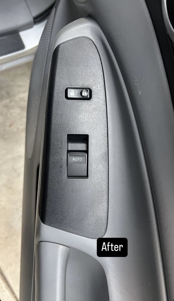

    Converted my window switches to the 12-15 so much better. Nice being able to have auto windows easy mod and worth it to me.

    Do you need to re-pin the connector for this mod or is it plug and play?

    I had to repin the drivers side connector. For the passenger side I had to make a whole extra harness for the lock switch so it would be plug and play. Passenger side also I had to re pin and just swap 2 wires. https://www.tacomaworld.com/threads/2005-2011-driver-window-switch-conversion-to-2012-2015.784858/ This is the thread I used its a bit complicated but once you read it a few times and makes sure to read the replies its actually pretty decently easy to understand.

    Mine was plug and play on my 2015. Didn't have a need do the passenger side.

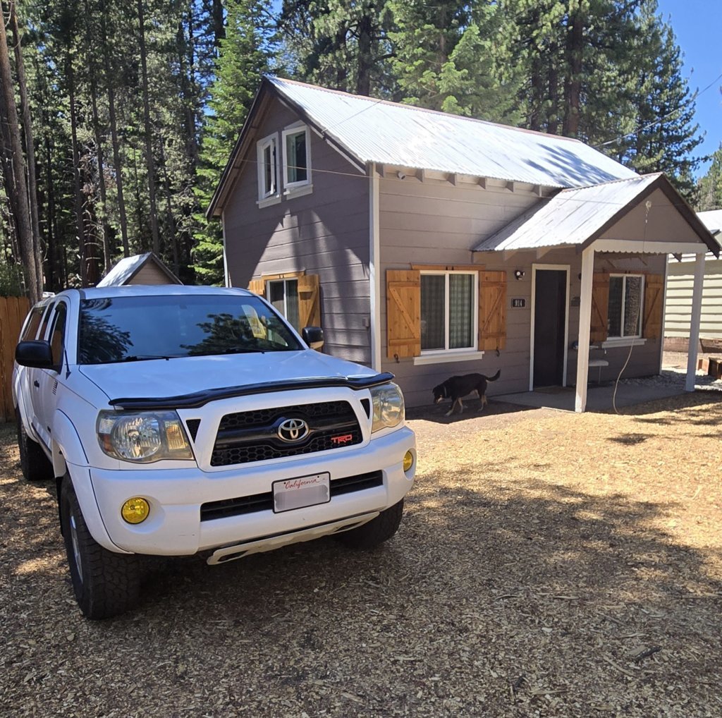

    Worked a chaotic 10hr shift, got off at midnight, and then me and the doggo took a long dark drive up to the family cabin in Tahoe for the next few days. Life is good.

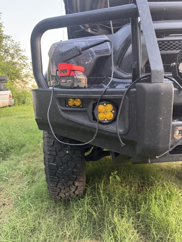

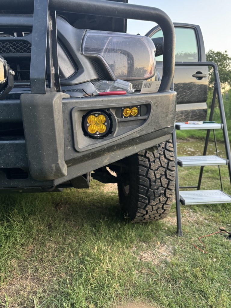

    More lights…
