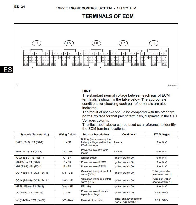

    Thanks! The cold air intake is the TRD one that came with the truck, so it is the "stock airbox"
    I am looking for thay scan tool that shows the airflow data.
