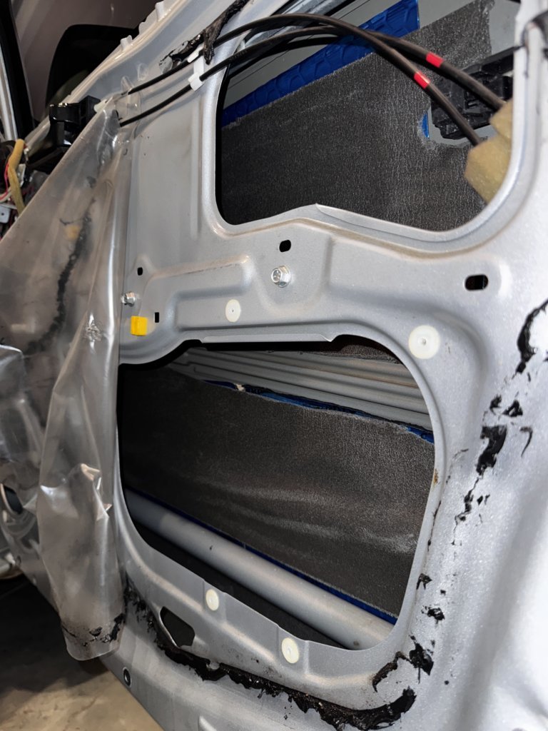

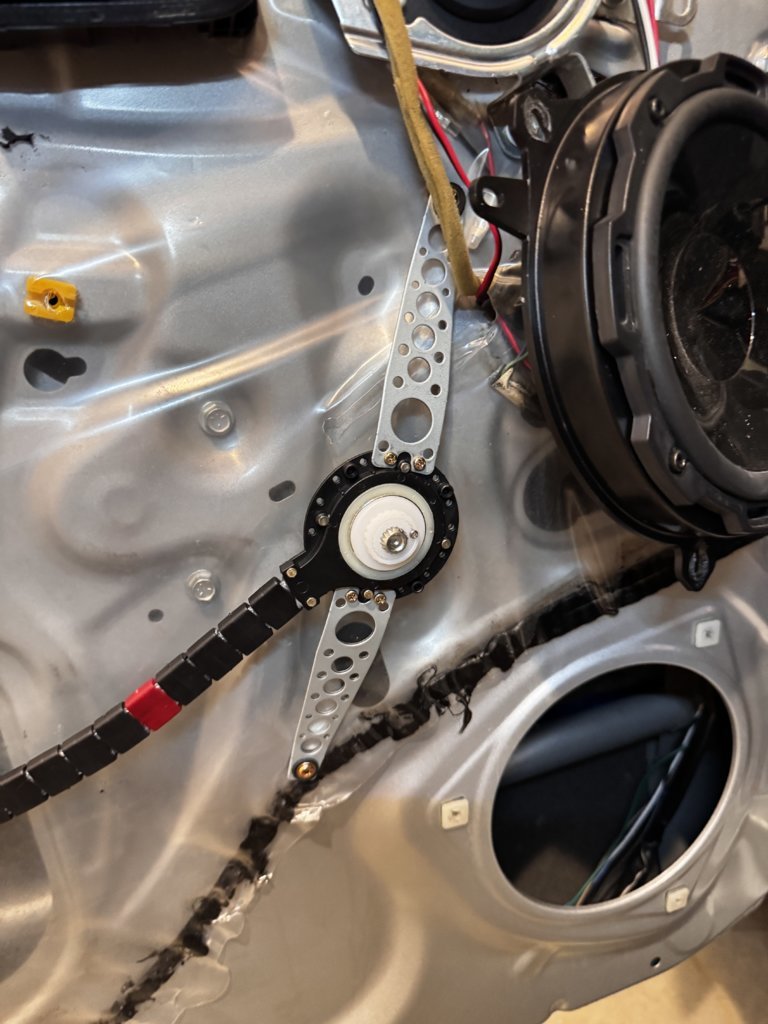

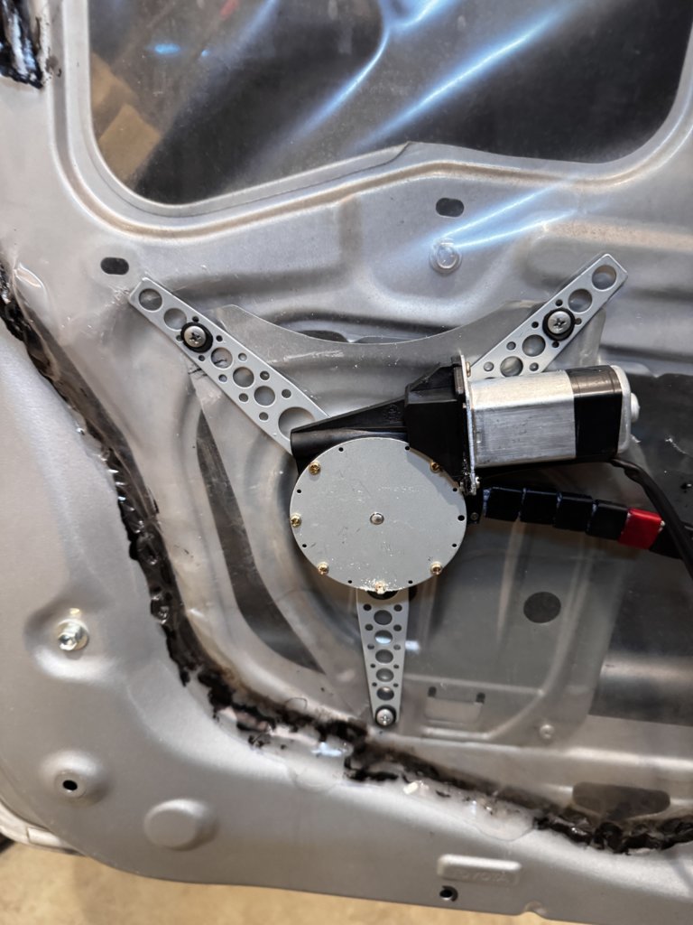

    Added sound deadening and foam to both inner doors! Also finally installed power windows into the base single cab. I was able to use the stock screw locations for the motor side of the assembly which was cool. Definitely a very tedious process, wouldn't say it's the hardest thing in the world to do though.
    Wiring is also in for powered locks, didn't get all the parts in time. I need a break from working inside the doors lol.
