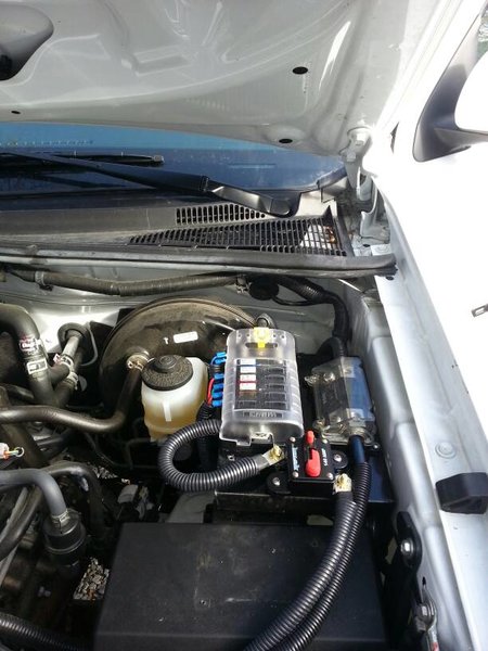

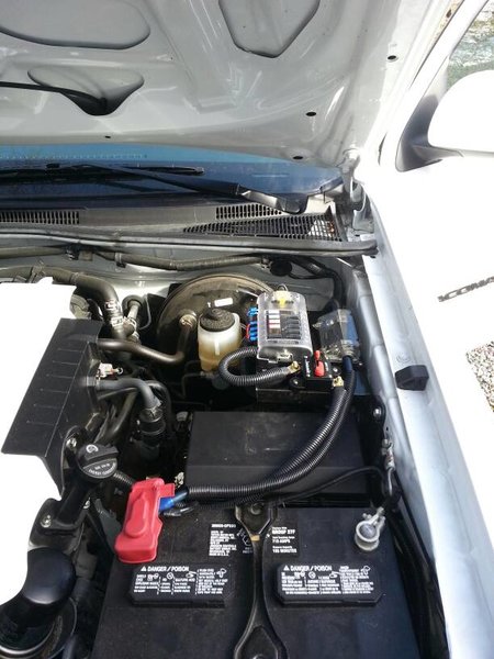

    Finished blue sea install..plate was a little small that I made but it all fit

    Looks good. Is the fuse for an amp?

    Yea for bass :cool:

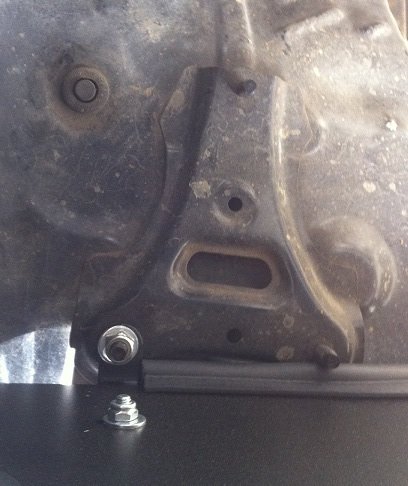

    I was able to reach under the plastic lip and use locknuts to secure the screws. It's a tight fit but it can be done and I have big hands.

    Cool. Got my plate made to bolt to the existing holes in the engine compartment. Just need to order the fuse block

    Thats where mines bolted...I just used a piece of aluminum I had laying around

    The main reason I did it that way was to make sure there was something more substantial than just the flimsy plastic to hold the mounts and light.
    I didn't want to go out and catch some brap air and have the fugger rip off ;):rolleyes:

    Its the perfect place

    Agree..almost like it was made for it

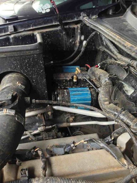

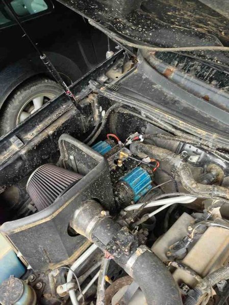

    I can post mine up in about 30 minutes. I got the dual and mounted it on the passenger fender. had to flatten it a bit and remove the bracket that for the TRD Sport is for a break pump or something for which the Offroad has built internally.

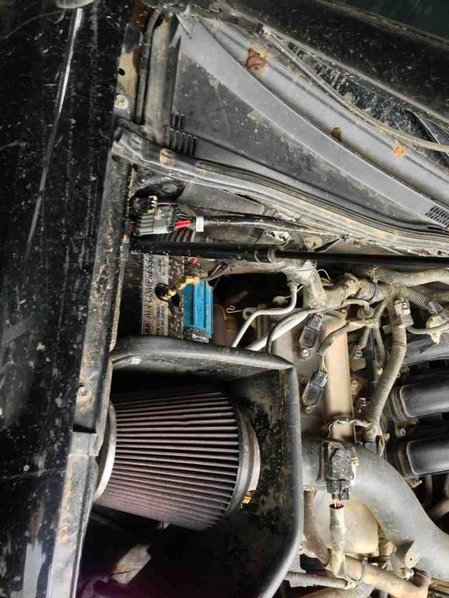

    Here is my ARB compressor. Little dirty, haven't been to the car wash since last wheeling trip. I routed an air line to a 5 gal tank that is mounted under my bed where my spare was then routed a line to an automotive and industrial air connection in one of the bed cubbies.
