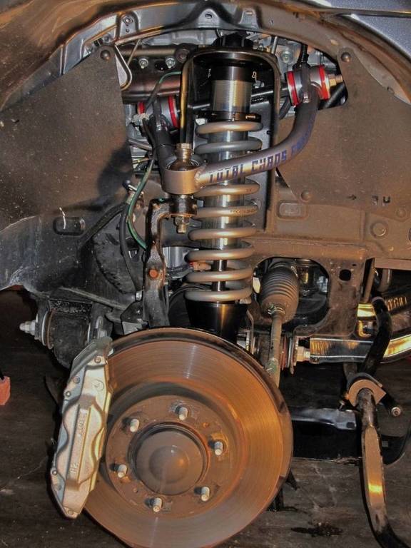

    Installed passenger side today. Working alone, 4 weeks out of back surgery, took me 3 hours for one side. Pretty happy with myself since I have never done this before.
    Fox extended travel 2.5 C/Os, with Total Chaos UCAs.

    Yep, its holding up :D
    I'm not straining myself in anyway. That's why its taking so long. No swinging hammers(besides a small brass hammer), or heavy lifting. I'm using 2 jaw pullers, various strap clamps to hold/move things where they need to be, and the jack to raise and lower things to help alignment. I only need the wife to hold a few of the bigger bolt heads while I torqued the nuts. According to TC, uniball nut gets 100 ft lbs... Not easy to do yourself even with a good back.
    Also, I cut the UCA pivot bolt head off. Seriously, it took less than a minute with a cordless reciprocating saw. Just watch out for what's behind the blade.

    I was using my husky 1/2" drive 27" long 250 ft lb torque wrench :eek:
    My back is still super weak. I still cant bend at the waist at all. I can't even put on my own pants yet...
    But I can install new UCAs and a coilover lift! :D

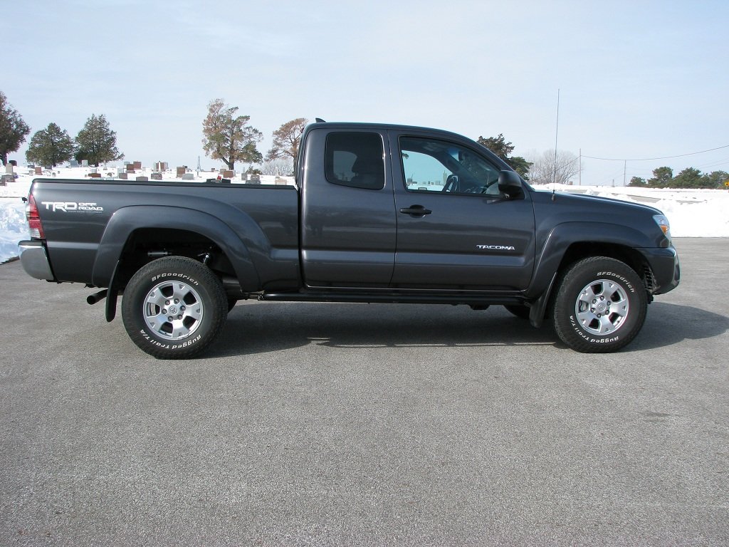

    Got my rear suspension on last night. Icon AAL with overload leaf left in, and 2.0 RR shocks. Gave it exactly 2" of lift and rides great. Decided to wait until next Saturday for the front. Besides, I like the rake. :)
