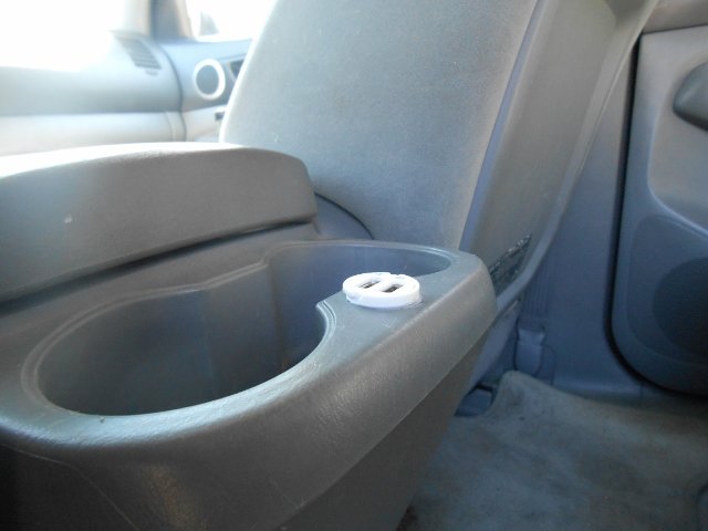

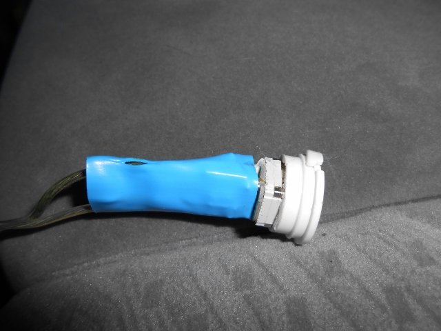

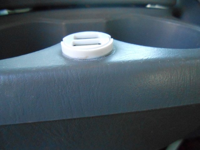

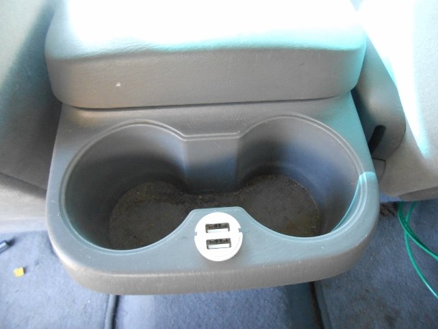

    Simple to do!:thumbsup:
    Took unit! Made by ( BYTECH) good for Tablets,GPS,Gaming Devices,mp3 players, mobile phones - 2.1 amp output!
    Cut just above metal grounding tabs, split unit soldered wire to pos and neg.
    Shrink rapped it.
    Drilled hole in console @ this location.
    Glued unit in place!
    Ran wires to fuse box found power only when on,tapped into, installed a 1 amp inline fuse, the ground wire, I grounded!
    Good to go!!:eek:hyeah:

    Thanks. Have you plugged anything into it yet? That 1 amp fuse should blow if you hook up a 2 amp device, like my smart phone (Moto Electrify), or two 1amp devices. Might bump that up higher, probably 3 amp.

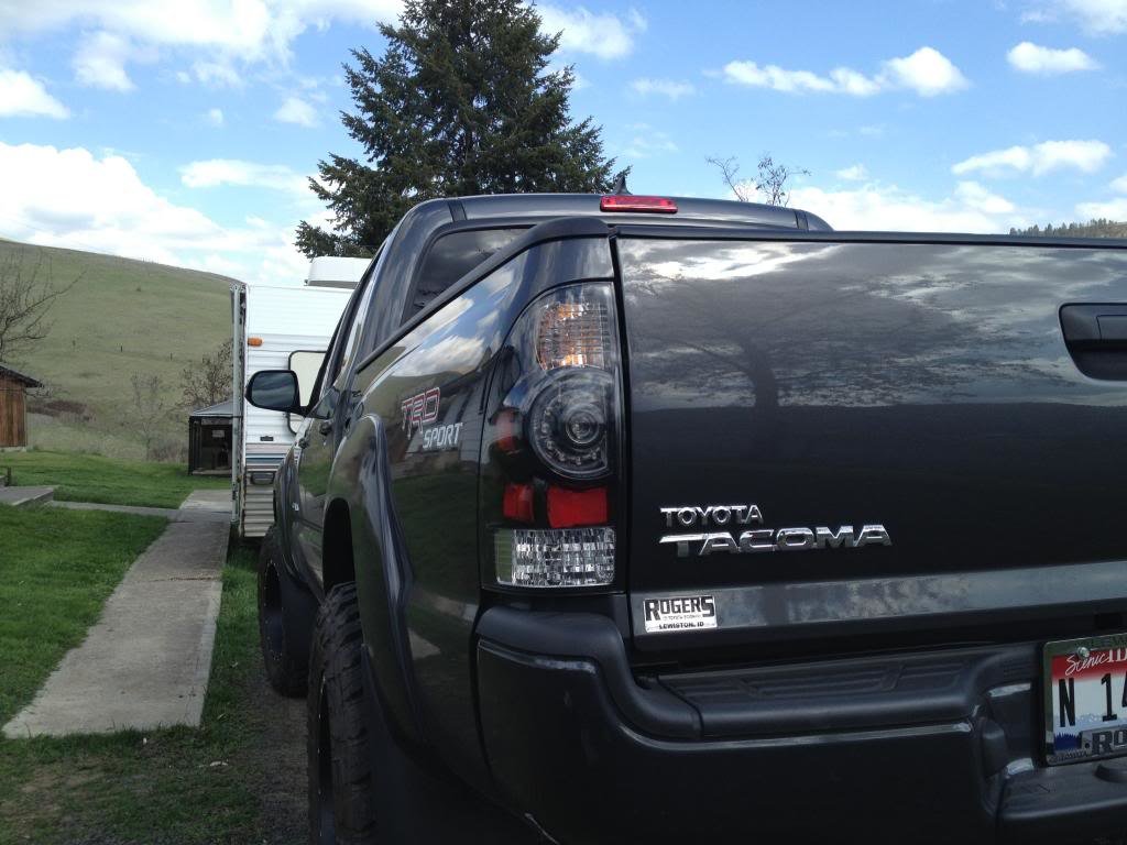

    Painted the Toyota emblem black

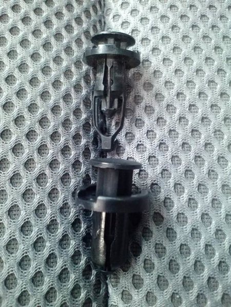

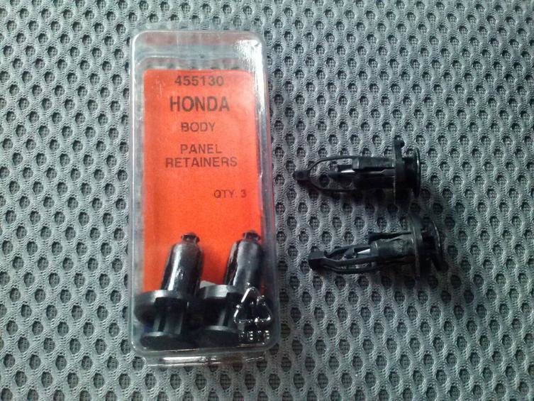

    put some Honda parts on it :D
    but in all seriousness I found some plastic clips that are PERFECT replacements for the ones all over the front of the truck, maybe even better than the stock ones. they're a little larger and fit more snugly.
    Advance Auto Parts, I think they're $3 something a box with 3 in each box. took me 3 packs to replace all the ones falling apart on my 06, but I still have a couple spares too ;)

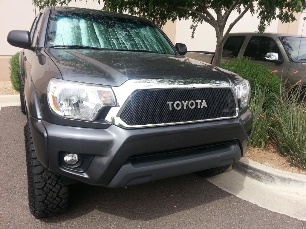

    TOYOTA emblem custom cut from 1/8" brushed aluminum on grill. A is looking a little cocked. Need to polish & buff it tonight. Deciding if I like the look & want to keep it.
  17. Apr 4, 2013 at 4:43 PM
    PcBuilder14
    PcBuilder14 Well-Known Member
    Jun 19, 2011
    #58522
    23,312
    Brent
    Nor Cal
    2018 Tacoma TRD Off Road 4x4
    :eek: That looks really nice! Definitely keep it!
