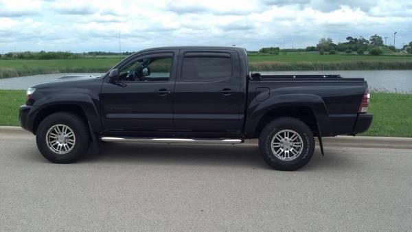

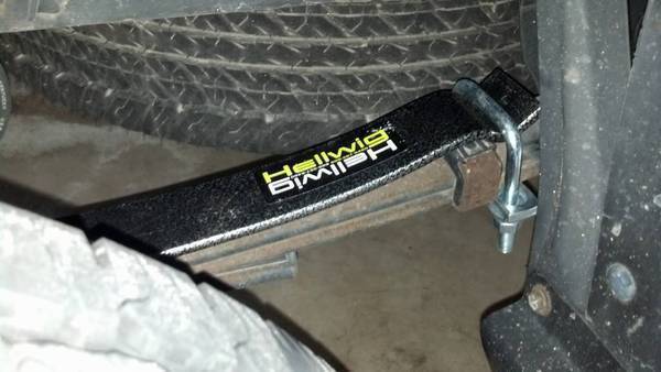

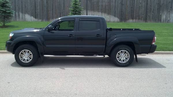

    Installed Hellwig 550s helper springs today. Have the 3 leaf pack. Second picture is unloaded. Third picture is with 1100# of river rock (22 bags @ 50#) Drove much better loaded and the squat was not bad at all. Never hit bump stops loaded. I had 800# of river rock in there yesterday and hit bump stops on the way home. Pretty happy with these.

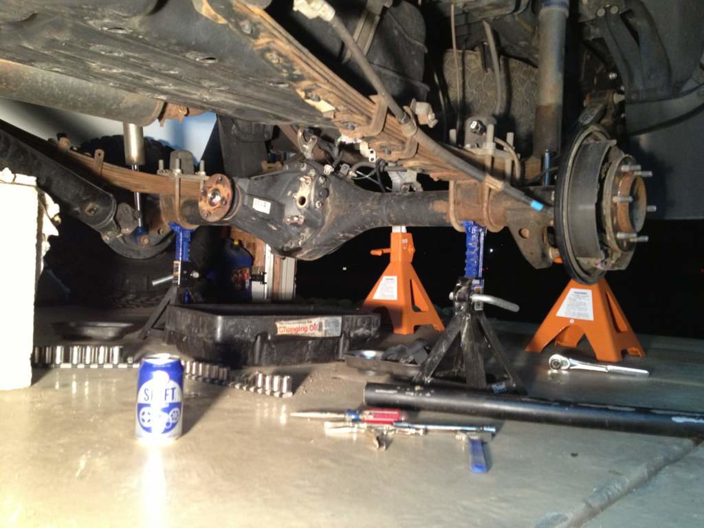

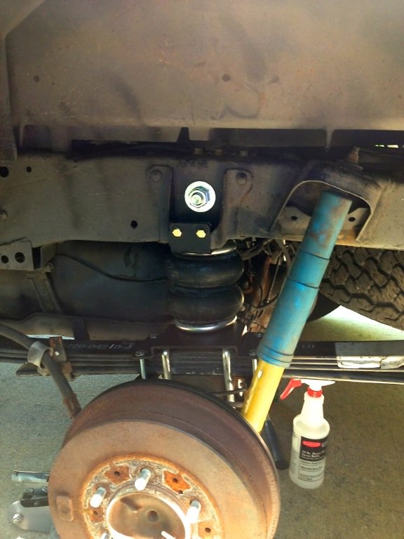

    Thinking of adding a second battery...
    Got tired of the weak ass motherfrikingsheeti rear suspension....

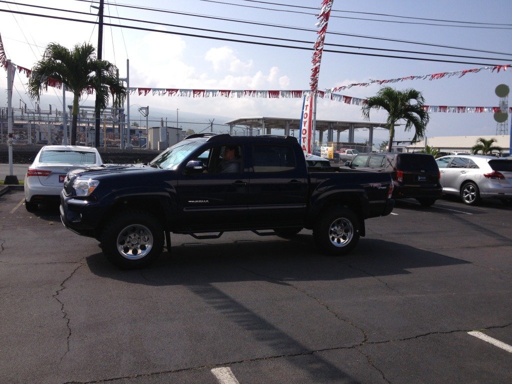

    Finished my build...took delivery

    LOL the build is NEVER over!
    I love the built so far ;) does the s/c make it comparable to a hemi ram?

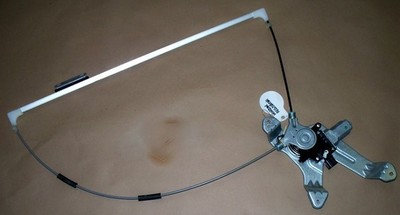

    Sorry for the late reply guys.
    I wish I could do a write up, but this thing was pretty much a trial and error for me. So I never really document each step that I did. I could give a few detail as to what I did, what materials I used, hopefully that'll help anyone that's gonna tackle this mod. It'll be all up to you on how you mount the motor, how you fab the bracket for the window etc.
    Here's a list of the parts that I use.
    Honda Ridgeline rear glass regulator. It's a lot cheaper to buy it from a honda parts web site than eBay. Got mines 62.93$ shipped.
    Switch- got mines from eBay. There's so much options out there. Your decision on what switch you wanna use.
    Bicycle break cable, and cable housing. Got mines from a local bike shop.
    Then you need wires. Got mines from RadioShack.
    Estimate of cost probably less than 130$ give or take what materials you already have laying around.
    The hardest part of this thing is that you need to fab your own bracket that'll clamp on to the rear glass. Second hardest part is finding a way for the cables to hook on to the bracket. That's why it's was a bi*** and a PITA to get this thing done.
    Regulator
    c4c159fd32c5d3a55cfe2072b47eb4f9_zps961b_ea48f488ac0c5f6a9fe4c9546053daf7d327f675.jpg

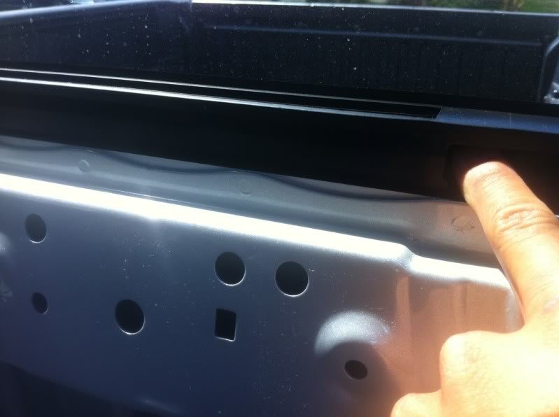

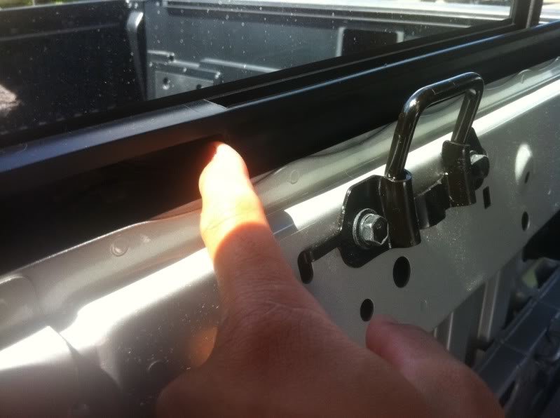

    This is where I ran the cable on both the passenger and driver side. There's like this open gap, drill a hole and ran the cable. 7D1526DD-E09C-4D74-A112-FD0276C0FADB-538_0e28ec50db7439b06038464c0f008a7eaf8e8cf6.jpg38CE9B99-C9A0-4BC7-9325-5439568C8D4F-538_59ed6642cb08eaaa7a276745a9d447fbcd4e15a4.jpg

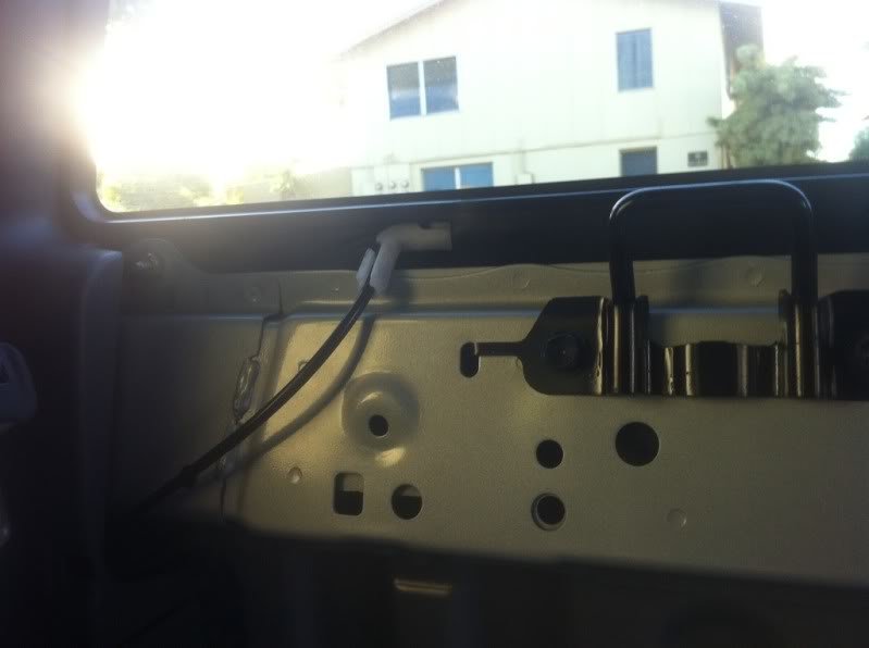

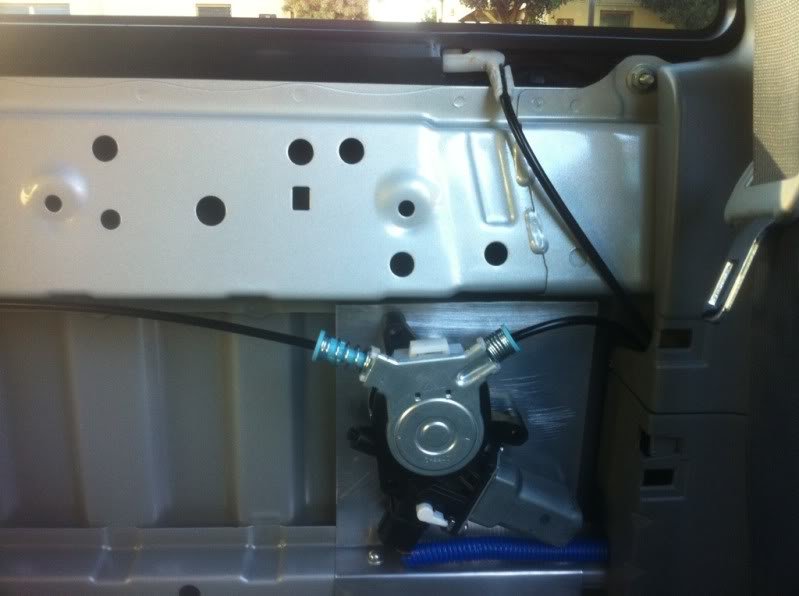

    Mounted the motor on a piece of aluminum plate, drilled 2 small holes, and use the smallest nut and bolt I got lying around. See that white piece that's tuck into that gap. That's the original piece from the regulator that I ended up shaving down to run the cable through the channel.
    A1BDE788-3021-428C-BD83-6761A1500B80-538_90fb1fcacaa758fe834bd2c38fb9eac37a1c10b8.jpg
    ECB432C2-9249-4B2F-A1B2-586832162CD1-538_a6a3d789e32362689097fba64815d2b35d8fa118.jpg
    It's not as detailed as it should be, that's why I don't want to do a write up on this thing. But you'll have an idea on how everything goes. I'm pretty sure anyone can do this, if they have the proper equipments and tools. Anyone can tweak some of the stuff, if it's easier to do it this way and that way blah blah.
    Please let me know if I miss anything, or if you guys got any question(s). I'll try to give you the best answer. Bad news is that I'll be gone for 23 days, another annual training for the Army Reserve hahaha
