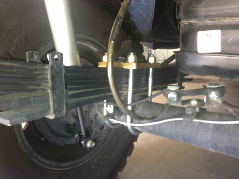

    Ubolt flip complete. Just waiting on my Wheeler superbumps to show up and off come the stockers.

    Is that the AP Flip Kit? And if so, will you have to modify anything to fit the Wheeler's? I know that AP sells the kit with Timbrens, but I wasn't sure if there was a huge difference in perforcmance, etc with the Timbrens vs Wheelers.

    It is the AP kit. I will have to drill out the wheelers lower plate to pick up the holes drilled and tapped on the flip plate to attach them. Easy enough. Whether you get the timbrens or wheelers is a personal choice. From what I've read timbrens if you tow stuff and wheelers for offroading. That is what I've gathered on all the posts I've read. Doesn't mean it's right but that's what I'm going with.

    How do the bumps actually attach? If you drill, how would you thread anything on? I see from the Wheeler's pictures that there is a hole in the middle of the bracket, but I don't understand how the bracket then attaches to the flip kit plate.

    The plates come drilled and tapped.
    You just need to match drill the wheeler plate to the holes on the AP plates. You do need to specify the extra holes when ordering from AP. it's an option when ordering.

    Ah, I see, you have to drill out 2 holes on the little "U" looking bracket on the wheelers, then bolt the bracket onto the flip kit plate.
    Thanks for the help, I've just never seen a good picture of the AP plate. I will be sure to mention the extra hole option when ordering.

    yup each side. it took me two hours because i was being a sloiw ass and having a problem getting it behind my qa1 shock. They are kinda fat on the bottom. But its super simple supposed to be a 45 min install.

    super good, feels like i have nothing in the back of my truck. But im lowered and it brought me up an inch when on the tightest setting. So im still playing with it..
