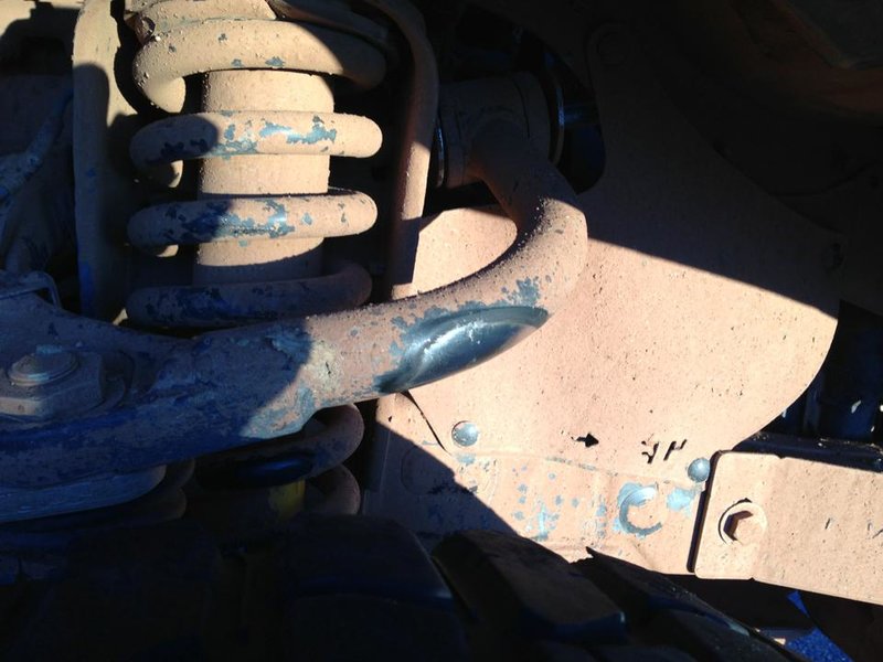

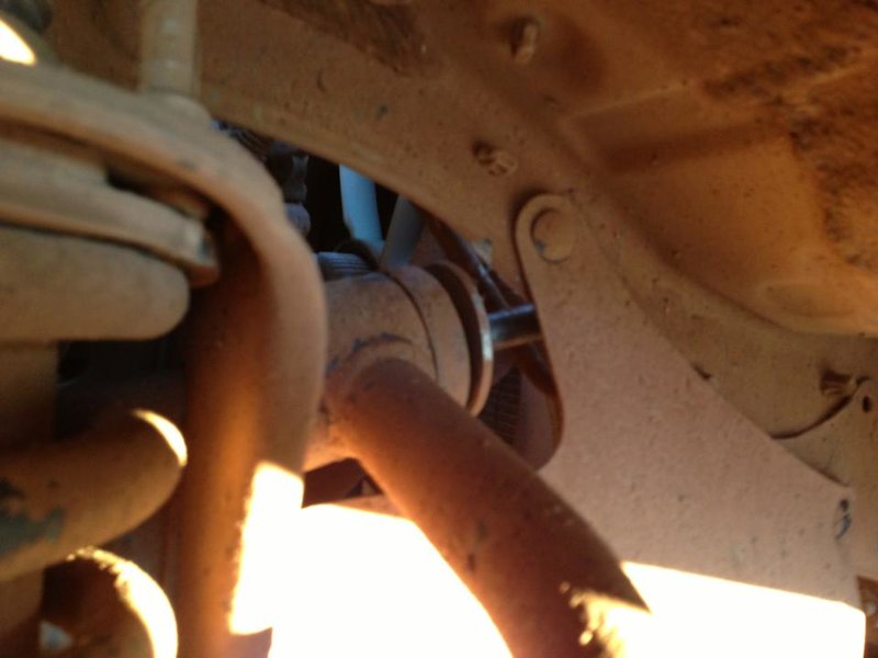

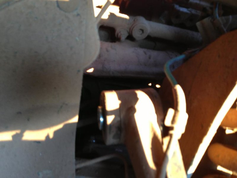

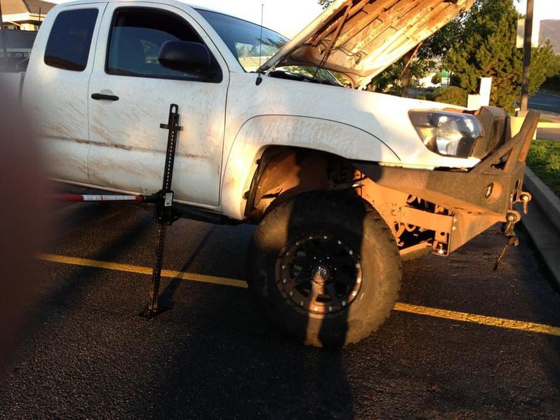

    drove it 1 mile down the road before the upper control arm declared shenanigans...

    Nut fall off? Arm break?!

    Looks like the nuts fell off and the bolt started riding up. Gotta make sure you go back after a couple hundred miles and retorque that stuff.

    yeah, thats exactly what happened. im usually really good about re torquing bolts, just kind of forgot about it lately...

    See about a free alignment check (tire places here do it) to make sure the UCA wasn't tweaked?
