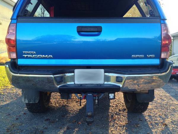

    Great idea on tapping into the trailer wiring. Do you remember which wire it was? (Might have to steal this idea!)

    Have someone put a multimeter on a wire and have someone put your vehicle in reverse till you find the one that puts out 12v.

    The middle wire is Aux/Reverse, #1 pin is ground (bottom-left looking from the back of the plug/under the truck, or bottom-right looking from behind the truck). I could've used chassis ground but the wire was right there so I used it. Also one less hole drilled into the truck, and one less potentially flaky connection.
    IIRC, they colors were white (ground) and a yellow with silver trace but double-check. Use a little screwdriver to unlock the clips and pop the elbow off of the back of the trailer plug - it'll all be right there for you to see.
    Remember - don't use any crappy wire taps under there - strip and solder because it's such a nasty environment. Seal it all back up as good as you can. After taping/shrink wrapping the wires, stuff all of the wires back into the wiring loom and give it a few good layers of tape to hold it all together.
    Have fun! :cool:

    Or one of two easier things than that - look at the pinout on the flap over the plug (my stock flap has it...) or google '7-way trailer plug images'. :D

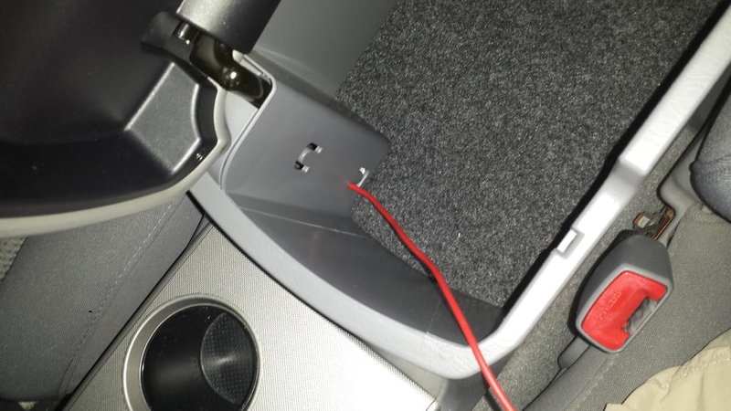

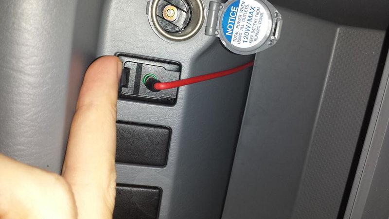

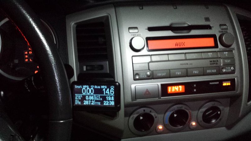

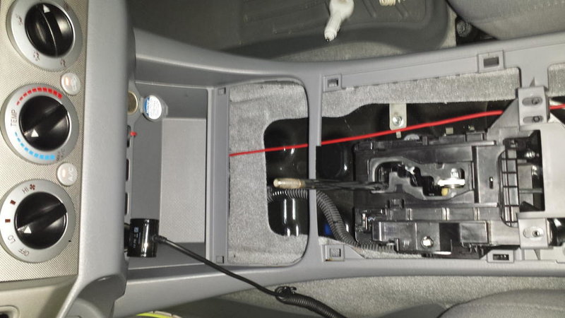

    Mounted my Ultra gauge with velcro to top left of windshield. Came out this morning to it hanging by the pillar molding. So re mounted it next to steering wheel. Then routed Monster headphones cable from Aux jack under console and up through holes in center console to iPhone. WAY better than having wires all over cab.

    Just a question, why didn't you just undo the AUX cable connector from the pod? You wouldn't need to even see it.
