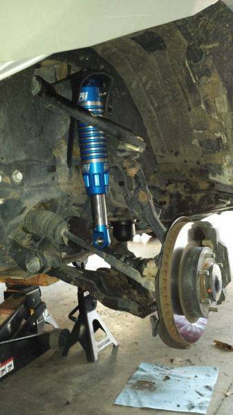

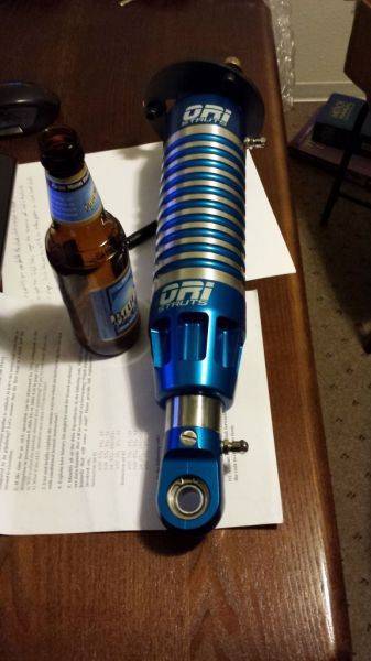

    tell us more about these struts.... I don't know about anyone else but this is the first time I've seen something like this for a tacoma application. any video of it in action on your truck?

    I don't have any vids of them in action. BAMF is selling them for 2nd gens right now. I think he is working on a 1st gen kit.
    You fill them with nitrogen to hold the rig up, so they are very tunable and you don't have the preload that you get when cranking up the collars on coilovers. The shaft is huge! but they take up less space because the body is smaller than the coil spring on a C/O.
    They one thing I love about them right now is I have a lot less body roll than I did with my 886 coils on 5100's. It held practically level when I tore through some corners testing them out. I am still breaking them in as well as feeling them out before I officially review them, but so far they seem superior to C/O's.
    You can kind of see here that I actually have one tire drooped and one tire stuffed while on close to level ground, which was next to impossible for me to do with C/O's.

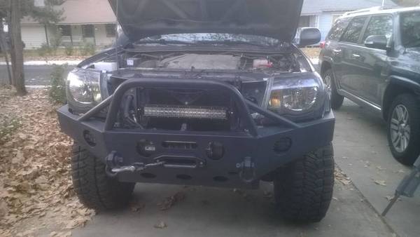

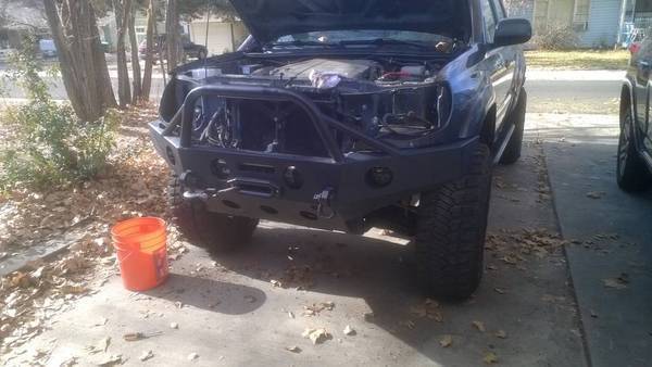

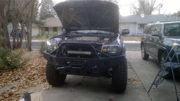

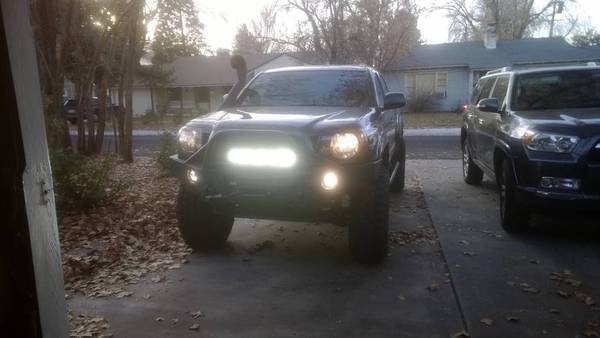

    Over the holiday weekend I relocated my horns (only moved one and removed the other) relocated the temp sensor, installed BAMF light holder, finished and installed my OEM headlights with BHLM completed, and installed light bar.
