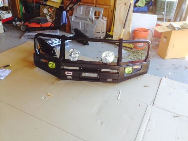

    Ye thanks haha... Got a bumper?
  6. Dec 9, 2013 at 6:59 PM
    kai38`
    kai38` Well-Known Member
    Dec 9, 2007
    #3778
    804
    No its still sitting in my garage.

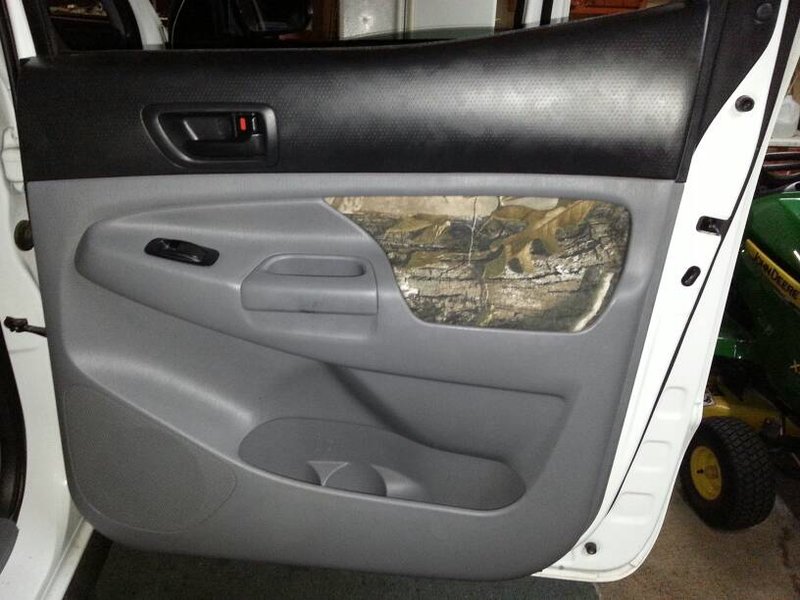

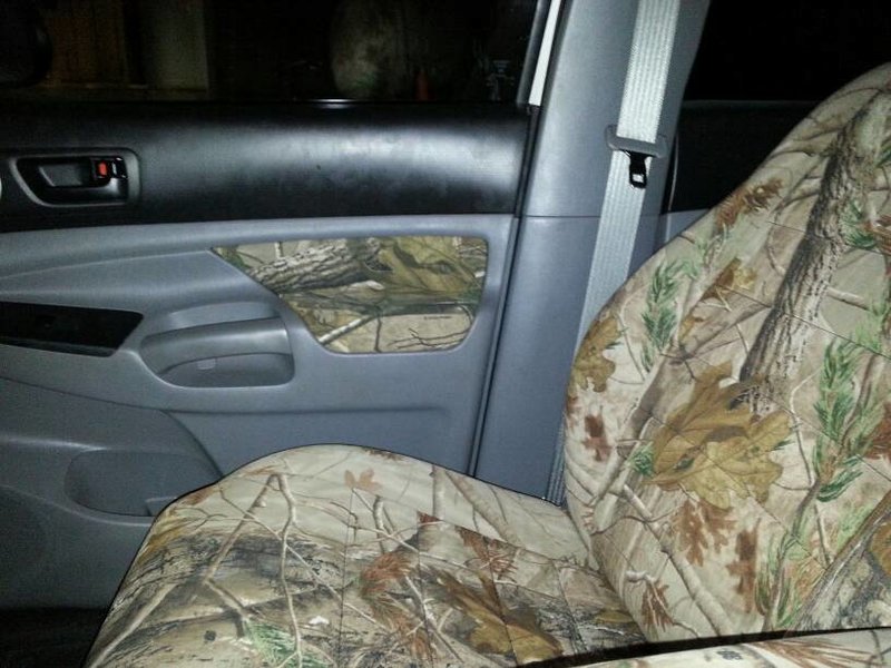

    Wrapped my armrest to match seat covers

    Where did your arm rests go??? :D

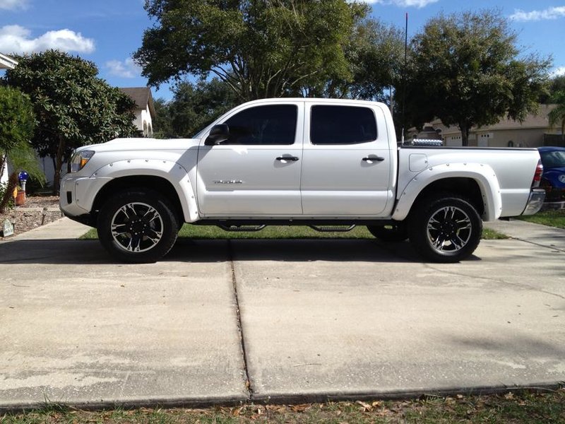

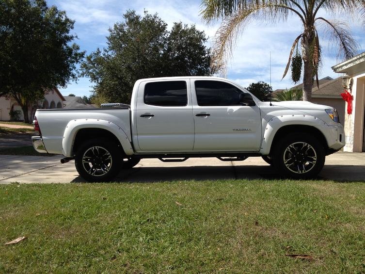

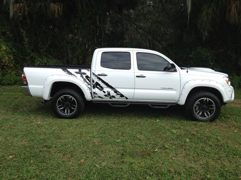

    Not all today but within the past couple days.
    Removed the XSP-X decals from the truck as I grew to hate them in the 3 weeks I've owned the truck. Used a heat gun on low setting to warm things up and they peeled of pretty easily. Took me about an hour or so and cleaned up real nice with some Goo-B-Gone. Wash and wax and you can't even tell they were ever there.
    Before:
    After:

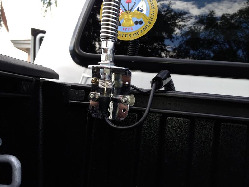

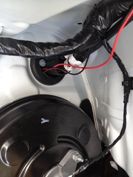

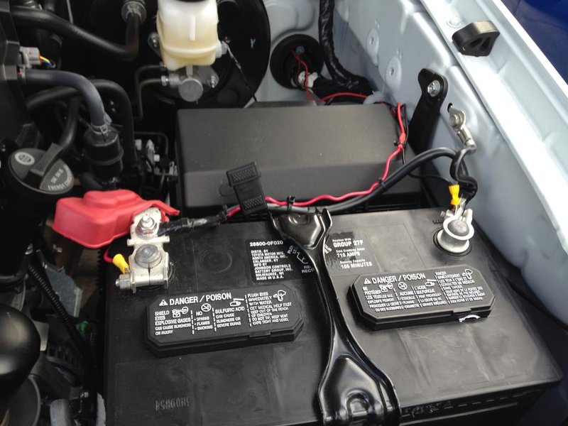

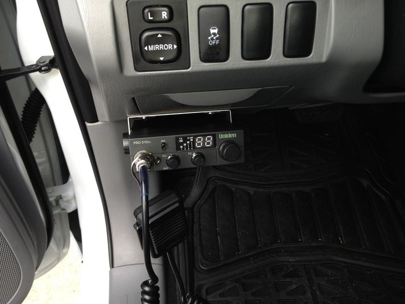

    Installed CB Radio:
    Ran power and ground right to the battery. Used an in-line fuse as you can see in the picture.
    Fed wires through rubber grommet in firwall with a coat hanger.
    4' Firstick mounted on bed rail.
    Uniden 510XL under fuse box door.

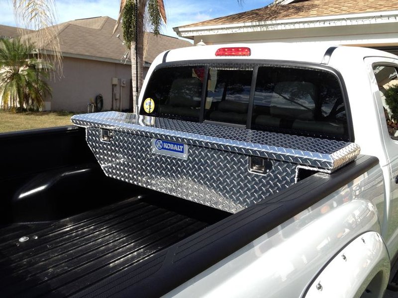

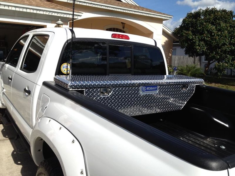

    Installed Kobalt Toolbox. Had to keep it four inches from front of bed to clear CB antenna. May move the antenna to end of bed. We'll see.
