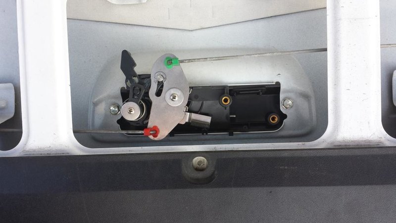

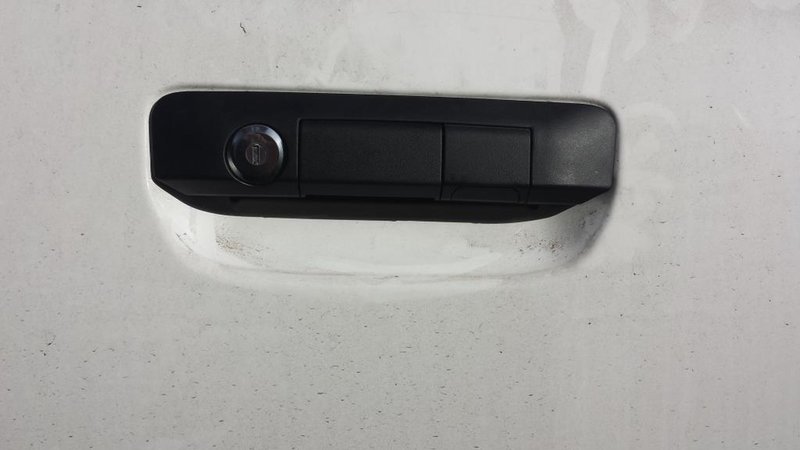

    Installed the new Pop-N-Lock with the "Bolt" type lock.
    Tailgate now locks and unlocks with the ignition key...

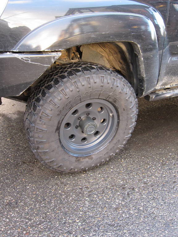

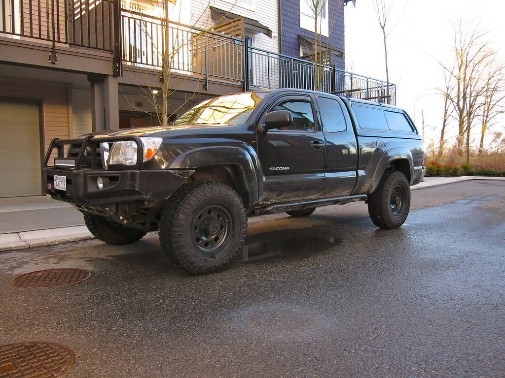

    From a few days ago. New wheels and tires

    Can this be installed with the back up camera?

    Sweet! How do you like it? Did you have the PL5300 in it before?

    Im pretty sure thats what the plastic piece and two bolt holes are for.

    Yup.
    Pop out the insert between the two holes and the camera mount attaches using them (10mm threaded inserts).

    Ya, had the 5300.
    It was nice and secure, but felt cheap.
    The PL itself was solid alloy, but the lock simply raised a block that prevented the stock handle (plastic) from being lifted. It always felt like it would break if you applied too much pressure.
    This one, like the factory handle, is plastic, but the way the latch is designed, attempting to lift the latch when it is locked does not put any stress on any parts... plastic or metal. It's like the factory door handle... it just lifts but doesn't open, and no amount of pulling will break through the latch.
    Key rotation is about 1/8th of a turn, similar to the door locks. Rotate the key one way to lock, then back to vertical, other way to unlock, then back to vertical.
    The PL5300 was vertical to lock, horizontal to unlock.

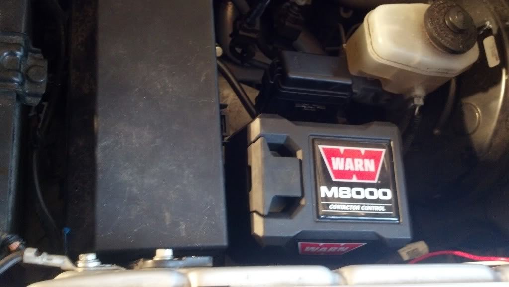

    I installed my M8000 and relocated the solenoid:

    Nice work!
