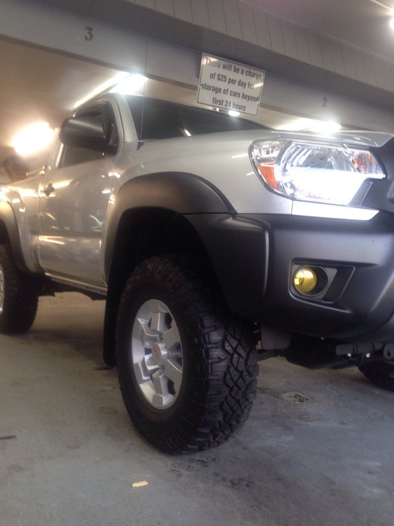

    Sir, I think it has a lot to do with me being a Prerunner. I have Maxtrac 4'' Spindle lift + 5100's @ 1.75''. Will post pictures later!

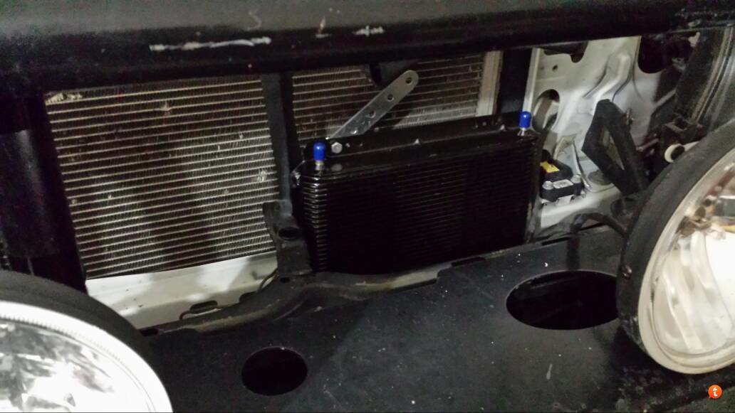

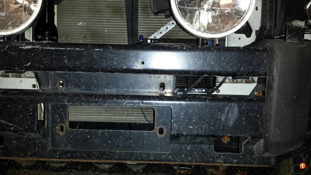

    Diff oils and transfer case oil changed. Transmission cooler mounted!

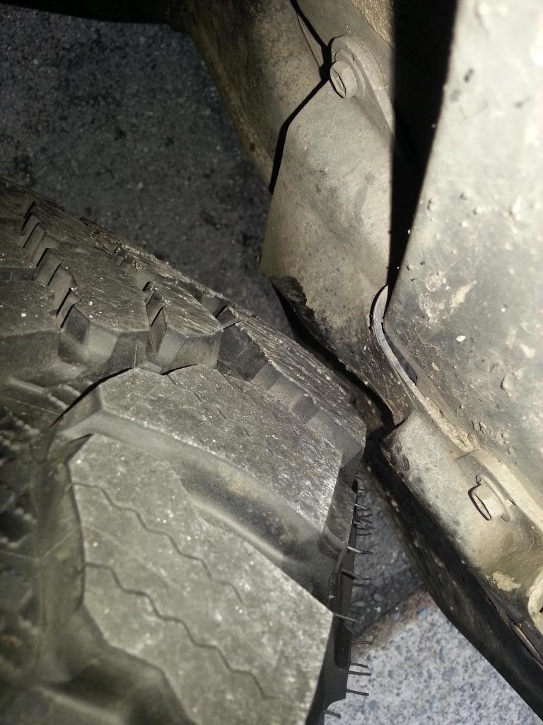

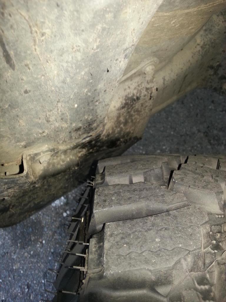

    Thanks! Here is the only rub I have, it is very minor and at driver/passenger lock.
    DRIVER
    PASSENGER

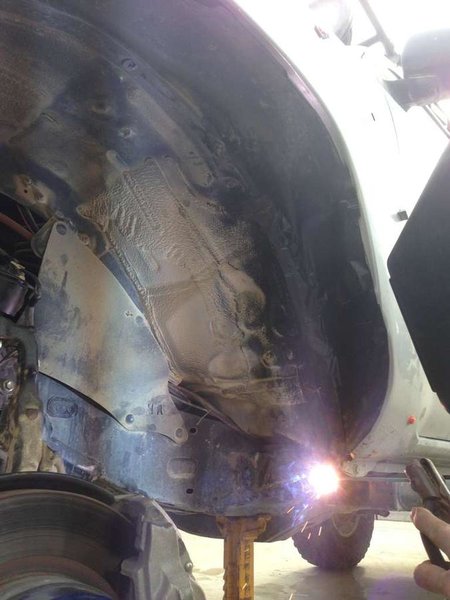

    Smashed ALL the pinch welds totally flat & welded my BAMF cab chop plates. Smash cut weld paint repeat. Now my 285/75's clear at full lock on the entire suspension cycle- even took the coilovers off to push wheels up to bump stops & turn wheel.
    Hint- If you actually truly want to clear 285's there is ALOT more cutting you need to do in the wheel well than this forum will lead you to believe.
    But most won't ever really stuff the wheels up so cut as needed I say.

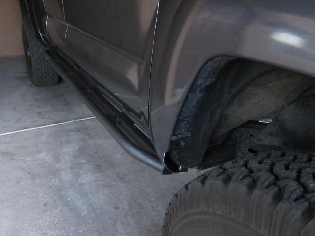

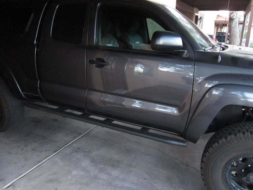

    Installed Demello Offroad bolt-on hybrid sliders. Turns out drilling 9/16" holes in the underside of the frame is kinda challenging when the truck is on the ground.

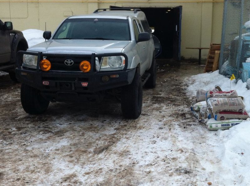

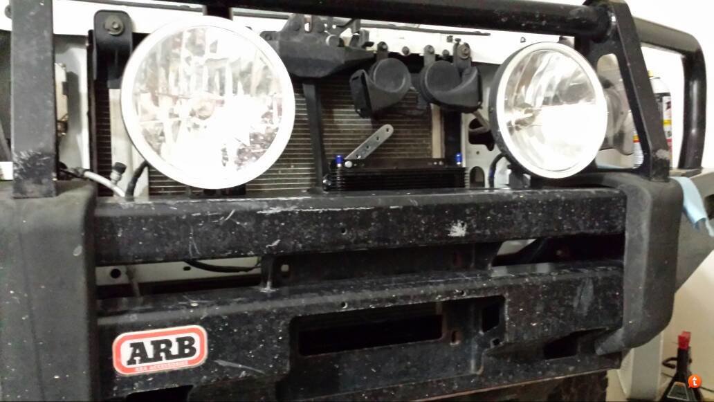

    Sliders look nice! I agree, it is a PITA to drill those underside bolts. I only ended up with the patience to do one (the stepwise drilling and oiling is time consuming), and am thinking of maybe having a friend weld the support brackets to the frame for added sturdiness instead of finishing the holes.
