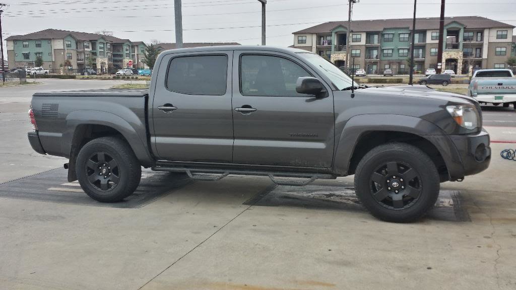

    from this
    to this!

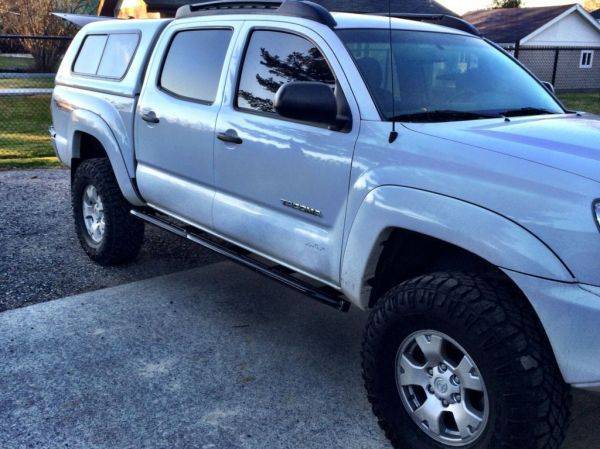

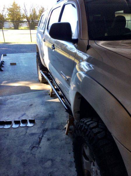

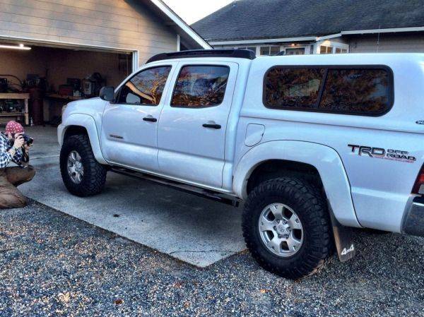

    Lol those sliders and that building look familiar. :D
    I've got some extra 3M step grip tape if you want it.

    Ya, the one I put on the NW CL thread...

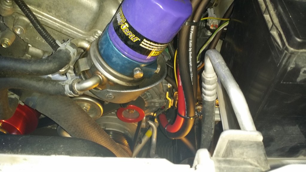

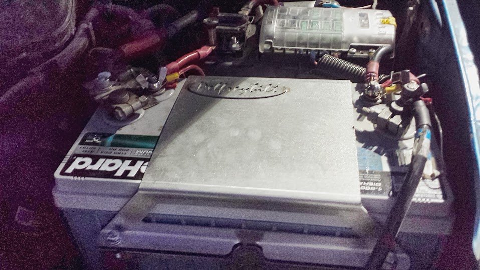

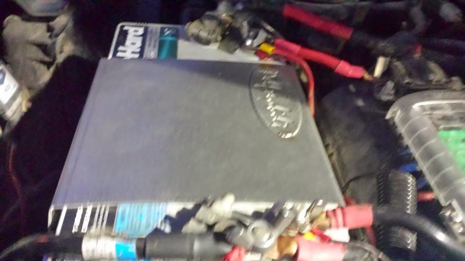

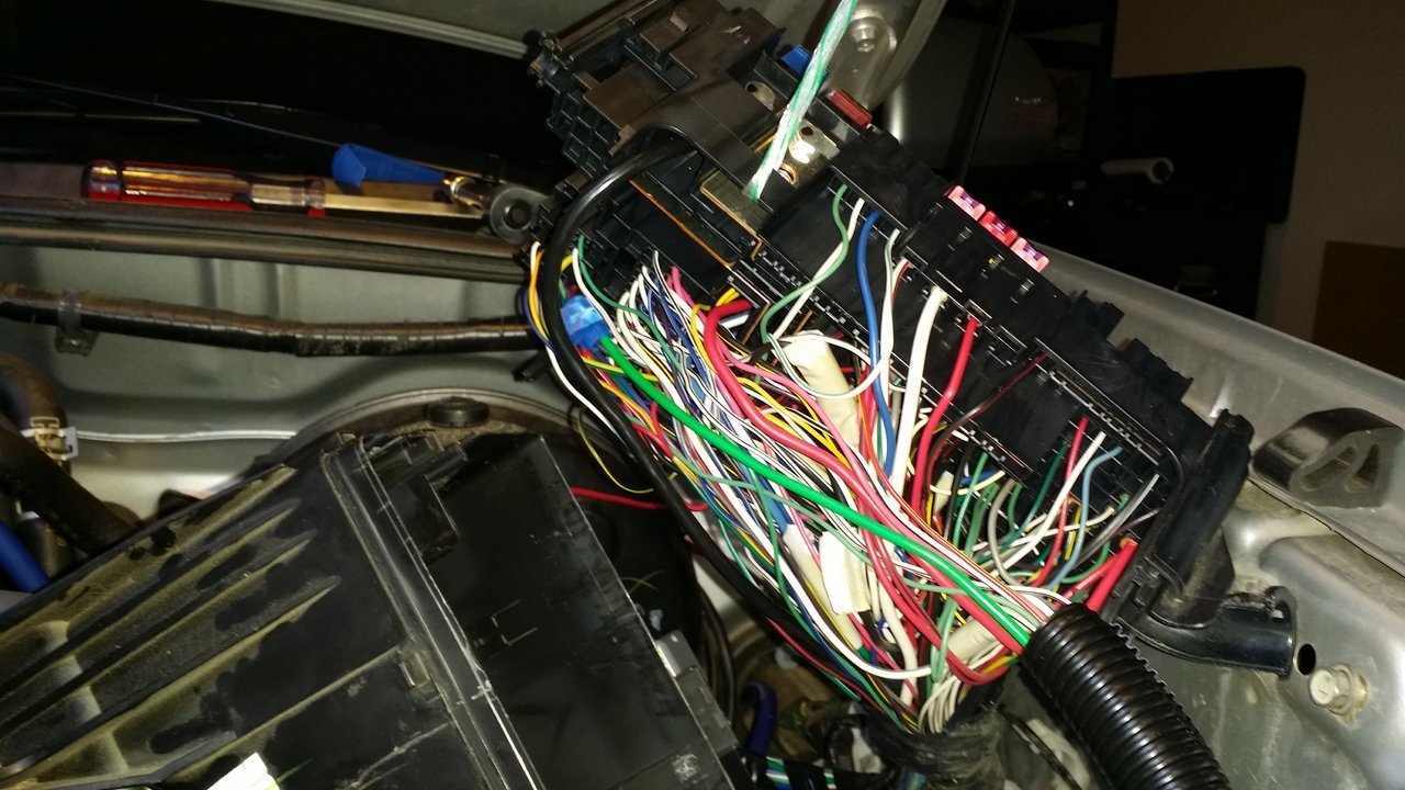

    Over the past two days I did the Big 3 upgrade on my Taco. Removing the old wiring was the hardest part, just getting everything unclipped and removing the alternator wire from the stock fuse box...
    Stock Wiring (From top to bottom: Negative lead to engine block and chassis, Positive lead to starter, positive lead from alternator to fuse box, alternator and starter wiring harness)

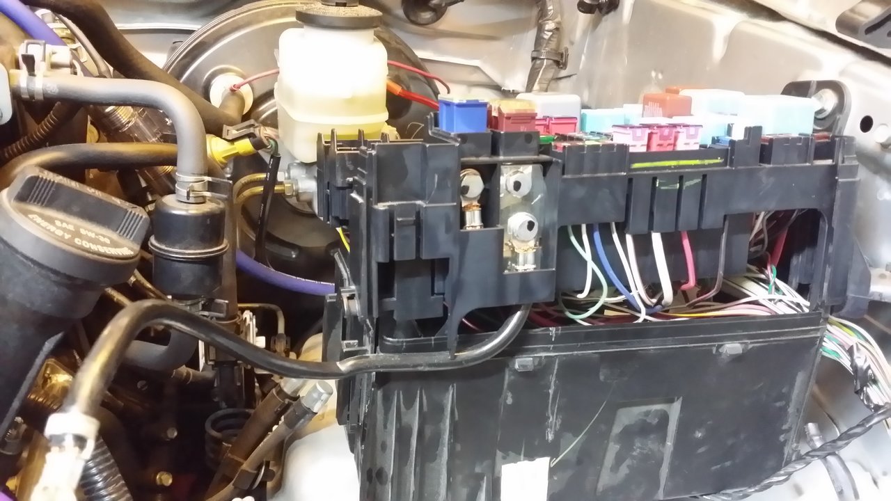

    Stock Positive lead to Alternator Fuse about to be unbolted from fuse box and replaced:
    Replacement wire 4 Gauge (0 Gauge didn't fit):

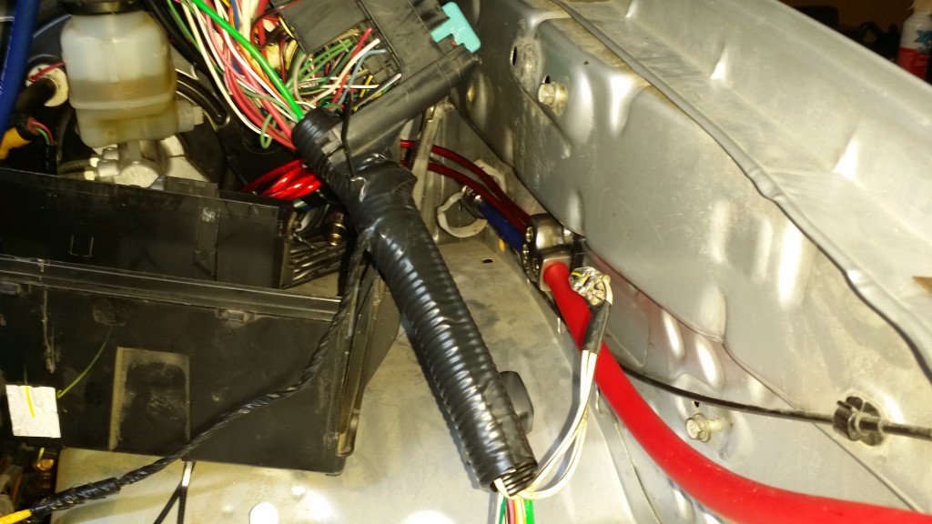

    Took the opportunity to move my radiator fan / AC Compressor wire tap (thick green wire) and clean up the wiring exiting the fuse box with some tubing and a lot of electrical tape
    Took advantage and installed a power distribution block behind the stock fuse box to split 0 Gauge to 4 Gauge for amps, and 2x8 Gauge for fuse panels
    Battery positive to Starter, Battery to engine ground, and Battery to Chassis ground coming from battery:op81_2350d505eeedbdc8428c1b28ed744891f9c6c07e.jpg
    Battery negative to chassis ground and Alternator bolt to chassis ground:

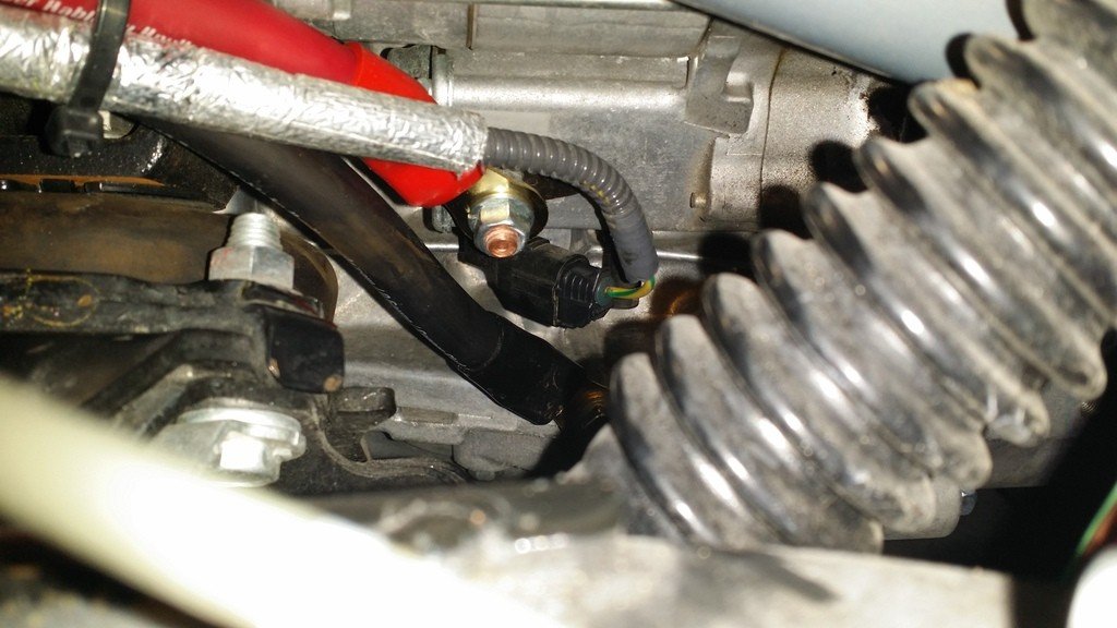

    Positive lead on starter and negative lead to engine block:
    Picture of engine bay after work done:
