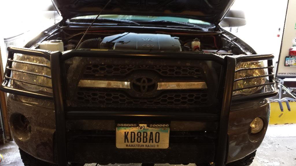

    Installed my Aries brush guard. Also need to reinstall the fog tomorrow
    Pics to follow
    Installed a tablet holder and dash mount. Actually installeda few weeks ago

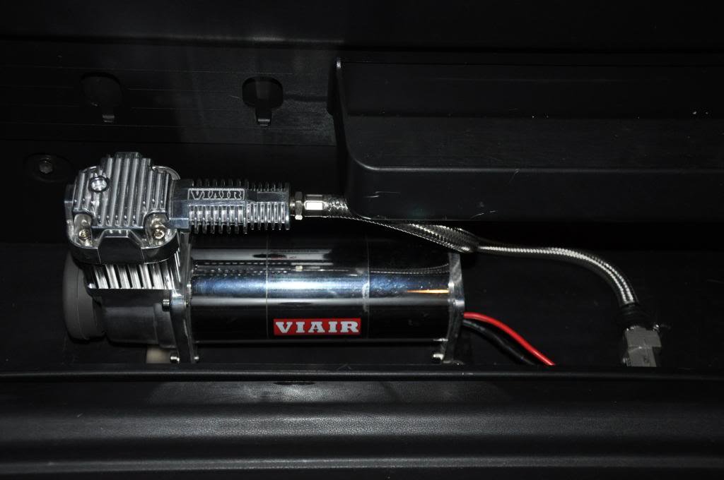

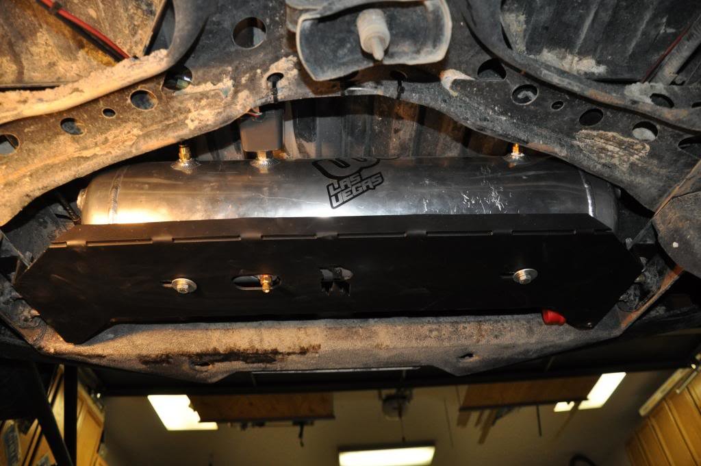

    Well I've been gathering parts for the past couple weeks to do onboard air. I picked up a Viair 444c pump and 5 gallon aluminum tank from a friend of mine who was reworking his airbag setup on his Audi. My dad had a pressure gauge from an overload airbag setup he had a few years back and the rest of the hose/fittings/wire I either had laying around or picked up from a local commercial truck shop. My plan was to mount the tank under the truck and the pump in one of the rear cubbies. That plan changed a bit when the pump was larger than the cubby and I didn't really feel like cutting into the storage compartment to make it fit, so then I decided to mount it behind the rear seats on the passenger side. I still mounted the tank under the truck where my spare tire once was. Under the truck is a sweet spot for the tank since its basically unused space but I wanted the tank protected and mounted level too or above the bottom of my high clearance rear bumper. The solution to protecting the tank and mounting it that high was to build a skid plate/mount for the tank. Lucky for me we were having a mod day here in Reno at the Relentless Fabrication shop. Eric was cool enough to take my rough idea, draw it up in CAD and cut it out with his CNC Plasma. We then used his press break and some big hammers to create the bends needed to mount the skid to the factory rear bumper mounts. All in all I'm very happy with how the compressor, tank, and the skid turned out to complete my OBA setup. Thanks again Eric! Here are some pics of it all complete and where I routed the air chucks too.
    Front of the tank, with the pressure switch/relay unit facing forward.
    Compressor mounted behind the seat in the storage compartment.

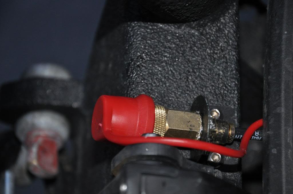

    Front air quick connect with protective cap.

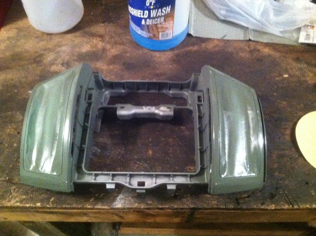

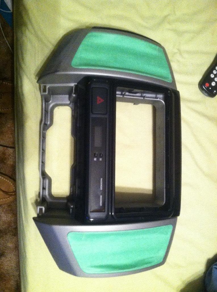

    Masked, and prepped the center dashboard bezel for paint -
    D675C9D7-081F-4934-ADD3-C8D0B0126DF4_zps_92bcb826428e27d81eae90832e4815f0c41bc2b9.jpg
    And got it in primer -
    FC1AEAF7-BD8B-4AD2-BC59-5CD8360FE6B1_zps_4a8c3b05d4fc3887691434b901aeaa184a019176.jpg
    I'll be able to wet sand and paint it tomorrow.

    Nice setup. I just got the Dual 480c kit and have been looking for a good tank. Do you know what brand that tank is? I like the quick disconnect on the front too.
  18. Mar 6, 2014 at 9:16 PM
    nvwiggins
    nvwiggins Well-Known Member
    Apr 1, 2013
    #101079
    591
    David
    Elko
    96 Tacoma, 85 T4R
    Tepui Kuenam Sky RTT.
    It's a 5 gallon tank, I believe it's from open road tuning. Not sure what brand.
