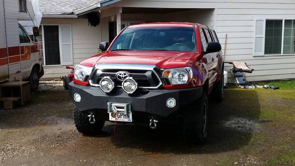

    I have the same front bumper. When drive on dirt roads and off road is there a knocking noise . Ever since I put mine on . And go on some bumpy roads it happens. I thought it was the bolts wernt tight enough . But there tight. Also what type of winch did you get for it

    Did you take off the little bumper cap things under the headlights?

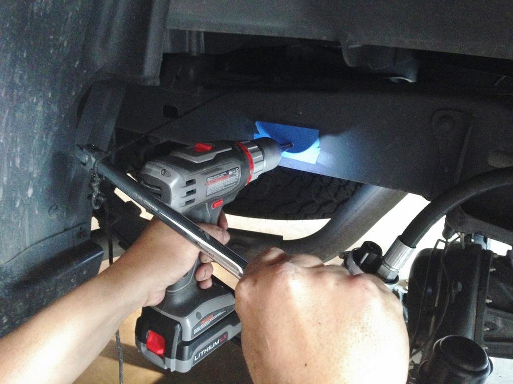

    X2!
    Having quality drill bits would help too!

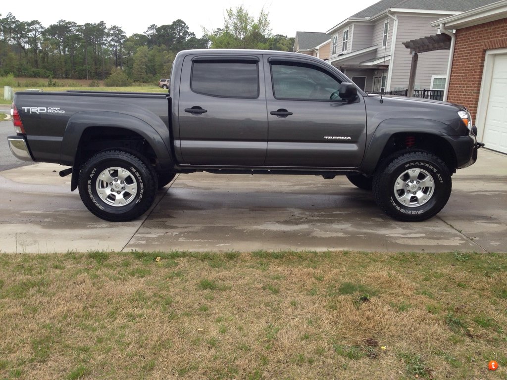

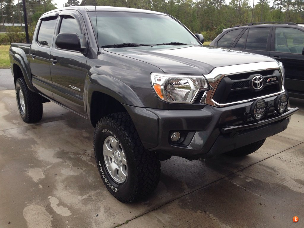

    Looks great. Is that stock height or lifted with the new suspension?

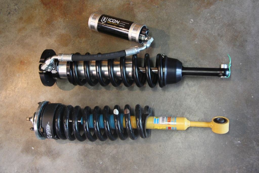

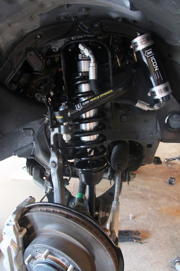

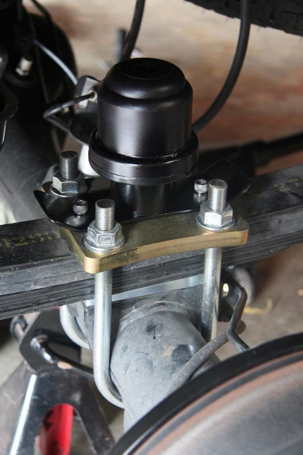

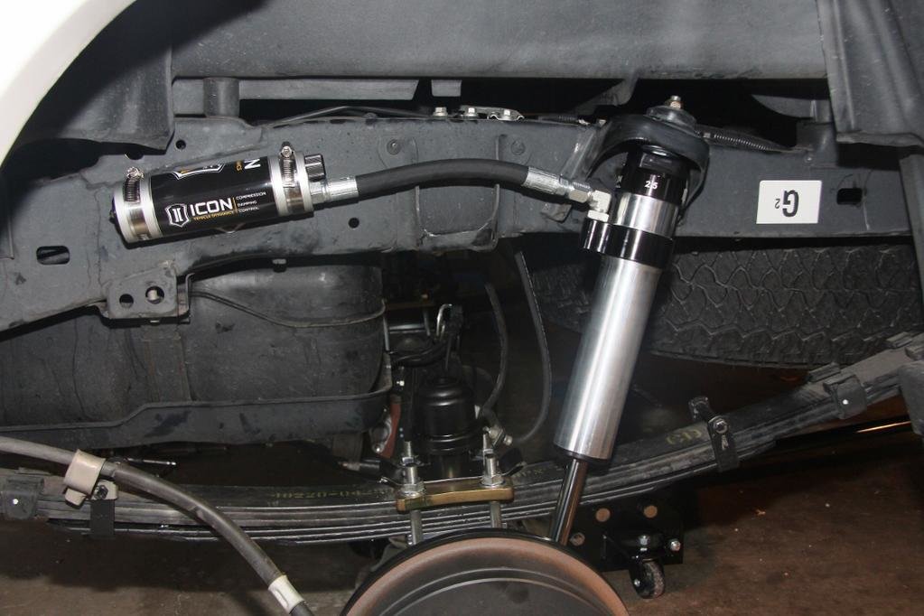

    We got 2 inches of lift with ICON 3 leaf mini AAL pack.

    Body armor front t and rear bumpers, warn M 8000 winch
    I got the warn M 8000 .

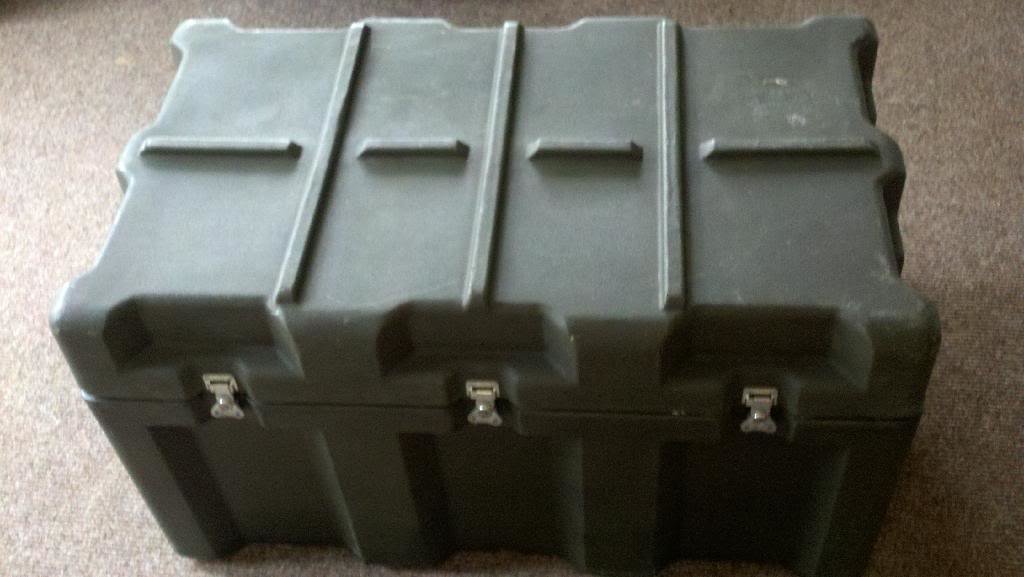

    got my truck/recovery box a couple days ago.

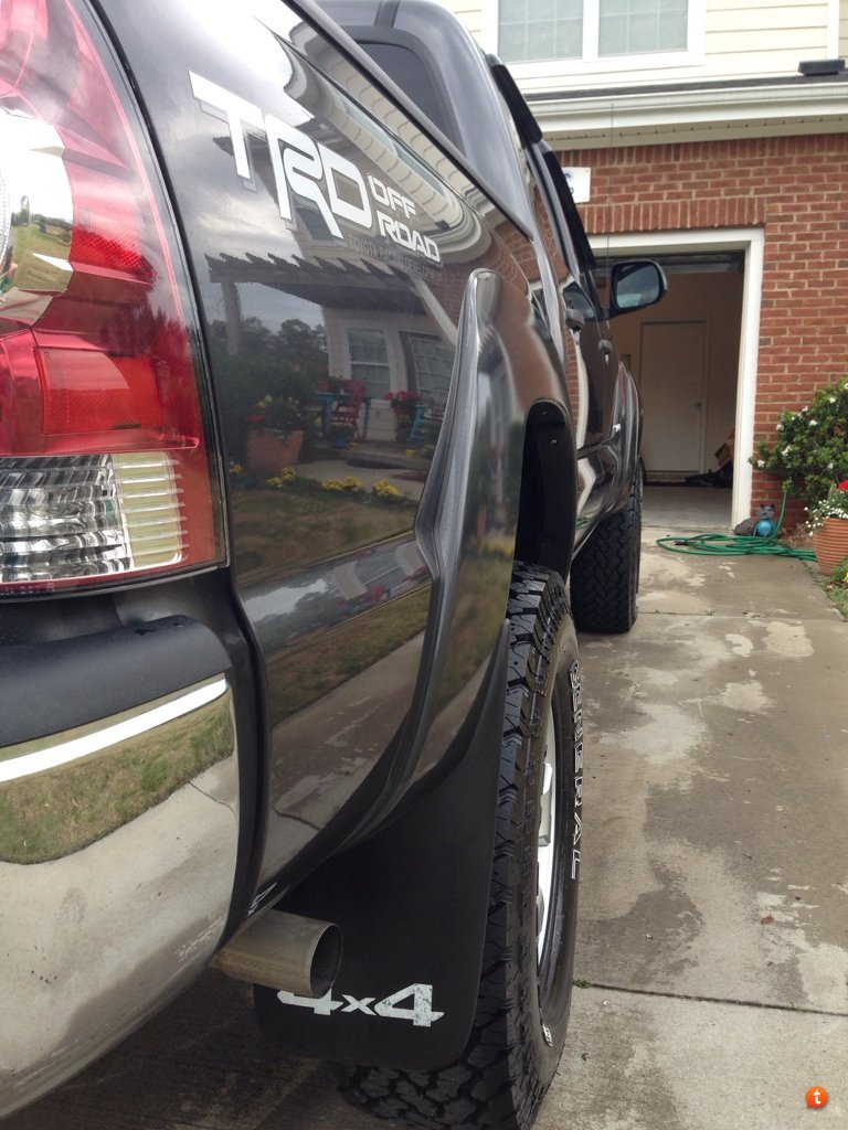

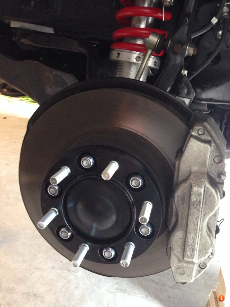

    Installed my Bora .75" wheel spacers and removed front mud flaps, which seems to have resolved the minor rubbing issue I've had with the new 285's at full lock.

    Your picture isn't very clear, but I think you put the lugs on wrong.

    Lug nuts holding the spacers on look backwards to me

    who makes this and where did you get it? I've been looking at a large plaino but i like this better!

    Pelican/Hardigg Footlocker Case
    Got it from Craigslist.

    I concur...
    This is why I hate them. Just another possible failure point.
