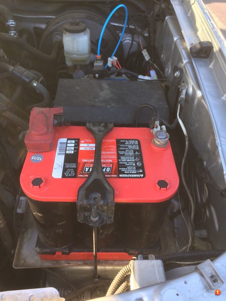

    Put a red top in today

    720 cca's.....sweet!

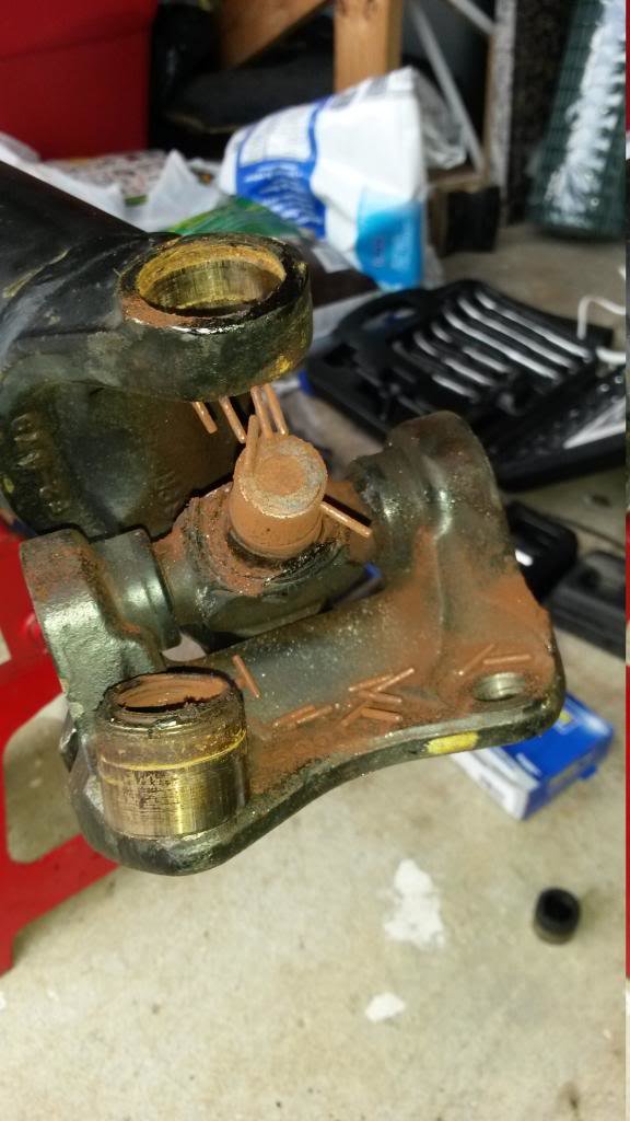

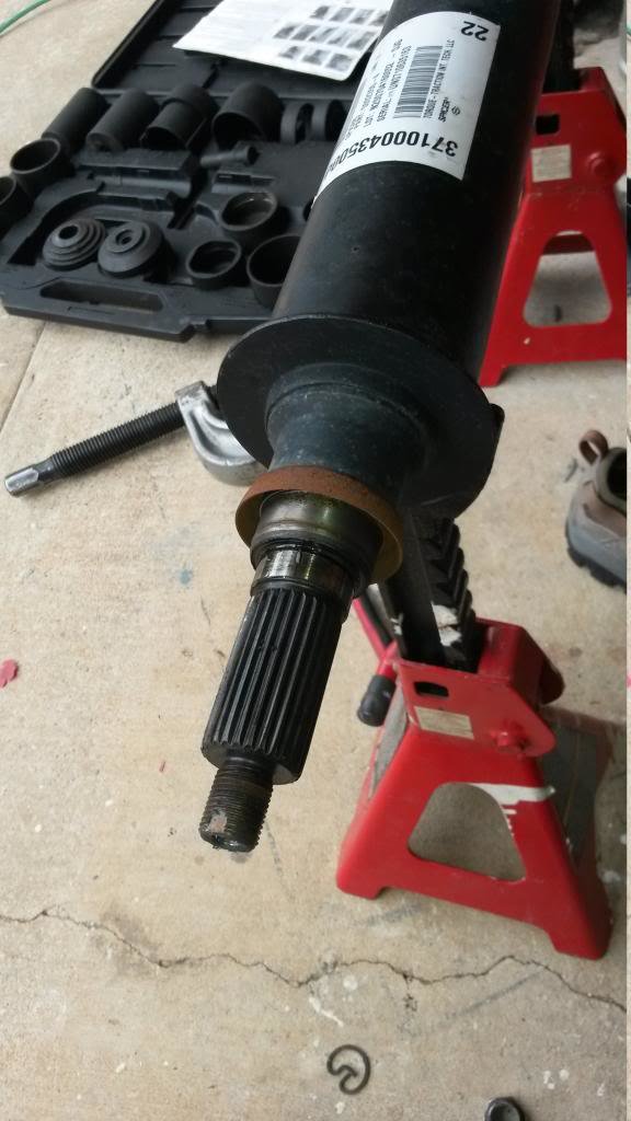

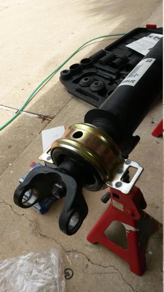

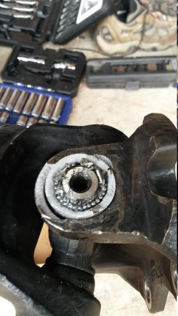

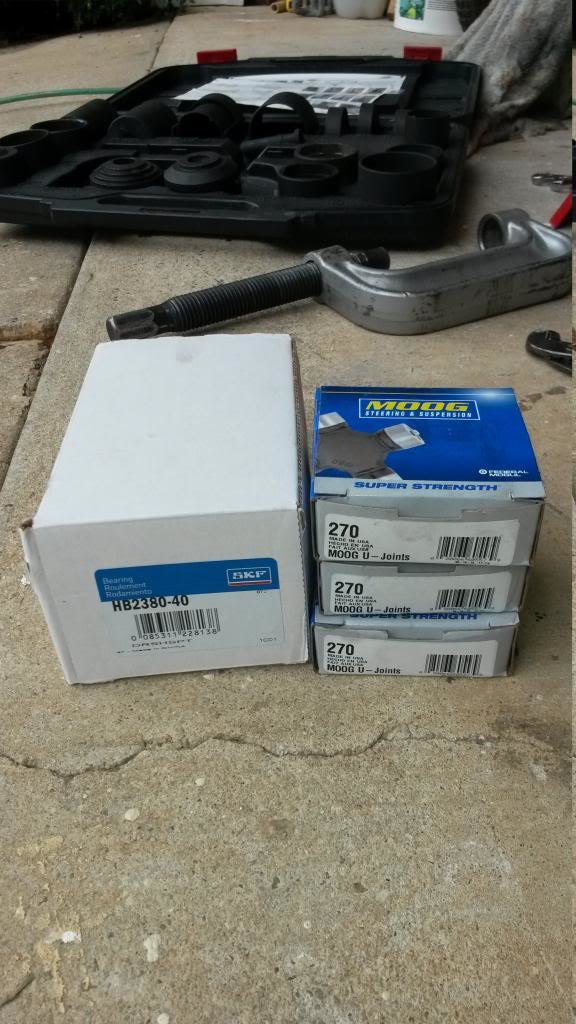

    Rebuilt my drive shaft. Had a squeak while in reverse and traced it to my rear-most u-joint. Went with Moog greaseable u joints and SKF carrier bearing.
    New Parts

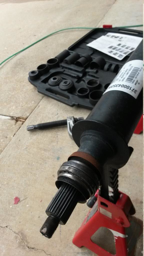

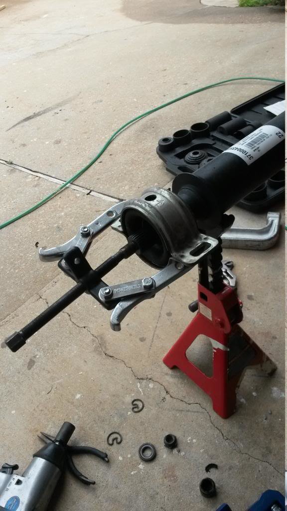

    Started with the carrier bearing
    Found the source of the squeak!

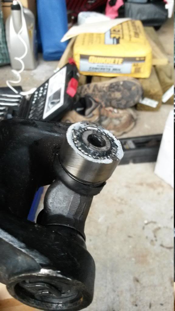

    And appearantly you can bust bearing caps by pushing the cross too hard!:eek: replaced it with a new cap and good to go!

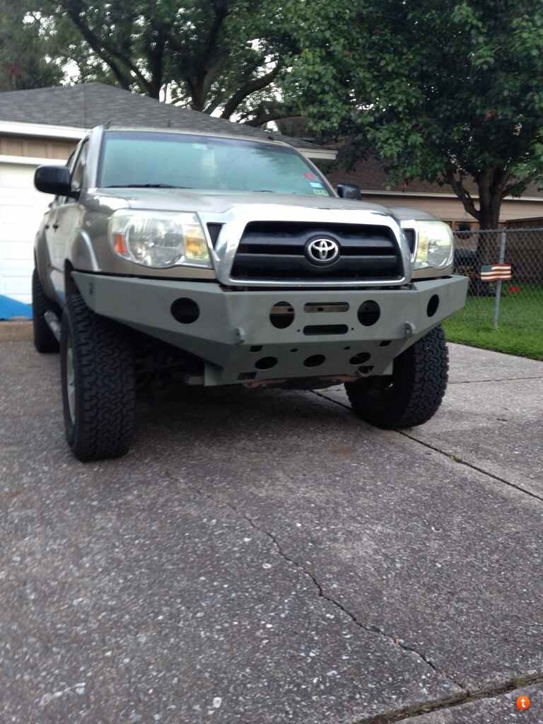

    Finished welding up my bumper and got a coat of primer on it last night.

    Holy Cats, that squeaky one was dry eh?
