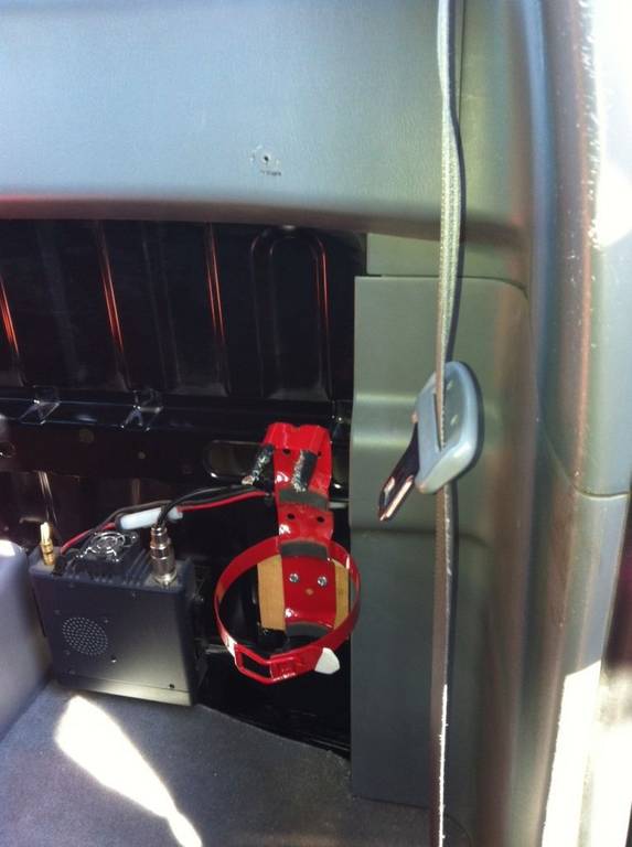

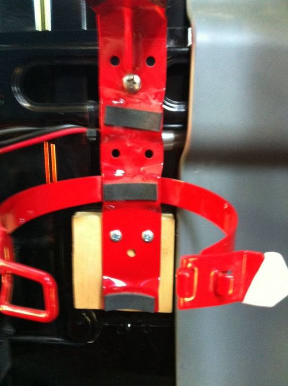

    five pound fire extinguisher mount behind the regular cab driver seat.
    The top screw is into a pre-existing threaded screw hole.
    To secure the bottom, I epoxied a block of wood to the back of the cab and drove two self tapping screws into it.
    Also wash and slider paint touchup from last off road outing that threw a lot of gravel.

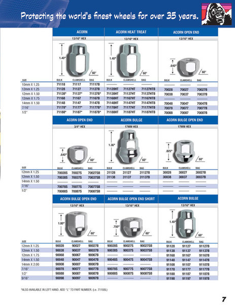

    Width and Length is what you need to determine for the lugs to fit the Jesters..

    This is the first page from their nut assortment that illustrates the dimensions. There are more pages if you check the site with other lengths and diameters as well. So, that's the first step..

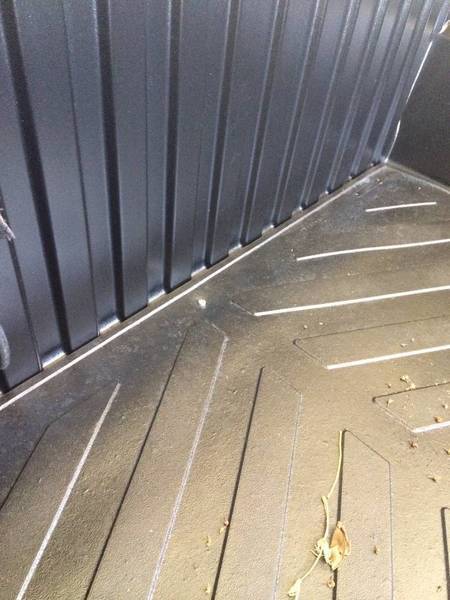

    Bed mat security mod
