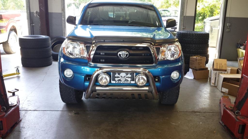

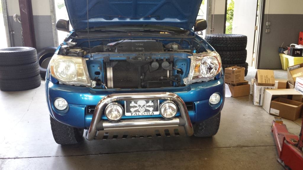

    full detail and new head lights :D got the headlights from Amazon $140 shipped. super happy with them let hope they dont leak though
    I fixed a clunk in my front end. Turned out to be a loose lower control arm bolt but took chassis ears to figure out.
    next step is fixing my catalyic converter

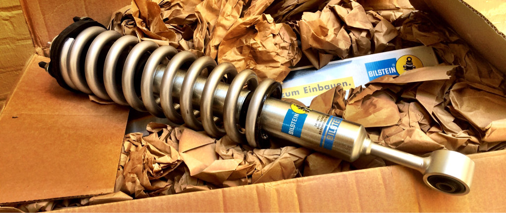

    Well, I haven't done it quite yet but my 5100s came in today direct from headstrong. They answered all my questions and got me taken care of! py7abu3u_1d0b23c6160947cc9a709583642c76c692e94a2a.jpg

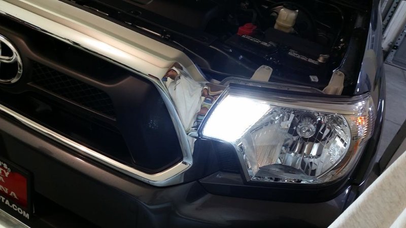

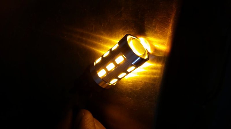

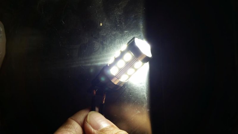

    I added switchback LEDs to the turn signals. White as DRL, yellow as a turn signal. :D
    30 bucks on eBay for the bulbs and a bit of wiring to solder in the load resistors. Piece of cake!

    Do you have a link to those?

    Nice! Are those eibach coils? How much did u get them for...If u don't mind.

    Your keyword is "2 pc 3157 SRCK / CK Samsung LED 22W high power 22 dual SMD chips Switch Back"
    http://www.ebay.com/itm/2-pcs-3157-...Parts_Accessories&hash=item3f277b5fe7&vxp=mtr
    Gahhhh they want $42 for them now... keep looking for that key phrase to find them, I won an auction for them cheaper.
    These things look really good! Worthwhile mod IMHO... just be sure to use load resistors across the following wires:
    PASSENGER SIDE: Blue and white/black stripe wire.
    DRIVER SIDE: Yellow and white/black stripe wire.
    The green wire on both sides is your parking/DRL light.
    Have fun!

    They look good, dude...quite an upgrade
