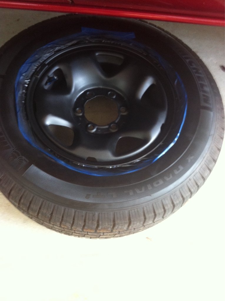

    Too latr now, but playing cards or index cards would have been alot easier than tape. Looks really good tho.

    Yup...makes it so much easier

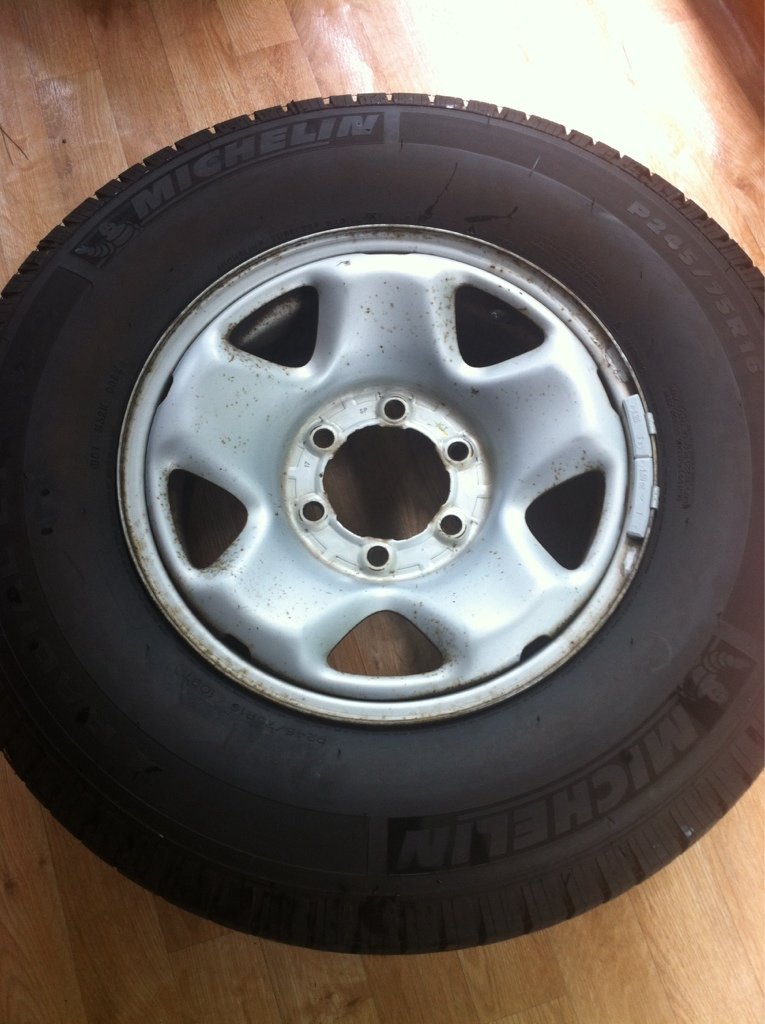

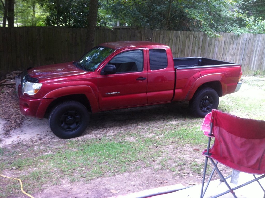

    Rattle canned my rims today.

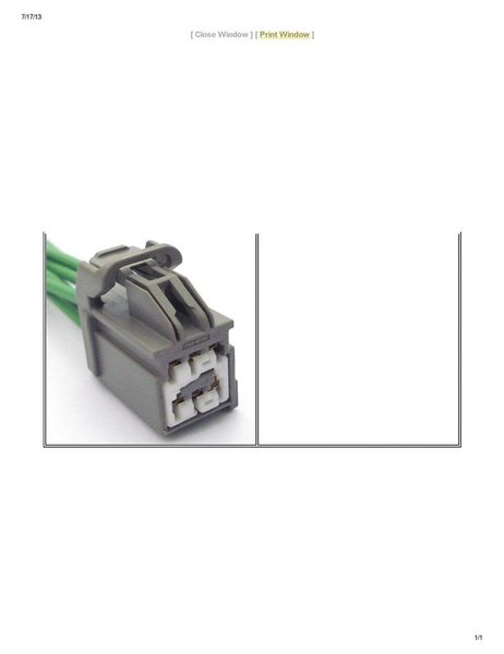

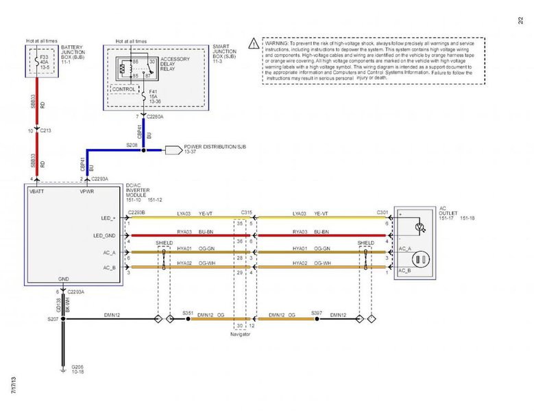

    There is a pigtail connector for it too but I don't have the number handy

    Ooh! Please let me know if you find it. For some reason I assumed that it was just a part of the main wire harness. I was just going to solder wires to the pins, but the connector is the proper way of doing things.
    NVM! Find it.Kinda expensive. $27 is the cheapest i could find.

    Worth it imo made things easy. I took out all the wires except the two I needed
