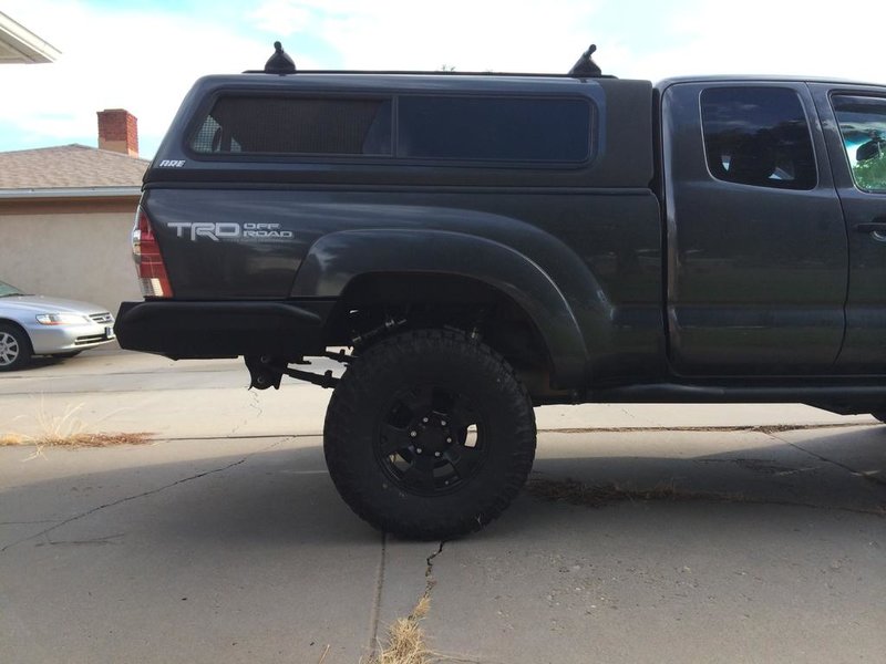

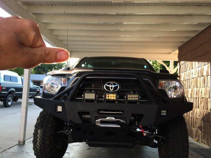

    Installed Relentless front bumper, rocksliders, and HC rear. Painted with Raptor lining, Rigid Lights (two driving, one hyperspot), Warn 9.5xps winch. Also paint chrome grille same color as truck.

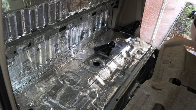

    Sound deadening the backseat area.

    Very nice , how long was the wait on the bumpers ?

    That is very interesting, I have always thought the Tacoma cab to be a little noisy, What material did you use? degree of difficulty? did it accomplish what you wanted it to? Thanks

    It took 8 months to get the bumpers and rock sliders, was a long wait. The craftsman ship is excellent.

    I used RaamMat - was suggested in several threads in the Audio forum here. And I added a layer of their Ensolite closed cell foam on top of this. Deadening material handles resonance, and the foam is another layer of sound block, and physical decoupling of vibration. Took me most of the day/afternoon. Pretty easy to pull all the interior, and I just pushed the carpet back.
    I haven't driven much since applying - but I'd like to say I'm hearing a little difference. I'm doing a full audio system, and this was a prep stage to getting the whole install done. I am doing the doors inner and outer skins when I do my speaker swaps.
    One day I'll pull the carpet for cleaning, and probably do a layer of sound absorber called Mass Loaded Vinyl (MLV) under there too.
    The products are just peel and stick - use a roller or screwdriver handle to get it to lay in all the contours.

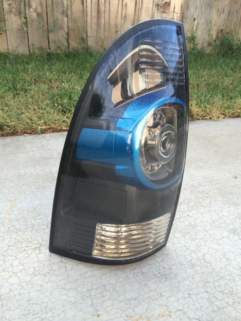

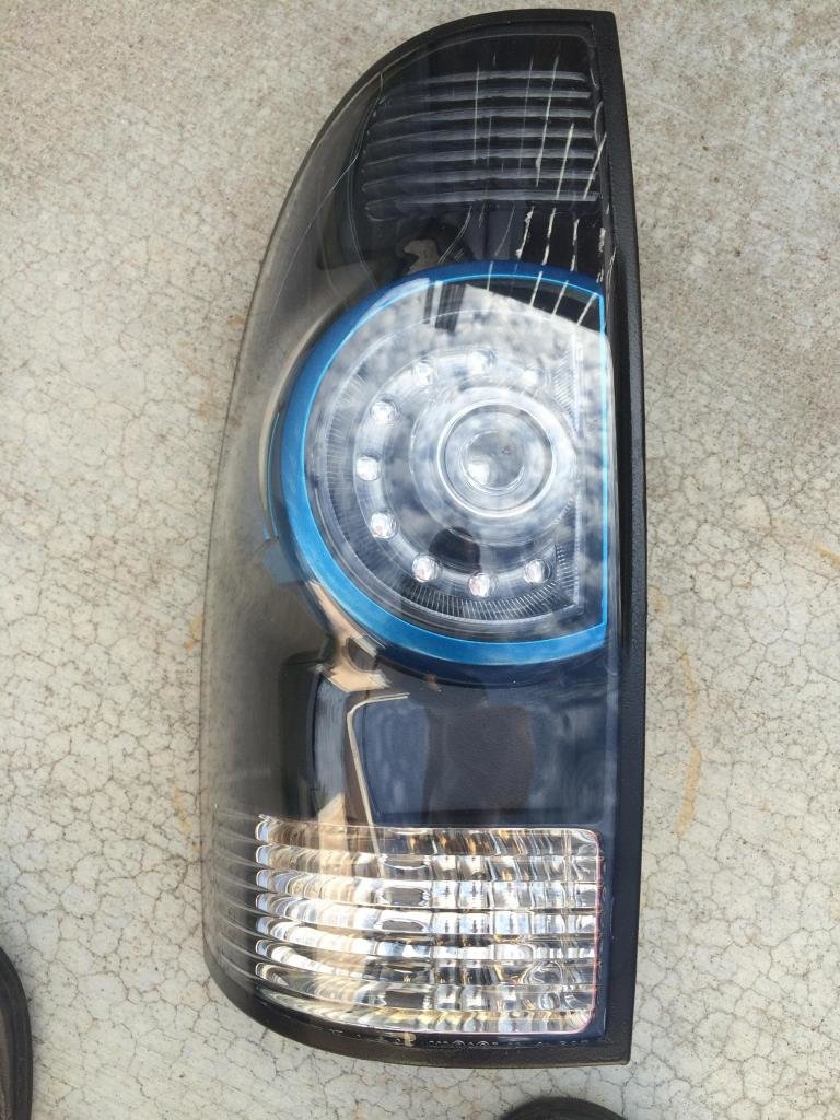

    Finished the taillights. They aren't perfect only because I hit the inner lense when cutting apart (too deep, a common problem for me ;) but I don't think it's too noticable. No one else will have these at least.

    How did you do this? Is there a "how to" for taking them apart? Nice work!

    Those look awesome. I would be worried about the legality of them though.

    Look good, got me thinking about doing this, except the blue part of course :rolleyes:

    The blue is to match, they're legal except the reflectors, the LEDs will shine through just as bright as ever, and I live in Washington state, this isn't California haha. If I catch any heat I'll buy a couple small reflectors and mount them on the back truck sides somewhere. Still much more legal and safe then painting or wrapping the outside of the lense.
    And just search black tail light mod, there's a couple write ups
