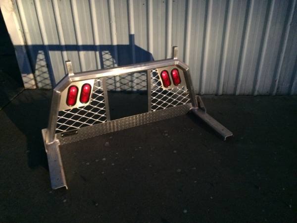

    Found this headache rack off a Ranger for $350. Does anybody know if it will fit a my truck and is it worth it?

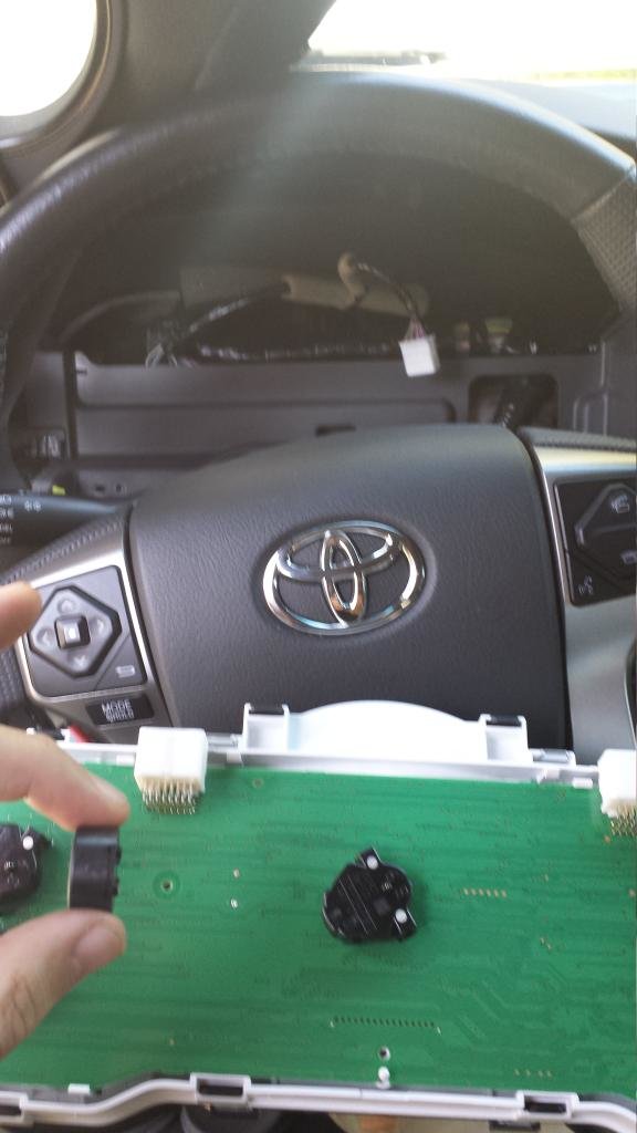

    2014 seatbelt and door beep disable by removing the beeper

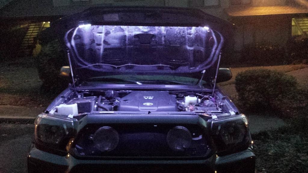

    Hood light kit

    I need that mod on mine. Is there a thread to remove the cluster and beeper? I also want to change my lighting in the dash, console, etc.

    Beeper is easy.
    Take the bolt behind the kick panel by your left foot out. The take out the little shelf by your right knee out. Then pull off the cover hiding the lower dash bolt by your right knee and remove the bolt. Pull the lower dash out a little. Pop the the push pins above the cluster and remove. Lower the steering wheel and pull the upper dash out enough to get to the cluster. There are four bolts in four corners. Take those out and disconnect the two wire harnesses. Pull out the cluster and there are 3 silver screws on the back. Remove them. Take pliers and turn twist the circular nosie maker. (I have no idea what it is called) reassemble and enjoy.
    Pm me if I can help

    That is excellent. Do you have any details on what your setup is (LED roll or individual, wire running, hood pin or manual switch, etc)?
    I really should eventually invest in a set of hood struts. I have a set in the Subaru and they're brilliant.

    Thanks
    Single strip 5630 led srtip wired to aux fuse box with a hood pin my friend gave me...wires run in hood crevices and zip tied at hood hinge
    Love it the 5630 are bright as hell
    And yeah the hood struts should be in from the factory
