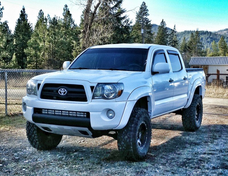

    Looks great. What are your hub to fender measurements and how do the OME coils ride now?

    The ome coils ride so nice like butter.
    Hub to fender
    Front both sides 24"
    Rear both sides 24.5"

    Shoot! That'd be like a 4" lift from what I used to be stock. I'm at 22.75 I think now. I think 885s will be my choice for 2.55-3" of lift with billies at 0

    I got about 3.5 up front but once they settle I'm sure it will be 3 it aligned well my left side caster was a little low everything else was good

    Wow, that's 1.5" more than I got out of 886s. Cray.
    Edit: maybe you got 888s :notsure:

    Na they had 887 tag on them they will settle about half inch I'm sure

    2in aal not sure which one it was installed on the old lift I took off before I bought it

    I was kidding. Truck looks good!

    I know it's cool lol thanks man way,better than the spacer lift it came with money well spent I'd say

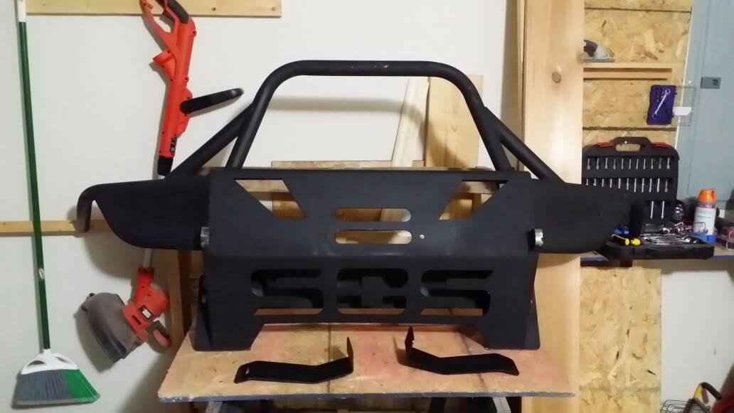

    Got my SOS bumper in today but sadly I don't have time to install it before I leave for
    Christmas vacation tomorrow... so here it will sit till Jan 9th.

    I like :thumbsup: Aluminum or steel?

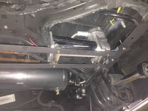

    The tank is probably fine where it is but the pump will get a lot of road debris and if you're driving in deep water, it could be submerged. With some cutting, it will fit in the larger cubby which puts it higher and shields it from the day to day crap.
    If you can't move it, at least try and get the intake as high as you can-this would be the easier thing to do.
