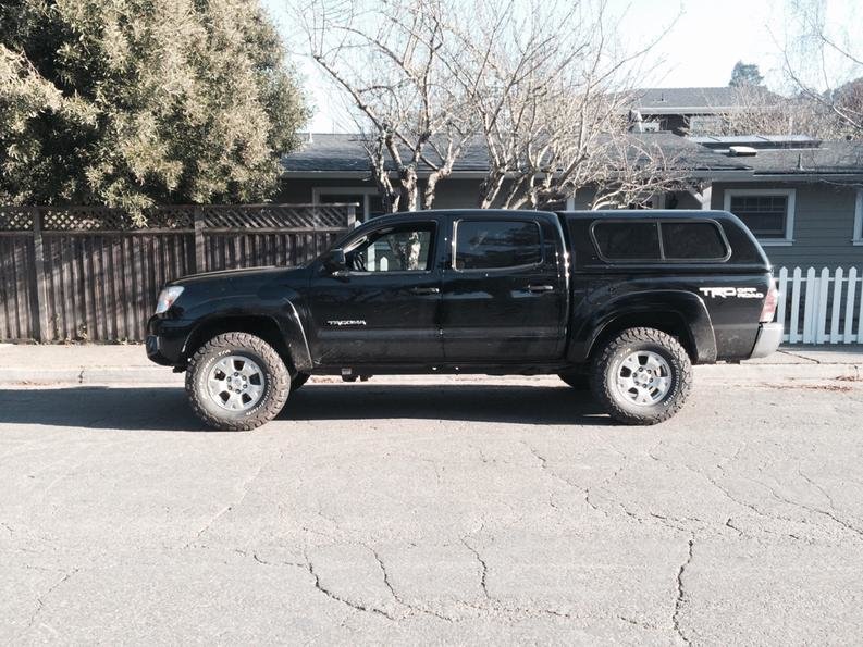

    Bilstein 5100 @ .85 on stock 2014 DCSB OR. I initially installed with 1.75 but had too much bro lean with my camper shell. Initial measurement was 35" from floor to fender. 1.75 was 37.5" .85 is 36.5". Ride is much better not as plush of a ride but less dive under braking and corners flatter. Feels really good in the dirt and bumps. Most importantly looks less like a hot rod and more like a truck. Pretty darn level now. Tires are bfg at ko2 265/75/16 ImageUploadedByTapatalk1420347275.353131.jpg

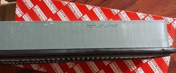

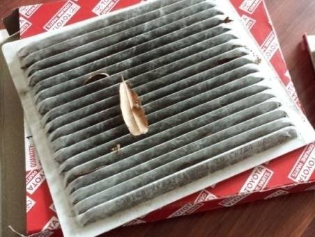

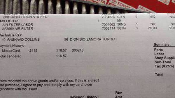

    Replaced air filter and cabin filter. In maintenance records found that those were replaced 4 years ago. If you do your service at places like firestone complete care this is what you going to have in your car.
    And you probably going to pay 3x more then OEM part cost.

    My dealership wanted $60 for the cabin airfilter

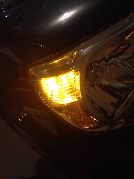

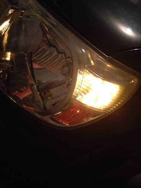

    Looks way better-- what exact color did you go with?

    I reccommend the VLEDs amber corner lights

    I've got the VLEDs white ones and love them.
