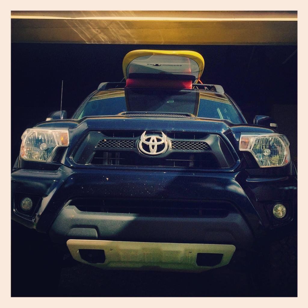

    Not to today but yesterday
    Took my SUP to the beach for the first time.

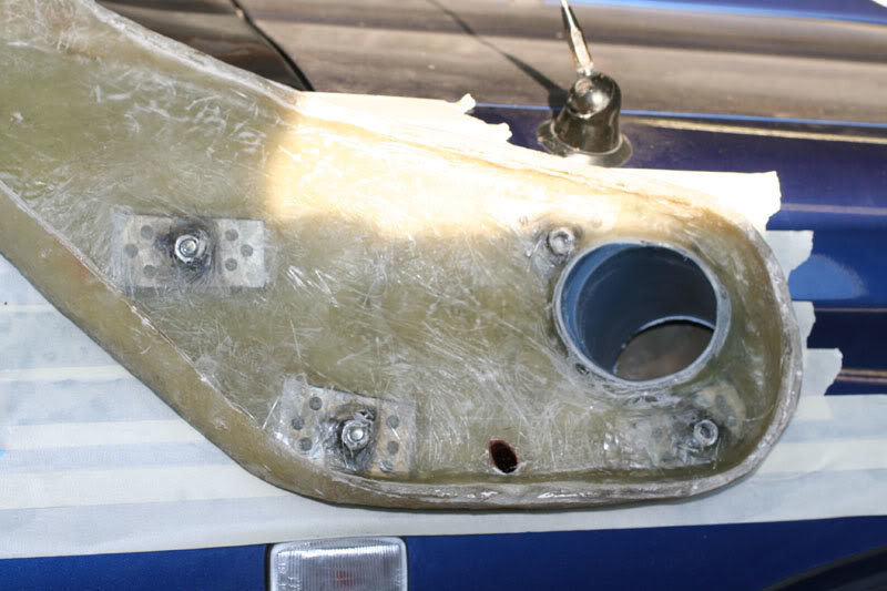

    For those of you with snorkels (any brand) is there a water trap anywhere in the system? I am building one but feel like I have to worry about water collecting in the system over time.

    I believe they do have water relief provisions

    After running them on several vehicles I have not had issue of water intrusion. In heavy rain or snow it is common to just turn the ram backwards. As the air inlet towards motor is much higher than the bottom of the box I doubt you will have issues and water, if any will trap below the ledges.
    It would be easy enough to put a couple rubber plugs in the bottom of the box for piece of mind.

    I am building my ram into the main tube so I wouldn't be able to turn it around as easily.
    I have been considering doing something similar to this guy. Drilling a hole and attaching a small pipe to be able to drain it.

    Ah, will work. I have seen it done on jeeps. In fact I think the XJ? has or had much the same stock.
    Consider using a rigid rubber ribbed tube. The small amt of flex will be beneficial.

    There's a drain in the bottom of the stock air box as well.
