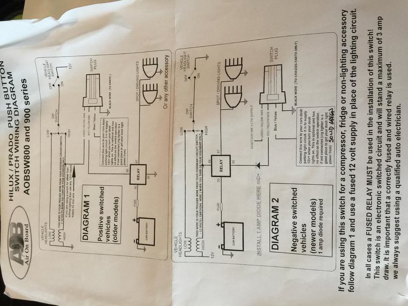

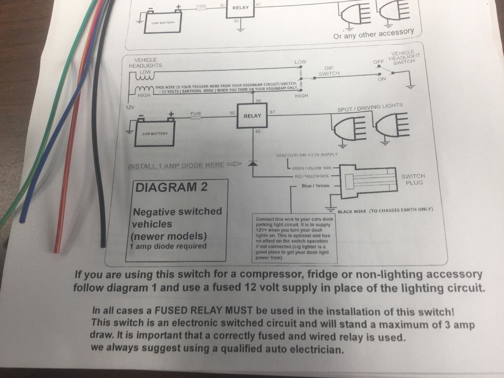

    Sorry, I've searched and searched and I'm still confused. Is there a writeup somewhere on how to wire these up? I want to install a 30" bar in the valence with an Air-On-Board switch. I want the switch to power the bar only when I switch my high beams on. Turn off the switch and just my high beams come on. Make sense? This is the diagram for my switch, but I'm totally lost.

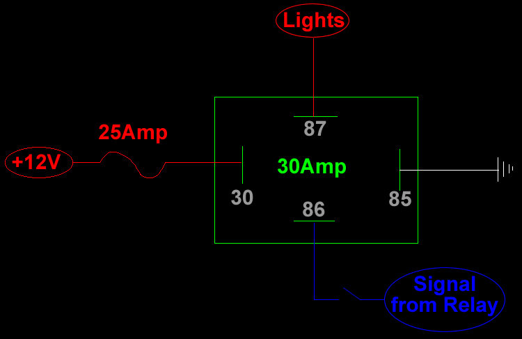

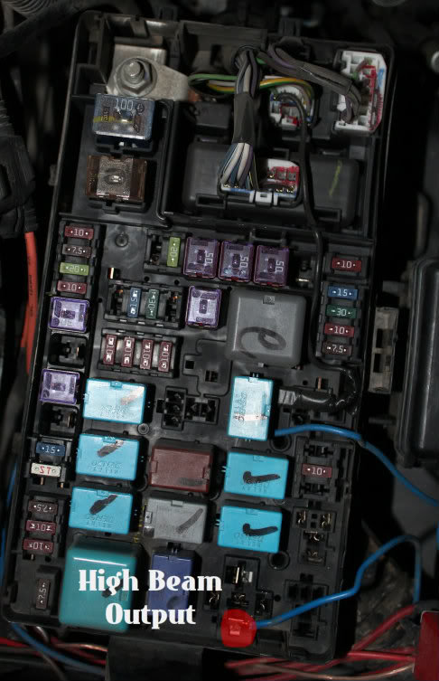

    There you go!

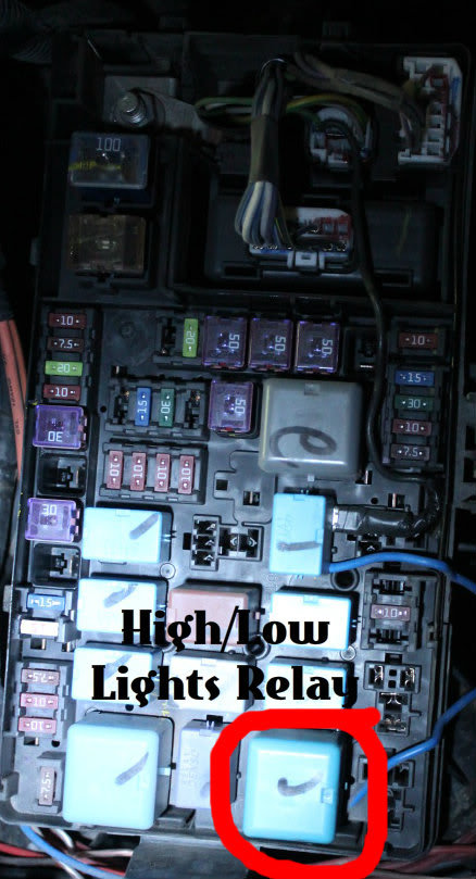

    This is what you have to do:
    In the main fusebox you have to find hi/lo relay:
    Take off the relay and get a cable that will be the signal for your relay:
    Put the hi/low relay back...
    And now, the switch goes between the hi/low relay and your new relay for the lights,
    Note: this is what i did on my 2011 trd sport, and is hust a reference.

    Thanks Chepo!

    I pulled power for the signal circuit from the high beam wire further towards the headlights. Same thing just further down the line really, but I like your method better.

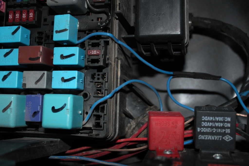

    How did you prepare the wire for this? tinned it? left it twisted?

    So will I need the diode cited in this schematic? Sorry for the attachment, my photobucket is giving me issues. I still don't understand where those guys were putting the headlight harness extenders??

    No pbm! I'm glad to help!
    Thanks, actually it's the same, but I prefer to have the least cables as possible!
    I just left it twisted, it doesn't move with the pressure of the relay
