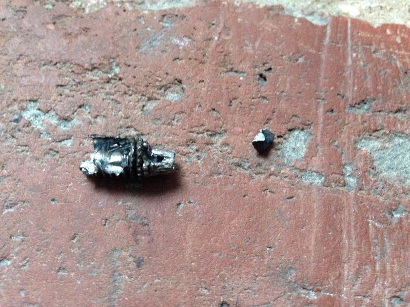

    Was bored after I finally removed the stubborn bolt that broke when I removed the skid plates to flush my coolant system. Here are a couple of pictures.

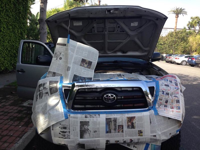

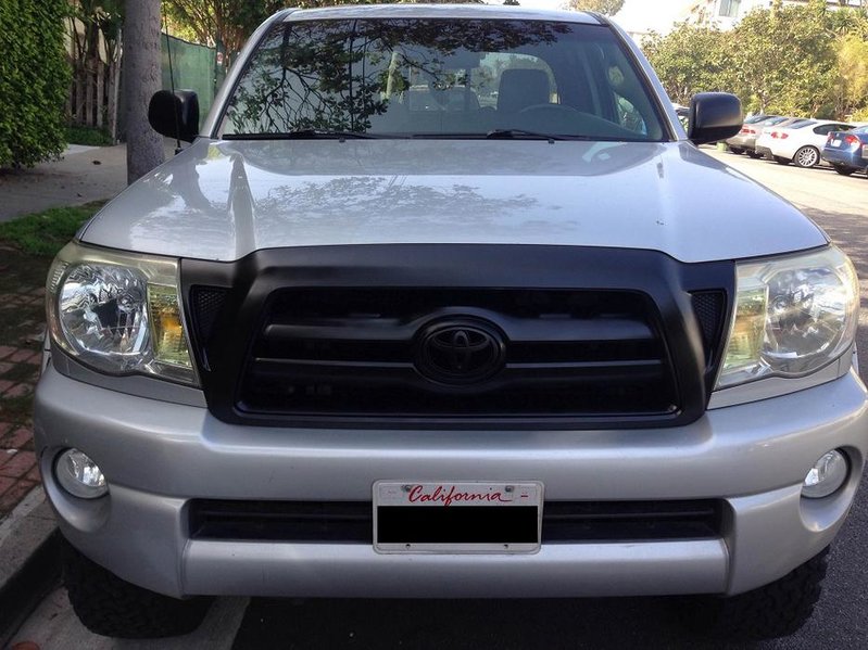

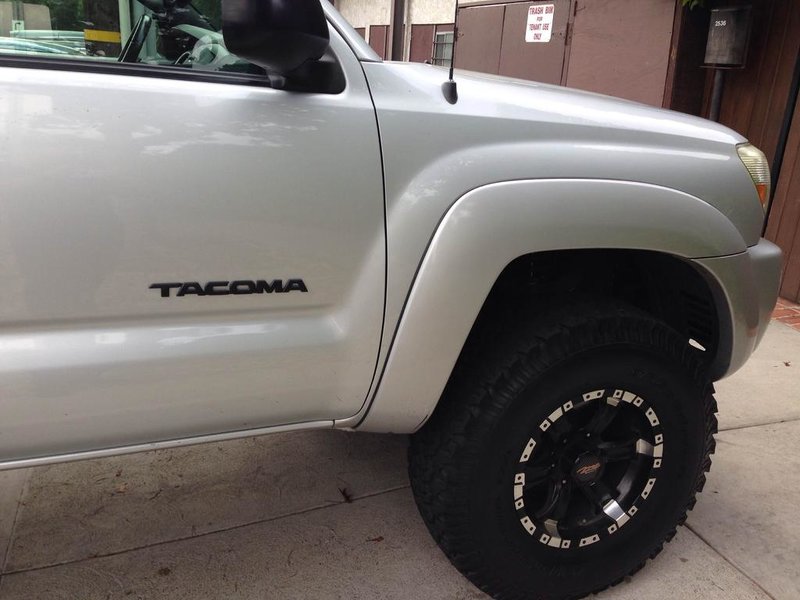

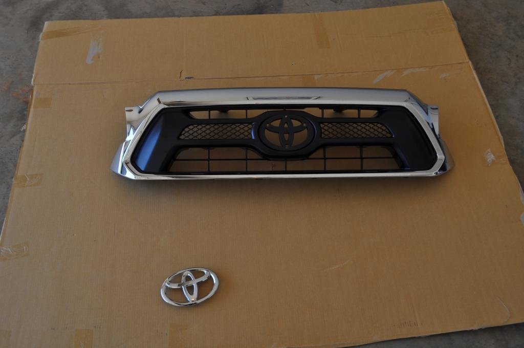

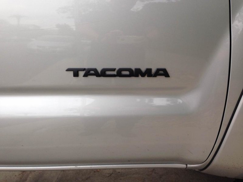

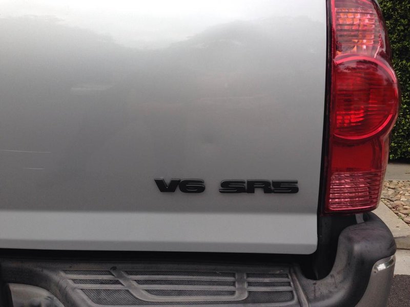

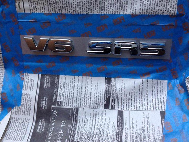

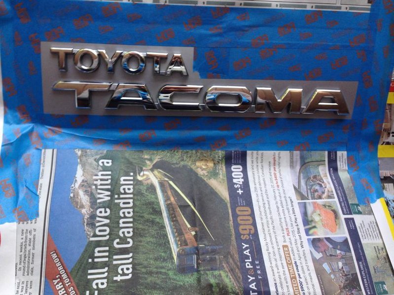

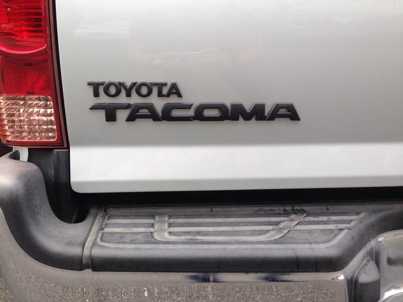

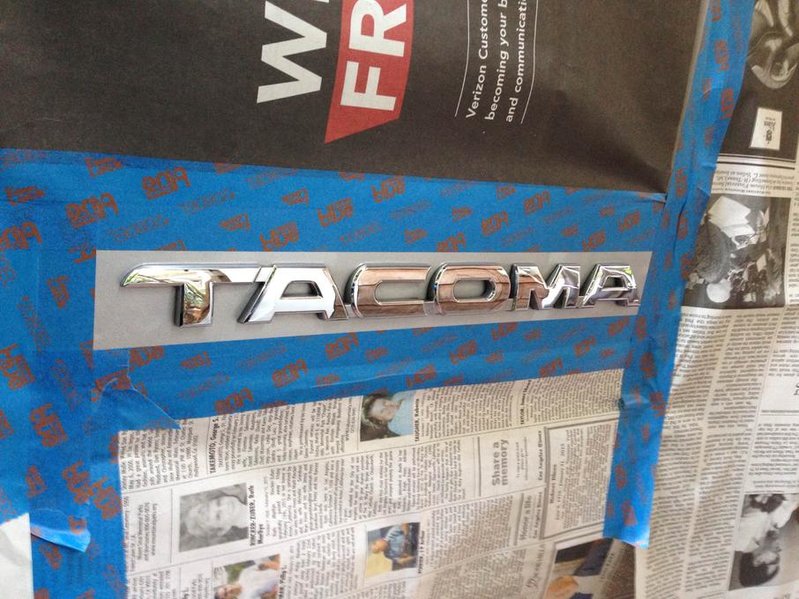

    Then I got bored, so I de-cromed all the emblems for the hell of it along with the grill.

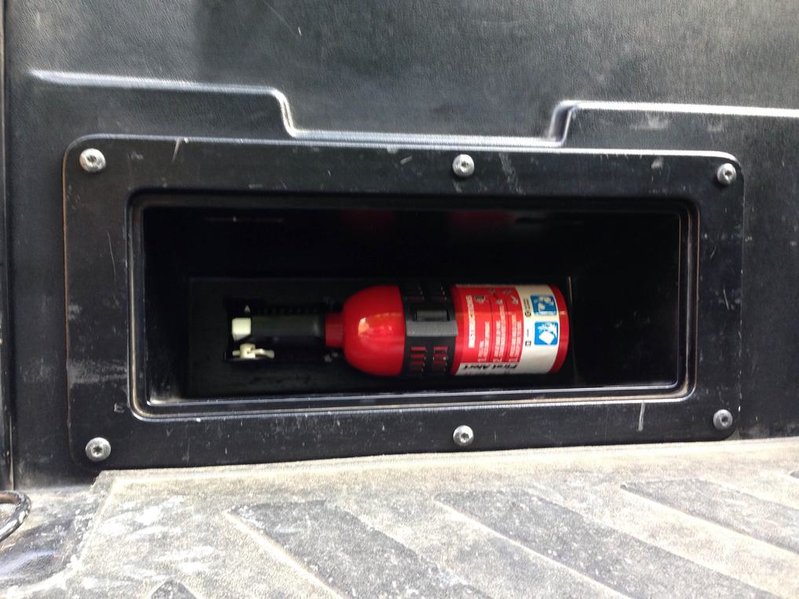

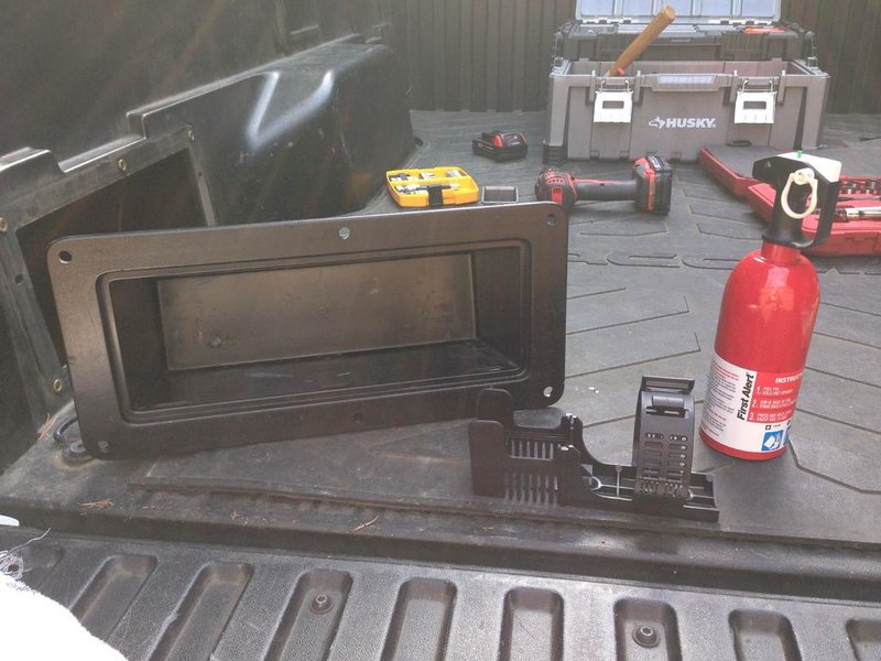

    Then...with some time on hand still, I installed a fire extinguisher in the side of the bed...

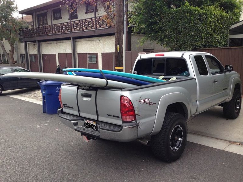

    Once all was said and done the next day, I thought I would load the Taco up and hit the beach for some paddle boarding and surfing my buddy.:yay::yay:
    We need a Surfing Emoji! lol

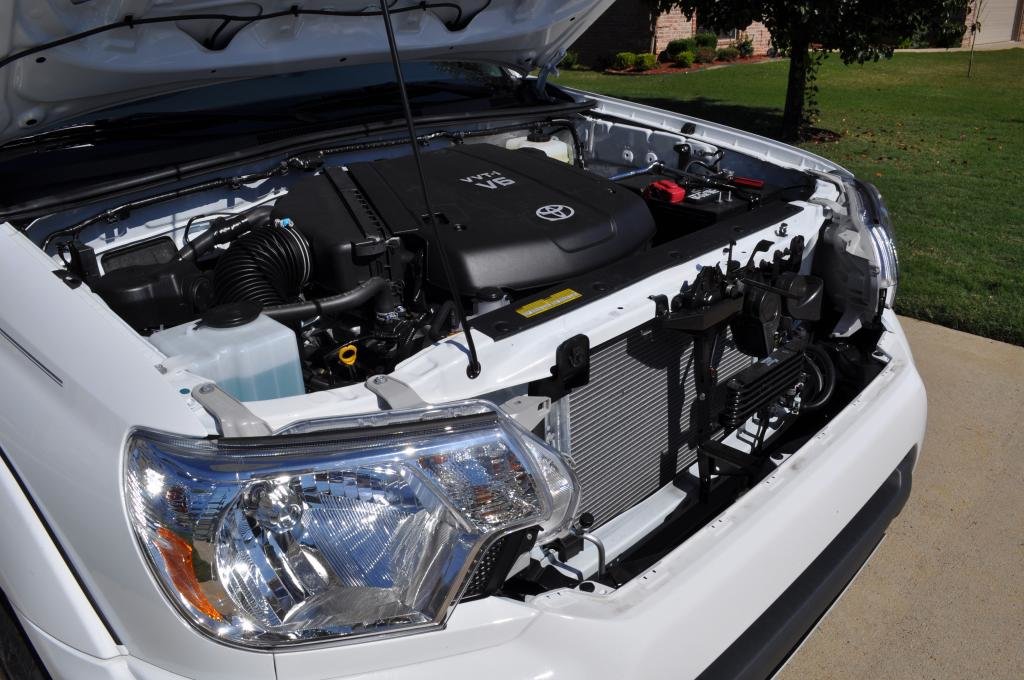

    Lol... looks good but you could have taken the grill off in about 2 mins instead of the 30 to tape it all up. Good job though :thumbsup:

    lol, i was lazy...it was an impulse thing...remove the grill in 2 minutes? Is that a secret? I need to know these things...

    Yeah really ? That easy? Without breaking shit ?

    2 screws on top of the radiator and 2 plastic push rivets (lift the head up with a flathead) then lift off the grill.

    Lol... Yeah, Two tabs and two screws on top. Pull the grill toward you. It will make a loud pop like you broke something but it's just coming out of the tabs that hold it in the bottom.
    I did mine the day I bought it.
    I've since replaced it with a color matched grill

    Right If it was me, I would be breaking shit within two minutes!lol Just look at what happened by me just removing he skid plate? lol

    Yea there are two clips and two 10mm bolts (with philips head) that hold it in.
    Takes me literally 30 seconds or less. 2 mins is really an overestimate.
