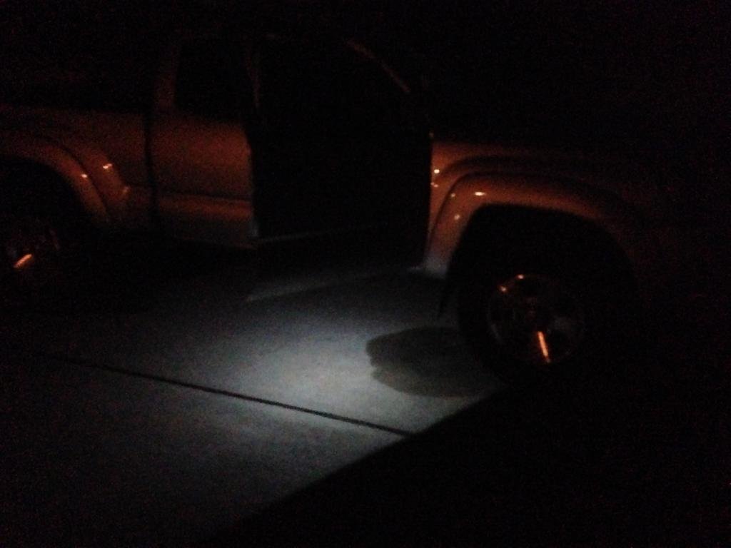

    I plan on tying them into the dome light circuit. The dome light comes on when you unlock the truck or open the doors. It turns off when you lock the truck or shut the doors. Perfect for what I need the puddle lights to do.
    I just powered em off a 9v battery to test them out to make sure they work

    Yep perfect. That is where mine are tapped into. The only issue is the switch itself...it won't illuminate unless the switch is on.

    Chris...if you use an On/Off/On switch they only come on with the dome when the switch is in the correct position. You are correct with the On position...the Top On (depressed = Dome/Rocks), Middle (Full Off), Bottom (Rock Lights on full time). Just to clarify so everyone knows the options...:D

    Dome light circuit
  15. Mar 10, 2015 at 6:25 AM
    MTopp
    MTopp Professional bear handler
    Aug 12, 2013
    #110295
    5,811
    05 SR5 4x4
    trifecta tonneau, pop n' lock, Depo black bezel headlights, mb 352 wheels, 265/75r16 cooper at3s, visors, colormatched 2011 grille with raptor LEDs, much LEDs in and out Future/wanted: black valence, hood scoop, catback, CAI, 285/75r16s, OMD leaf pack mod
    This is exactly what I did, a SPDT switch (on/off/on), lights are on a constant hot power wire with a switched ground. All lights fade on and off like the dome light

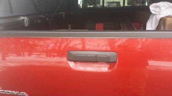

    It's 61 degrees outside. gave the tacoma a much needed bath and installed KB VooDoos tailgate cap. I need to redo the weather stripping which goes underneath since I didn't get it high enough.
