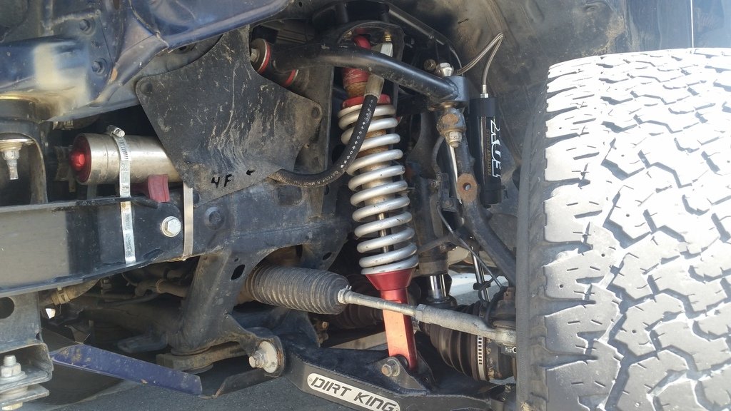

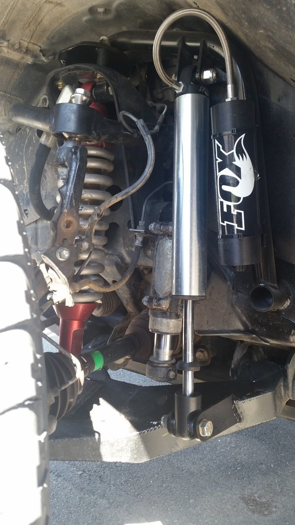

    What's the point of this?
    Not hating.. Genuinely curious. I've seen it on some really heavy duty and race trucks and never really understood it

    pretty much the coil over takes the weight of the shock and the other shock does all the work.

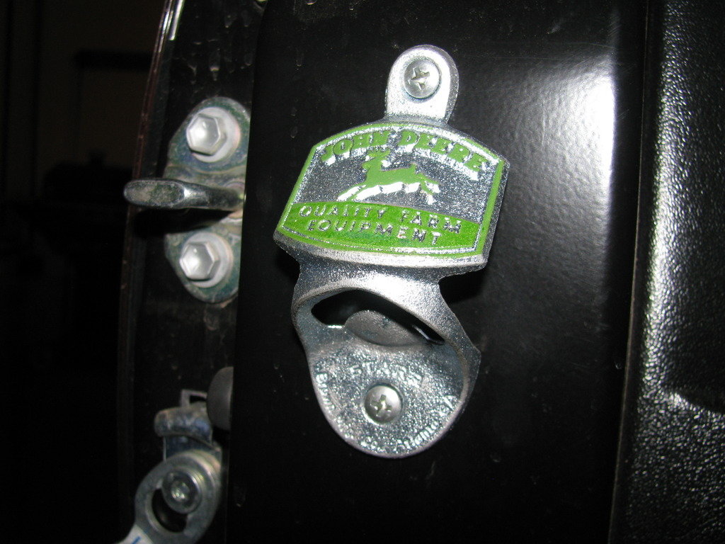

    Ya I need to get a life. I put a beer opener in back.
    Maybe I just broke a law by putting a John Deere beer opener on a Toyota.

    Better damping capabilities so you can run harder offroad, if valved correctly the ride gets A lot smoother even on the road (which in my case it dramatically improved the overall on road feel and handling).
    It also alleviates a lot of the stress the coil bucket and frame sees upon hard compression of the coilover or shock when it is compressing hard, this is especially important if you are planning on staying MT because you don't want to bend your frame or damage your radiator core support (because it ultimately ties to the front of the frame).
    Furthermore it allows additional cooling for the shocks while running for extended periods of time out there before fade can begin to occur.
    The only reason I performed this mod was because I had these originally as broken 10" shocks for the rear and I had totally brand new ones shipped to me by Fox for free. This was a cheap enough mod so I figured why not improve my overall capabilites by upgrading the front yet again to these spares I had lying around.

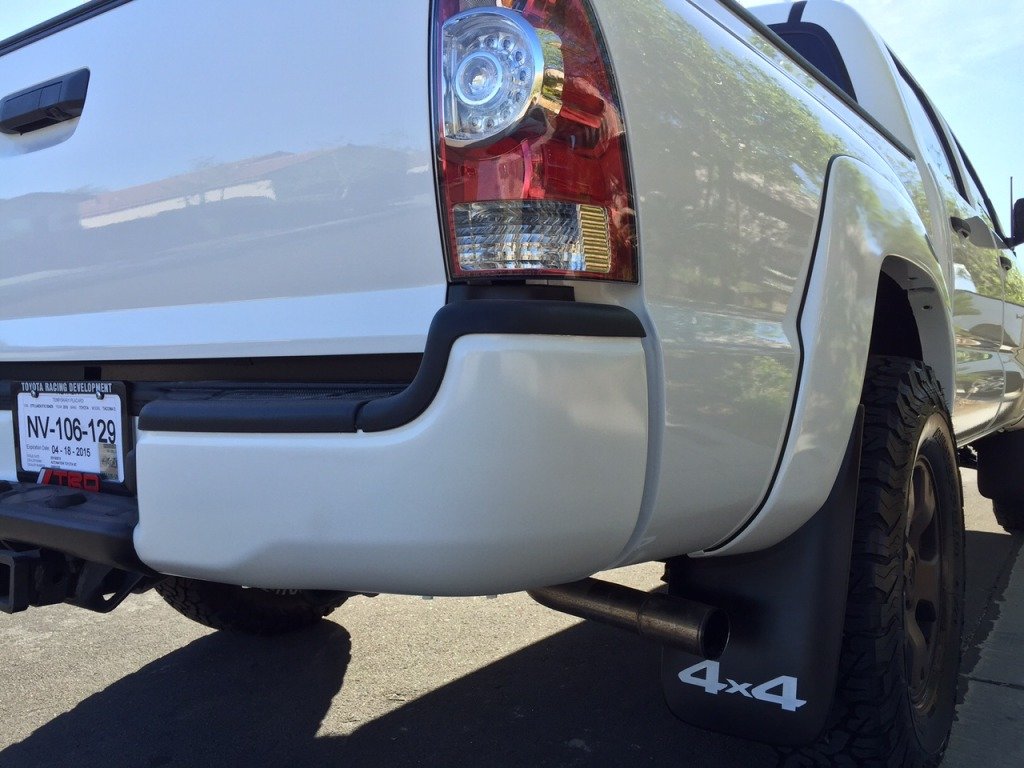

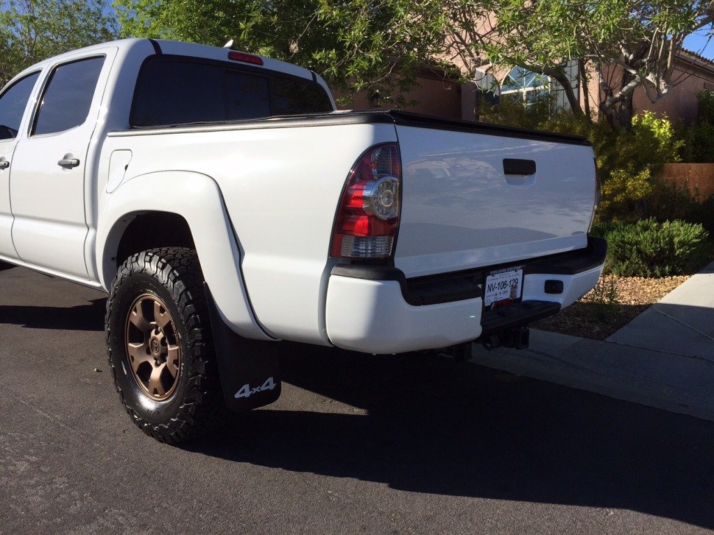

    Did you use any close after plasti dip? I would like to do this to rear bumper too.
    Does it look dull or glossy?
    can you post close ups on your rear bumper too?
    also, how many cans and coats did you use?

    i used the plasti dip glossifier after. 2 cans of white was about 5 coats then 2 coats of glossifier. Its shinier than plastidip by itself but its not glossy like paint. kinda in the middle. this is the best I have for close ups right now

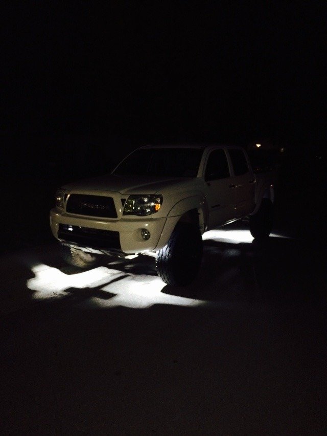

    Rock/Courtesy/Camping lights.

    What brand? This is popular right now.

    Just cheap Amazon led pods. I'll switch them out, as they are a bit big, but I put quick disconnects on the wires so swapping them out shouldn't be tough later on. These are just to give me an idea on output and angles.
