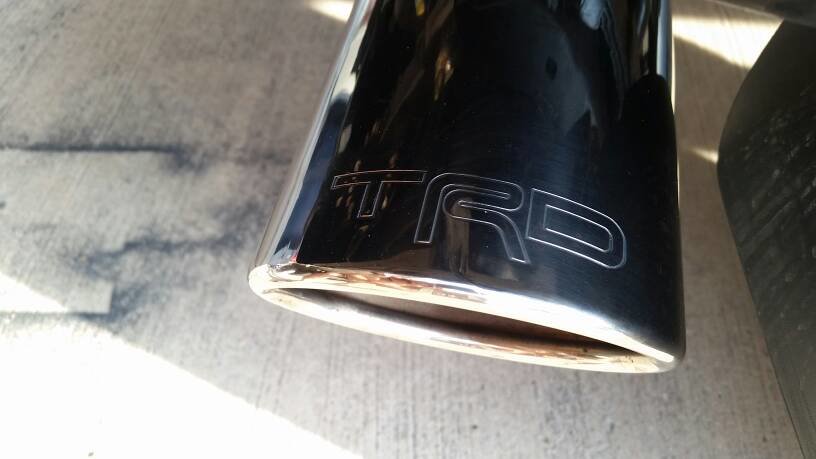

    TRD exhaust added today. 6470711ba367ea74e38bac7521d3c333_466d3cdc4358201a7743b946167a7aca51cc61b7.jpg

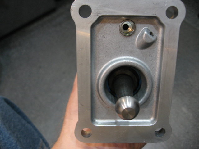

    I think they may have changed it for the 2015's? see pics - there is a breather mounted in the top of the stock shifter assembly, and the gasket has a "tunnel" to ensure the breather bottom side is open to the trans. Looked to me like that is now where they installed the transmission breather, possibly to get it a bit higher up. I didn't like the idea of taking the stock breather off without putting in something in its place, hence the mod to the Hurst lid.IMG_0506.jpg IMG_0514.jpg

    Wow! That's a good reason to mod the hurst. :rofl:
    My 2011 has the breather in a different location, definitely not on the shifter.

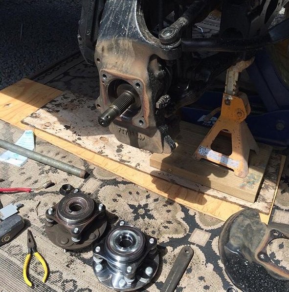

    Swapped out the old blown out wheel bearings for some freshies. Now myimage.jpg truck rolls smooth again.

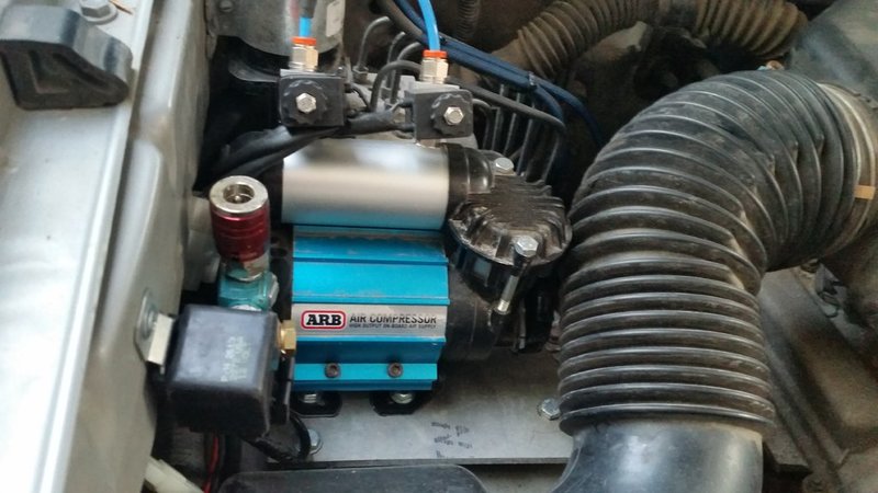

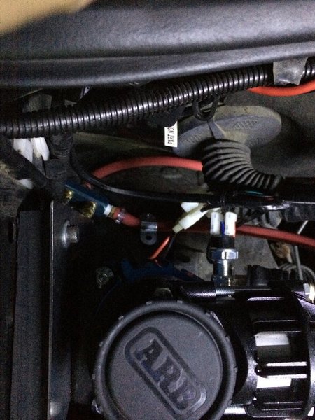

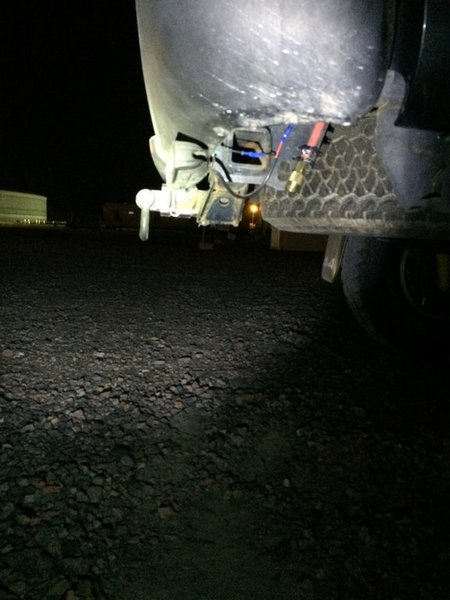

    Just wrapped this up last night - ARB CKMA12 OBA system!
    I ran hose for 2 quick connects - one in the front and one in the rear. You can access all 4 tires with the fill up hose that I have from either the front OR the rear, but this way you should have access to at least 1 of the positions at the time you need air!
    Mounting Location:
    Tough to see, but in the top right of the picture you can see the air splitter and set up I have:

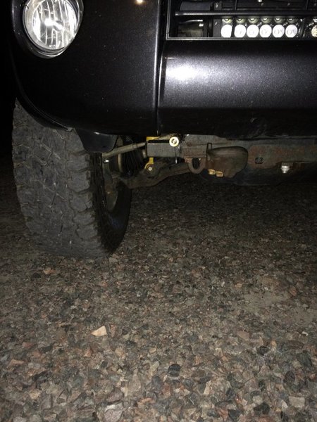

    Front Quick Connect (Follow the front valence line down and you can see it):
    Rear Quick Connect (red hose w/ brass fitting):
    Just waiting on some dust caps now to keep the debris out and should be in good shape!

    How well do they do for airing up tires? I've been thinking about getting OBA with a tank to have OBA and my air horns run on the same compressor/tank.

    Work pretty quick. I havent gone from flat to aired, but from about 24psi to 36psi took about a minute or two

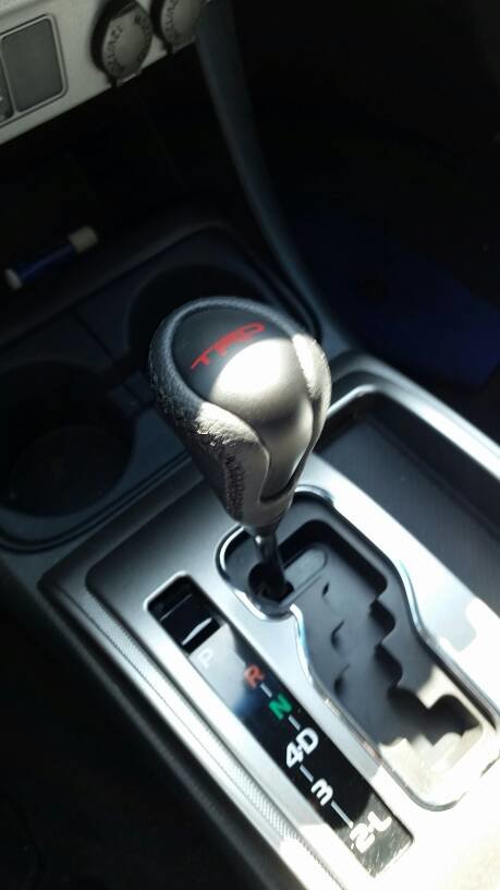

    TRD shift knob added. 7624a6cfdf2d7d3f748b1bc1863134ce_a627922e719fea22212e6ddefdb9687ddb0d6c9c.jpg
