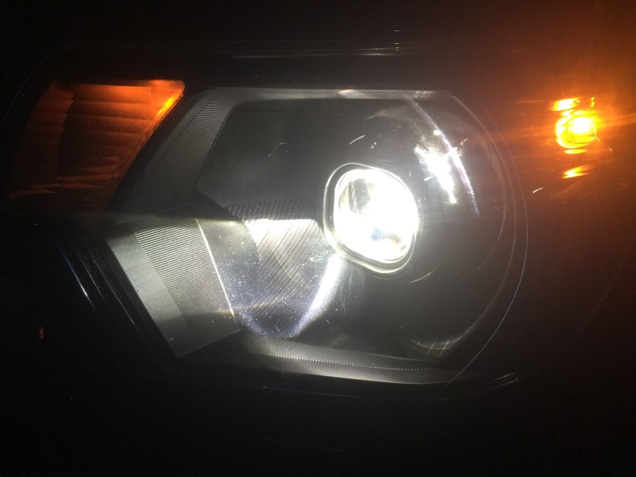

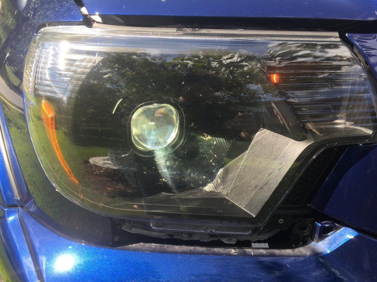

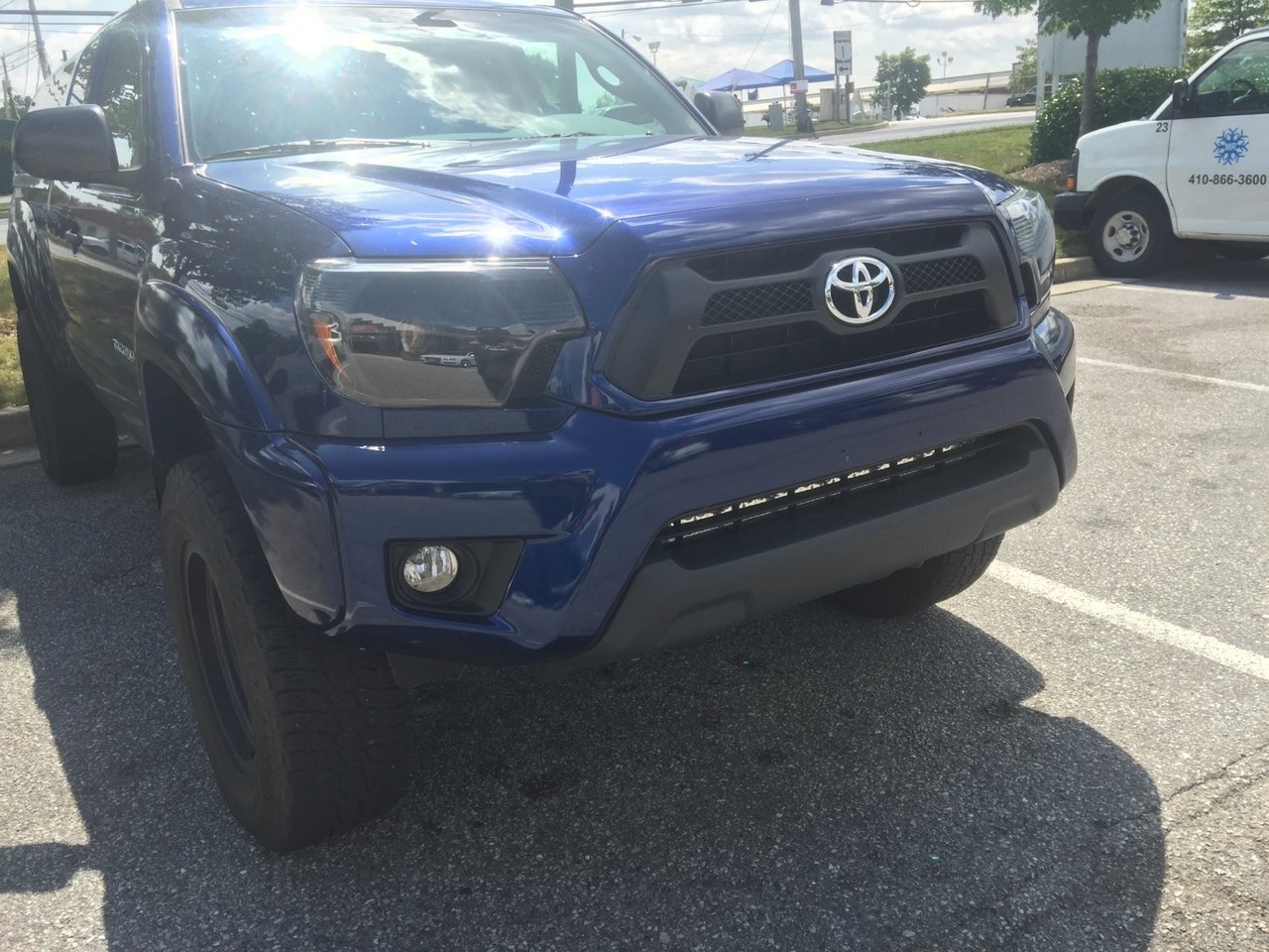

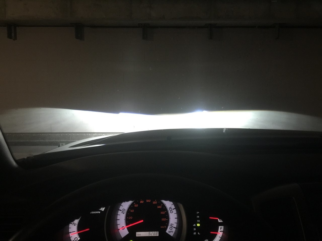

    Just sliiiiiightly. I ended up doing more adjustments. The drivers side projector was crooked so I had to open the headlight again and fix it.
    This is from before. I took the picture too close but you can see the left side and how tilted it was.
    It just looks so beautiful though

    Thanks! I was torn between the two but I thought the square went with the lines better.

    was it difficult to get the projectors in there?

    Incredibly easy. I did the mini d2s kit. Break em apart like the bhlm, sand a little of the back of the reflector down, and tighten down a lock nut.
