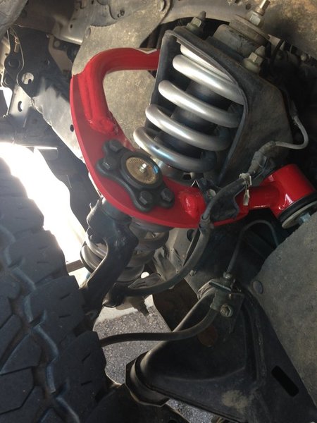

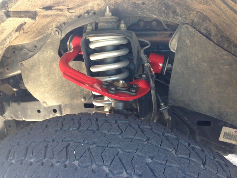

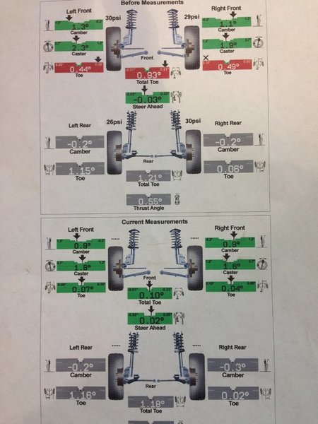

    image.jpg image.jpg image.jpg JBA ucas installed, lca bushing need to replaced but finally have everything in spec.

    Hmmm I feel like you can bring the camber down and caster up with aftermarket UCAs. I have LR UCAs and I have 0.1* camber and 3.1* caster.

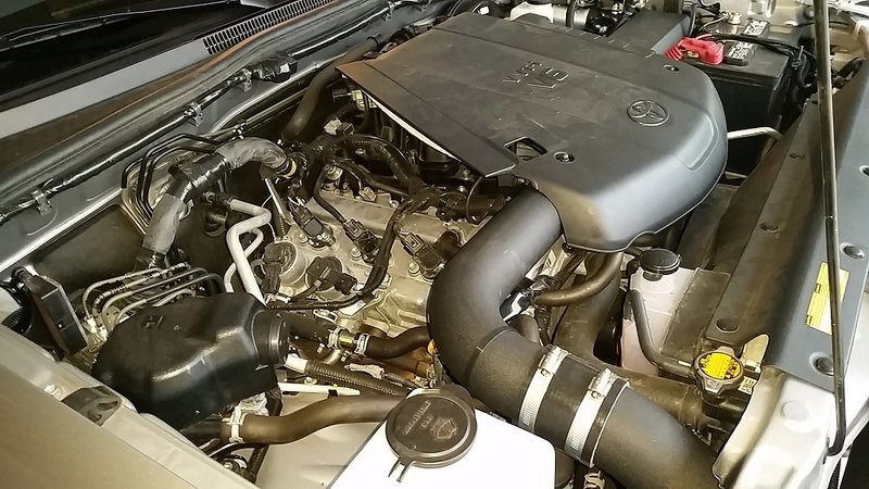

    Installed URD true cold air intake today. Shaved about a quarter second of my last 0-60 run.
    Next up URD Spec-U LT headers. They're in the garage but probably wait on the install of those. I'm thinking the headers won't be a quick install.

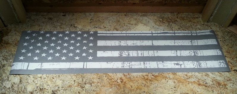

    where did you get this!?

    My dad made it. Bought the material and printed it.

    I know it wasn't cheap, think he had $100 into it. He said he can do different colors on white perforated material, this one is just black, then there is clear over the top.
