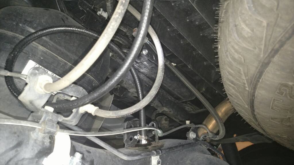

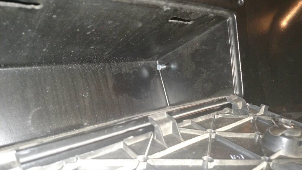

    Mounted the new breather tip in the cubby box behind the wheel well.
    Used fuel line because it is beefy as heck and should stand the test of time in the winter months.
    Used six feet total and had a bunch of slack for rear end flex. Didn't want the slack hanging down too far so I routed it through a brake line bracket. I think there is enough for the rear diff to drop over a foot.
    Way easy mod!

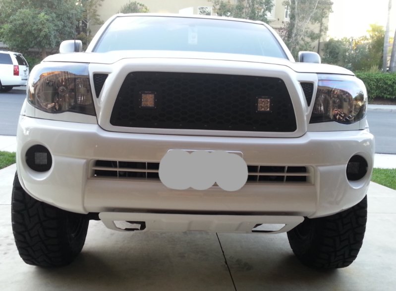

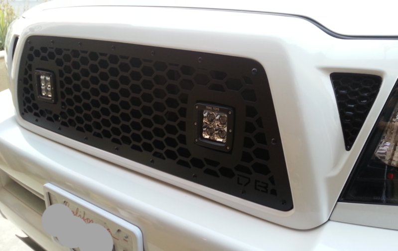

    Friday evening mod #2 installed my Trail Toys spot lights in my new grille!

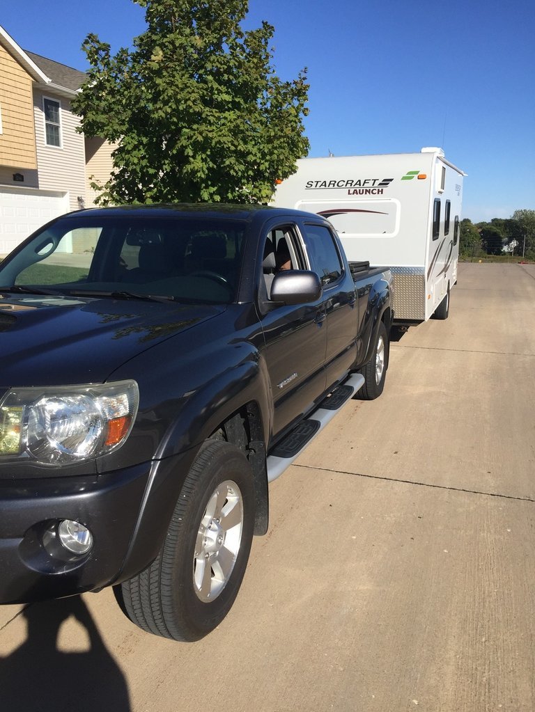

    Tried out the towing package

    I bought the same ones! Just one though, was a bit skeptical because they are so cheap, but they are just like he other pair I bought for 3x the price. Gonna use it as a bed light. May just buy more, can't beat $10!

    What size hose did you use? Do you have the part #'s for the union and breather? You might want to consider putting something around the end of the hose coming into the cubby, so it doesn't get pulled through. Clean install!

    I think the hose was 3/8"? Will have to double check my receipts. The Breather Mod For Dummies sticky is where I got the idea. I think he used 1/4" hose. The house I bought is double lined and very thick. The 1/4" was too narrow inside diameter for the nipple so I sized up.
    The hose is clamped behind the cubby. That way only the breather nozzle sticks through. Removing the cubby is simply a matter of removing six torx screws. Then I dropped a hole, stuck the breather nipple through, slid the hose on the other side and used a hose clamp to secure.
    Here are the Toyota parts I used:
