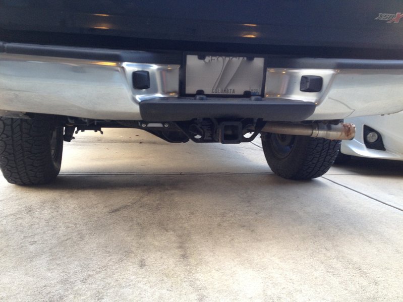

    Removed my shitty U-Haul low hanging ugly receiver hitch and replaced it with an OEM hitch. Much much better...

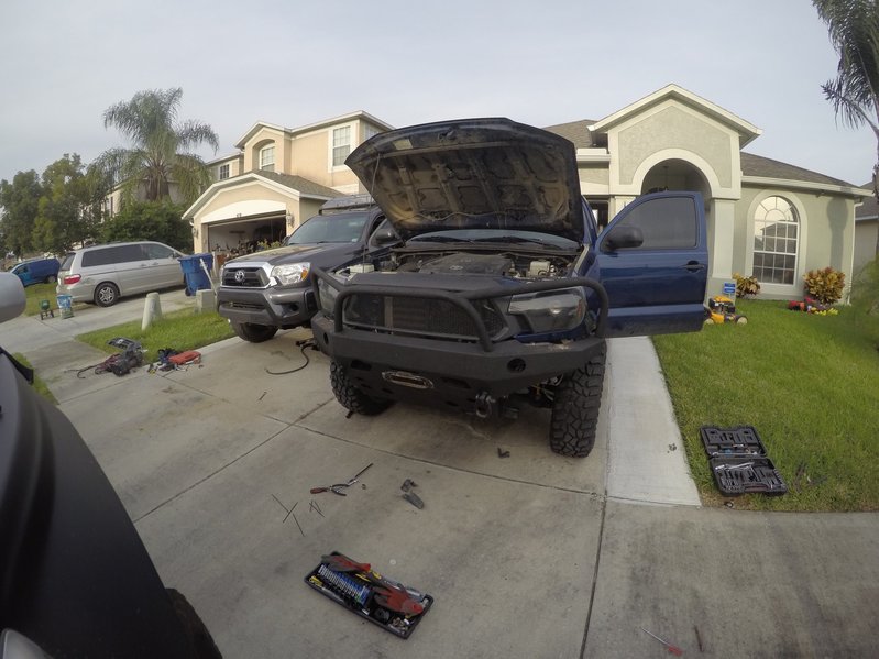

    LOL... your neighbor with the mini van is fertilizing and you are installing a bad ass bumper on a BA Tacoma. So much win in this pic!

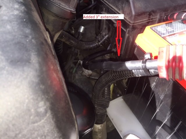

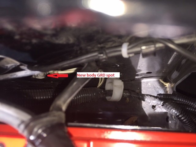

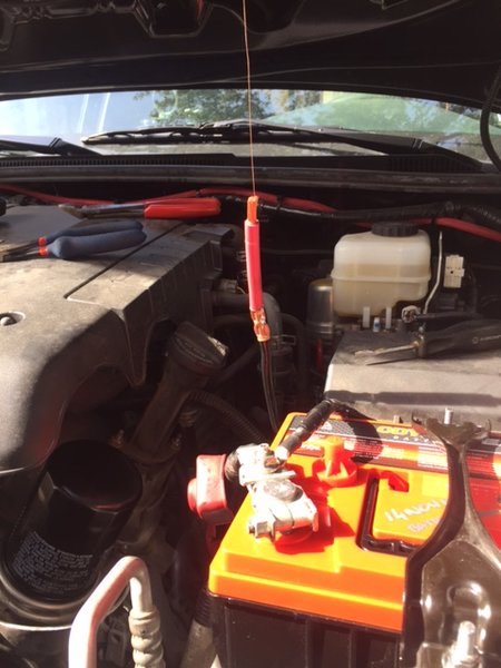

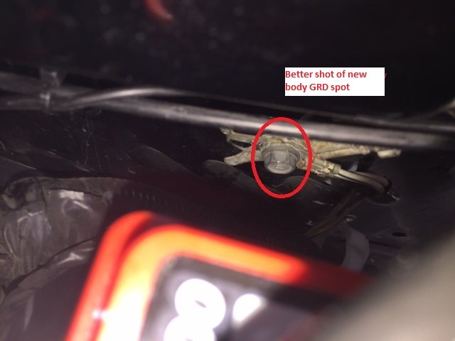

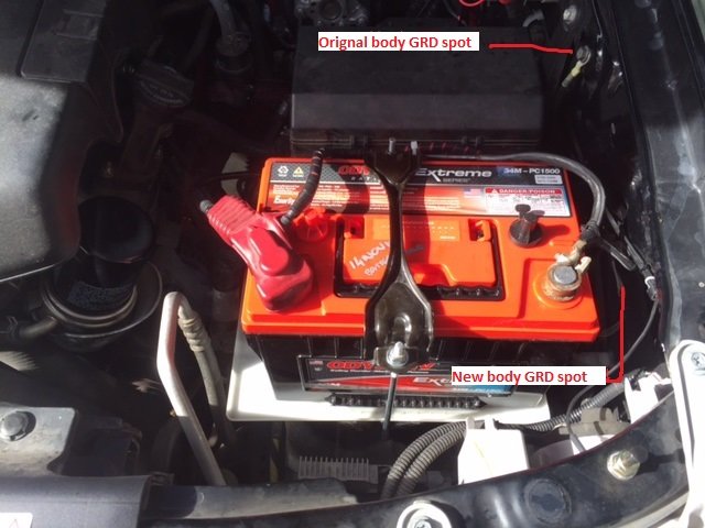

    Installed an Odyssey battery. OEM battery pretty much done at 60k just over 2 1/2 years old... big bulge in the side of it and was leaking...
    Not quite a drop in, as the posts are opposite. I had to add a 3" extension to the hot cable that goes into the fuse box. Swap out and mod new battery J hooks. Move the body GRD to a new spot. Straighten out the positive lead to OEM battery clamp to take a little more tension off the cable.
    I put this battery in, so that when I finally get a winch, it will connect directly to the extra terminal posts
    Battery comes with a 4 year replacement warranty regardless
    Here are some pics.
    I held it up because I didn't remove from the fuse box. Actually could find where the lead actually went after it entered the fuse box.
    Crimped and then soldered the butt connection

    I can't stand how tight all the stock power cables are to the battery. Really limits you to customizing stuff

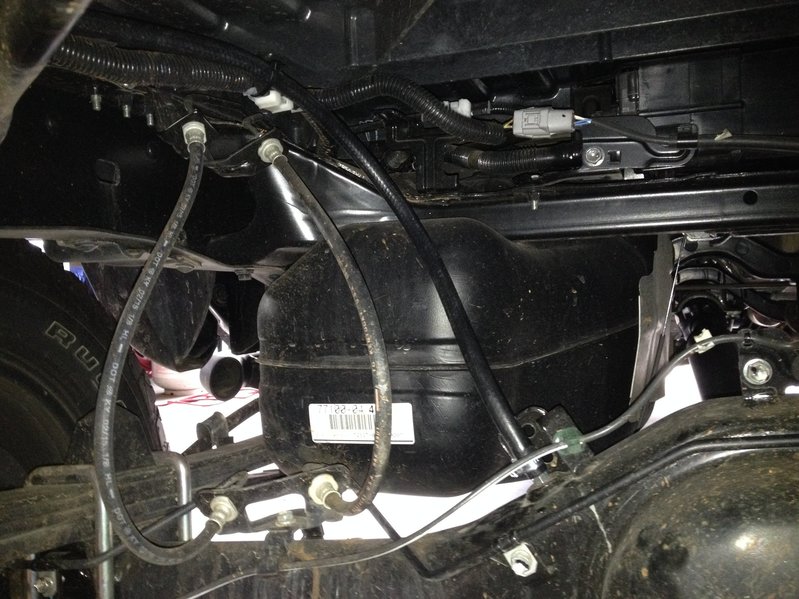

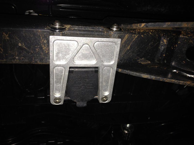

    Just got done driving down to Jacksonville and back this weekend, delivered a puppy from a breeder in my area to a buddy of mine. So, I backed into the garage and gave the interior a good cleaning and finally did my diff breather mod and Bullaculla trailer harness relocate.

    The cable I extended made it to the spare positive terminal post, however I want to use for the winch, which is why I went through the trouble of extending it..

    Modify the power cables.:rolleyes:

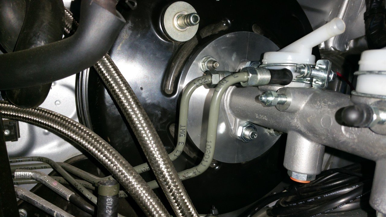

    Worked on my brake project...made an adapter plate out of aluminum to fit the Willwood MC to the Toyota Brake Booster, still need to measure and adjust the push rod and redo the brake line ends.
