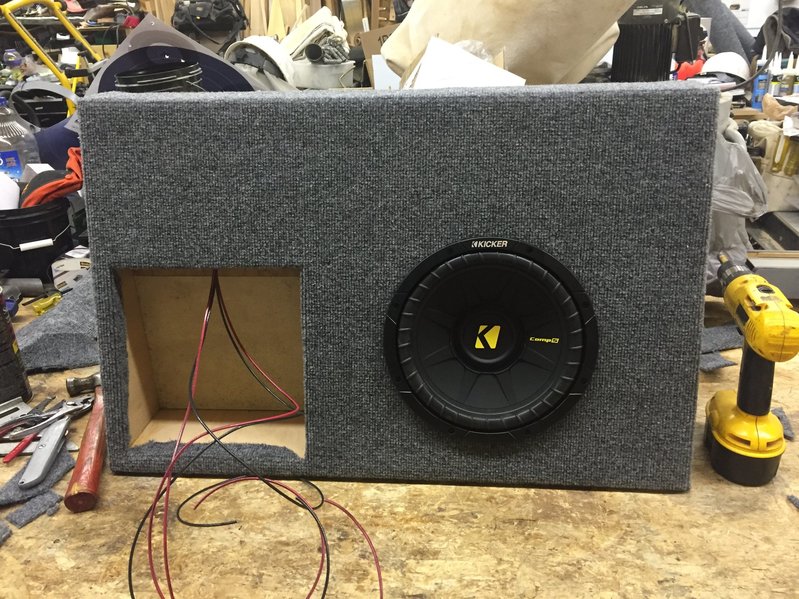

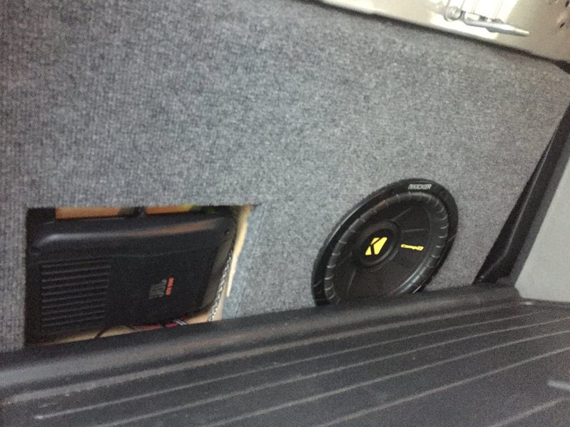

    7.25 at the bottom deep and 3.25 at the top. It's 18.5 tall and a 2 inch deep notch in the back starting 9.5 from the bottom and going to 13 from the top. (Mine is from 10 from the bottom to 12.5 from the bottom but fits very tight) and is 30 inches wide. Hope that helps.

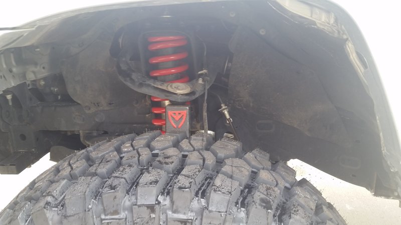

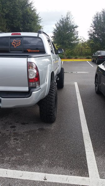

    Well I got the toytec springs installed and a 1.5" tapered block installed then put my new 35 KM2s and sr8's on(with 1.25"spacers). Took her for a alignment and they couldn't do it. Ordered the cam tab gussets from wheelers so I can take it back and go for round 2.
    41k and I've got messed up cam tabs. But at least she is looking fine

    Tim did you pair them up with the 5100''s?

    Yes and set at .85 I'm sitting at 26.5 in the front and 27 in the back center hub to fender
