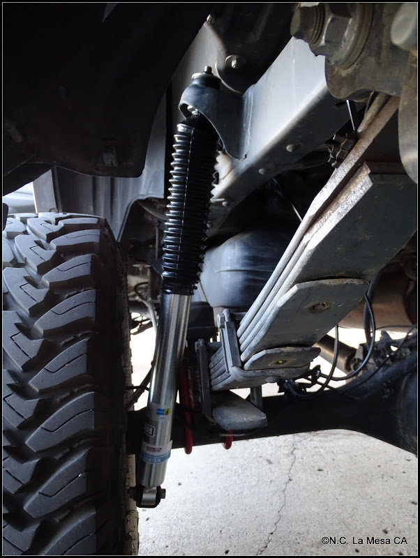

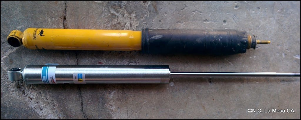

    Ditched my OME shocks for some Bilstein 5100 B110. Got three inches more wheel travel and better ride.
    Install both sides in my driveway in 30 minutes flat.
    Old vs. New.
    New Bilstein 5100 B110 installed.

    So the OMEs were the limiting factor in rear droop? Kinda sketchy...

    Yes.
    Not sketchy at all really. The OME shock is designed that way so the factory length brake lines don't rip out when the Dakar leafs flex out. Shocks have internal stops, so generally speaking they won't rip apart under normal circumstances.

    I see, hence the common "over speed bump goes clank"
    I have N182 OMEs , but with stock leafs - 3" extended brake lines too. No need for concern here, apparently.
