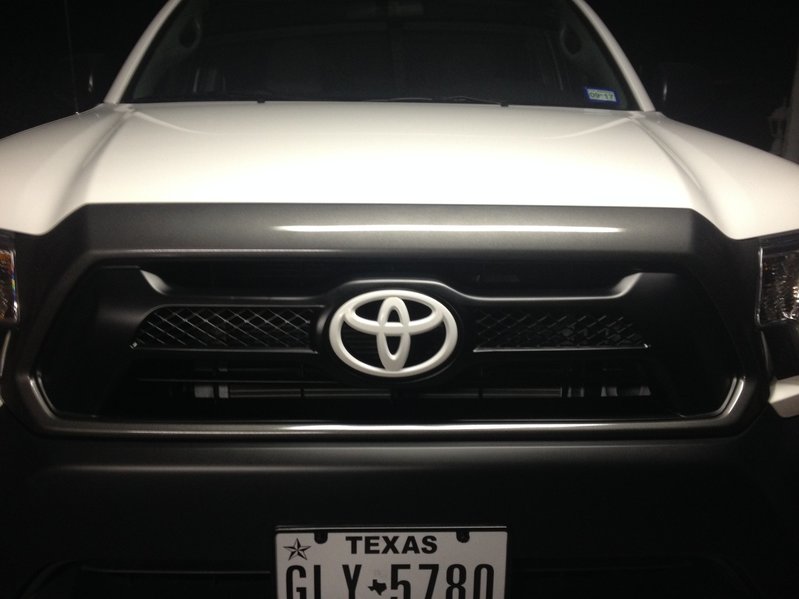

    Cant decide if i like the white badge or if i should go back to black. badge.jpg

    I prefer black and match the other badges.

    White truck white badge. IMO it works.

    I think the white looks pretty sharp on your white truck

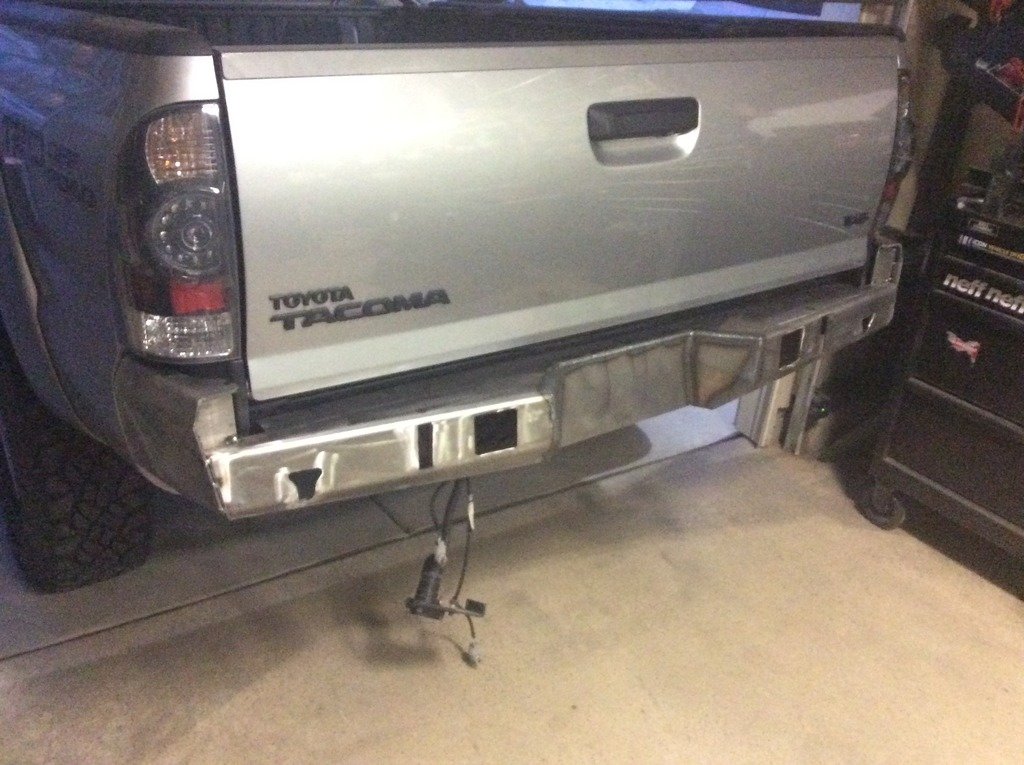

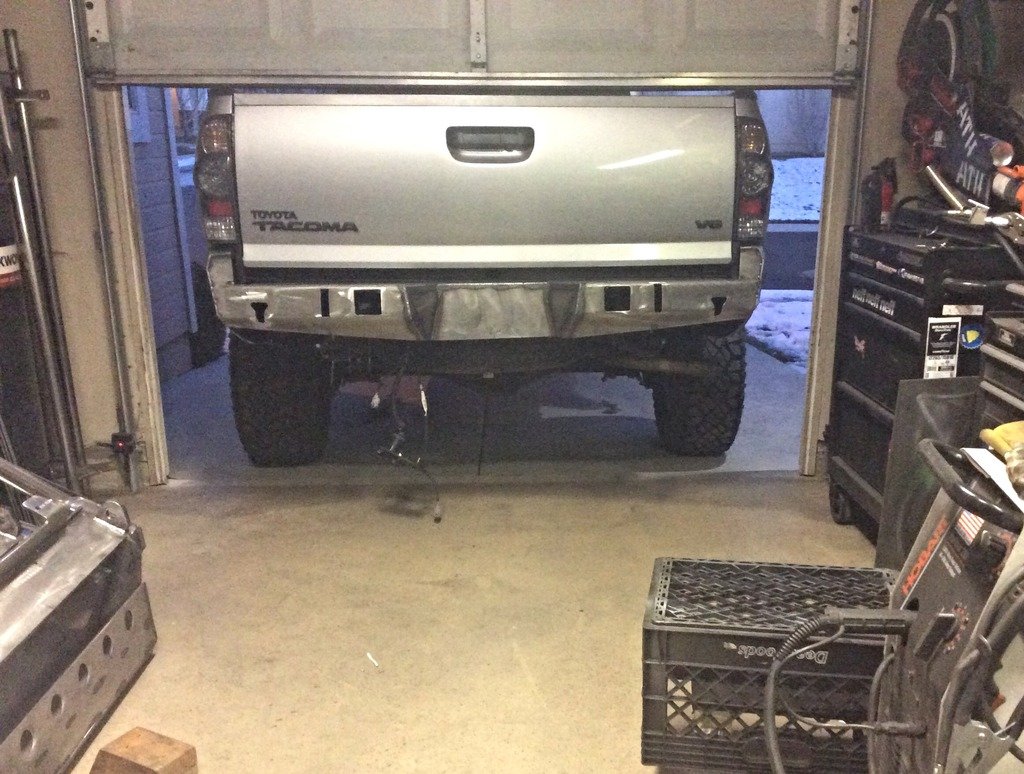

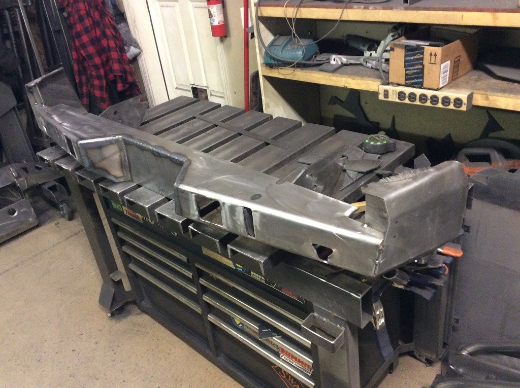

    Been working on a rear bumper over the last couple days.. Satisfied so far :D

    I like the bumper.
    How about some details on the build?
    Is it from a cardboard pattern or from a cad drawing plasma'd on a table? I see a nice radius break on the length but the short pieces are different looking bends. I dig individuals' builds and would like to hear more on the build from thought to reality.
    Sorry, I've worked sheetmetal for 27yrs, just got home from work, sat down, and saw your bumper. Looks really nice.
    Let's hear some details......

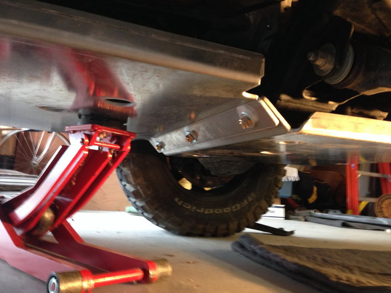

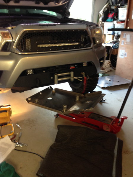

    Installed my Relentless Fab IFS skid, and oil pan mid skid today. Up next, Transfer case skid. Sorry about the lousy iPhone pics.

    I was able to get most of the center section done with just a tape measure, but for the side plates I had to use foam board for mock up. This was all hand cut with my plasma cutter, but I'm getting everything in 2d cad to keep the option of building more.
    All the bends were done on my pressbrake, and you have a good eye. The side plate bends have a slightly tighter radius.

    Stay white badge. :)

    You have a nice press brake I see. Is this at work or in the home garage? I have to admit I've done projects on brakes with petty crappy dies that leaves dimples and such.
    Now that I'm in a Tacoma maybe I'll have to find myself another shop with a GOOD brake for my own projects. Not the worst reason to guide a career, eh?
